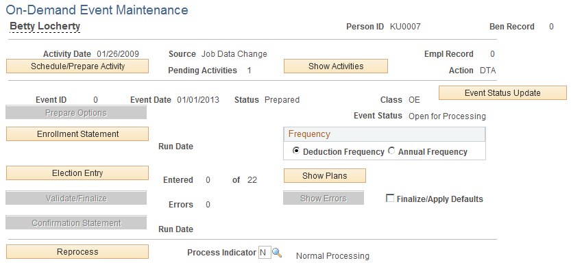

This example illustrates the fields and controls on the On-Demand Event Process page. You can find definitions for the fields and controls later on this page.
On-Demand Event Maintenance page
Field or Control Description
Empl Record (employee record number)
Used for employees with multiple jobs.
Employees with multiple jobs can have different sets of benefits elections. The system keeps track of the different sets of elections by assigning benefit record numbers for each benefits package.
Activity Date and Show Activities
This is the date on which the trigger activity for the Benefits Administration event occurred.
If the system finds only one activity for the employee, the system automatically displays the date. If more than one activity exists, click the Show Activities button to select an activity to process.
Source
Displays the type of action that triggered the activity record: a change to the employee address, multiple job flags, or job data; manually adding an event through the Review Bas Activity page; or a passive event.
Schedule/Prepare Activity
Click to run the Schedule/Prepare Activity process.
Pending Activities
Displays the number of activities waiting to be processed into participant events for this employee ID and benefit record number combination.
As activity triggers are processed into participant events, they are deleted from the Review Bas Activity page. If no activities are waiting to be processed, the Pending Activity field is blank and the Show Activities button is not available.
Action
Displays the type of job action associated with the action trigger.
For example, if the triggering action is a hire of an employee, the action is HIR. When the system processes the activity into a participant event, it uses the action to determine which event classification governs the event.
The remaining features, discussed in the following sections, are unavailable until the activity is scheduled.
