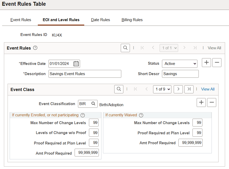

Event Rules Table – EOI and Level Rules Page
BAS_EVENT_RULES1A
Set EOI and level rules for event classes.

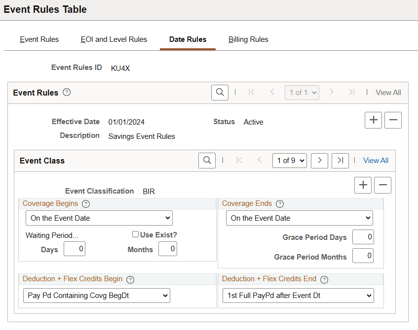

Event Rules Table – Date Rules Page
BAS_EVENT_RULES2
Define date rules.

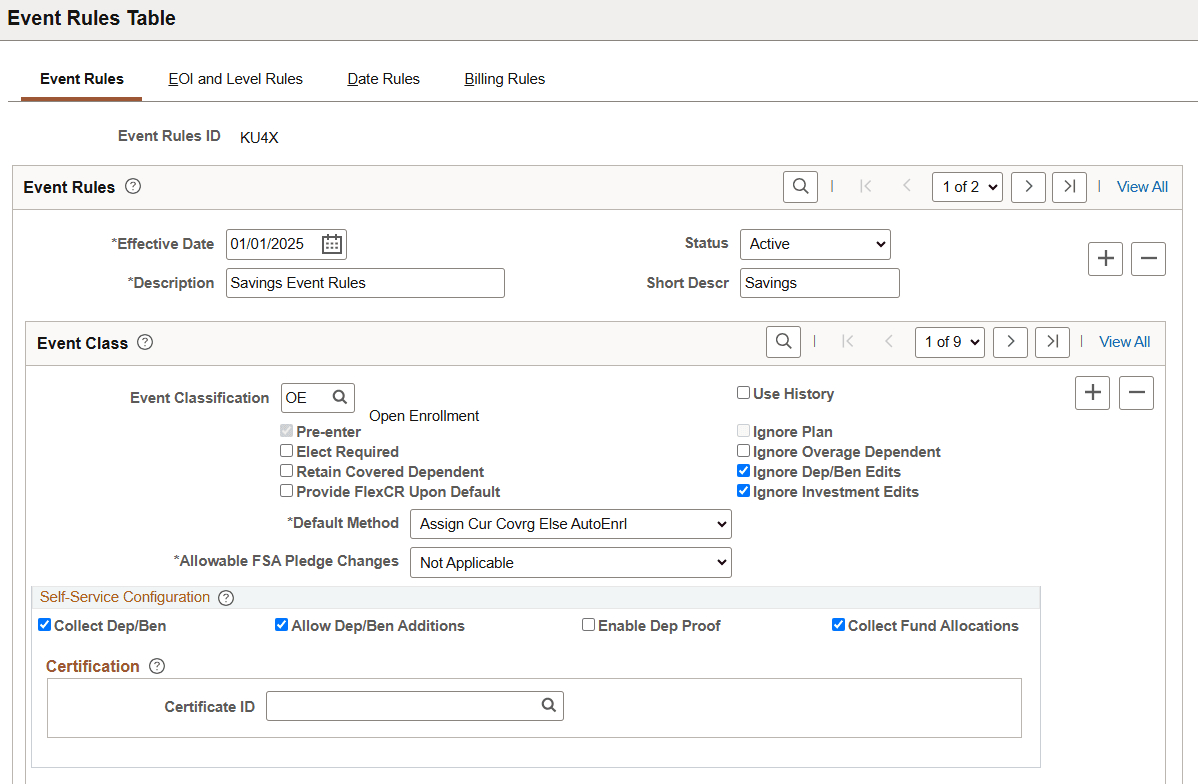

Event Rules Table – Event Rules Page
Use the Event Rules Table - Event Rules page (BAS_EVENT_RULES1) to define basic event rules for event classes.
Navigation:
Set Up HCM, and then Product Related, and then Automated Benefits, and then Eligibility and Event Rules, and then Event Rules Table, and then Event Rules
This example illustrates the fields and controls on the Event Rules Table- Event Rules page (Page 1 of 2).
Event Rules Table (Page 1 of 2)
This example illustrates the fields and controls on the Event Rules Table- Event Rules page (Page 2 of 2).
Event Rules Table (Page 2 of 2)
Event Class
Use this group box to define rule information for an event class.
Field or Control Description
Event Classification
Select an event classification.
You can have more than one event classification for an event rule to cover all expected contingencies and usages.
Note: If the Event Classification field is left blank, that row becomes a wildcard and is used to manage any event processed by this rule for which no specific event classification behavior has been defined. This wildcard is difficult to troubleshoot because the system provides no indication as to when it was invoked, and thus can lead to unanticipated results. Use the wildcard feature cautiously.
Use History
Reviews the eligibility history of the participant's benefit plan option and the eligibility of the participant's current benefit plan option to determine whether the employee can change an election. If the lists of eligible options are the same, the participant is not allowed to make plan option changes. This setting is used to filter out events that do not result in an opportunity for an employee to change elections.
If, after processing, the participant is eligible for new options, Benefits Administration prepares the event for further processing and enables new enrollment elections. If the participant has lost eligibility for one or more current elections, he or she can make a new election.
Pre-enter
Select to populate the Benefits Administration data entry pages with the participant's current elections for the plan type associated with the event rule. Doing so enables you to view current elections during data entry and change them as necessary.
Current elections include the option code of the enrolled benefit plan and the coverage code, as well as dependent, beneficiary, and 401(k) investment elections. The system only pre-enters current elections if the participant's current option is in the participant's current eligible list of options.
Note: You should avoid selecting Pre-enter for plan types 6x (FSA), and 9x (Vacation Buy/Sell) during open enrollment, because these plans types may legally require positive annual re-enrollment.
Ignore Plan
Select to make changes to plan information without restrictions as to how often or when the changes are made. When this option is selected, the plan types linked to this event rules ID and event classification combination are unaffected by Benefits Administration processing. You can use this option to arrange for specific plan types to have automatic event processing only for major event classifications such as hires, terminations, and open enrollment, while leaving them unaffected by lesser event classifications.
When you select Ignore Plan, the system selects and locks Ignore Dep/Ben Edits and Ignore Investment Edits. The system also sets Select Allowed to None, and all participate and waive level values to 99.
Ignore Plan does not interfere with eligibility rule processing. It does not enable employees to stay in or enroll in plans for which they are no longer eligible.
If participant plan eligibility does not change, the system gives employees their current coverage. But if participant plan eligibility does change—that is, if employees lose eligibility for their current plan—you need to set a default method of Assign Cur Covg Else Option, Assign Cur Covg Else Low Opt, or Assign Cur Covg Else None.
With Ignore Plan selected, the system ignores:
  • Change level maximums and proof required for changing levels.
  • Plan-specific edits (life insurance settings, individual FSA (Flex Spending Account) maximums, vacation limits, and so on).
  • Edits on dependent or beneficiary information.
  • Edits on investment elections.
The system continues to:
  • Flag errors generated due to invalid setup, such as missing table entries or pay calendars.
  • Require that the option code entered through data entry be a valid selection from the eligible plans on the program.
  • Consider the coverage amount for all life and AD/D plans when evaluating coverage group maximums.
  • Include the annual pledge on all FSA plans when evaluating total FSA maximums.
Select Ignore Plan when your automatic benefits processing responsibility has to share (or completely abdicate) responsibility for the processing of certain plan types with an outside or manual process. Don't use it only to suppress the entry of elections. A Select Allowed value of None, an appropriate default method setting, and the Use History rule are generally sufficient to control employee involvement in benefit elections.
Elect Required (election required)
Select to note the absence of elections for this plan type as an error in the Benefits Administration Messages table.
Ignore Overage Dependent
Select to control when and how dependents are actually dropped from coverage. You can create a midyear event that allows overage dependents to remain covered until the open enrollment event, when they are dropped from the coverage.
Retain Covered Dependent
Select to enable employers to move employees from one plan to another, while maintaining the current coverage code and dependent elections (default plan). In case of no matching coverage, the system assigns the default coverage and the existing dependent is not retained.
If the employee has lost eligibility for a current election and the default election is supplied, the system determines the plan for the default option and attempts to move that employee into an option with the default plan and the employee's current coverage code.
Ignore Dep/Ben Edits (ignore dependent or beneficiary edits)
Select to skip all checks for the presence of dependents or beneficiaries and bypass all edits on dependents or beneficiaries already present or entered with elections.
Provide FlexCR Upon Default (provide flex credit upon default)
Select if you want participants that appear by default in a plan type to continue to receive credits that are tied to the default plan type.
When this check box is deselected for plan types 1x through 3x (plan types 1x through 2x for federal users), participants who accept election defaults do not receive any credits (general plan type credits or option-based credits) for those plan types.
For employees who elect to have excess credits applied to an FSA plan type and who are not enrolled in an FSA plan type, and for whom the Default Method field is set to Default Option for Excess Credit, the system creates an enrollment for the employee with a contribution amount equal to the excess credits.
Select to skip all checks for the presence of investments on savings plans and bypass all edits on investment elections already present or entered with elections.
Default Method
Indicates what happens when an employee does not select an election for a particular plan type. Values are:
  • Assign Cur Covrg Else AutoEnrl (assign current coverage else auto enrollment): Select to assign and continue the participant's current coverage. If participants do not have current coverage, or have lost eligibility to current coverage, and are eligible for the auto enrollment, they are assigned to the savings plan for which auto enrollment is enabled in the Savings Plan Table. The participant must be eligible for the current election for it to be used as the default.
    Note:This is only for savings plans. For auto enrollment, the administrator must select the Assign Cur Covrg Else AutoEnrl option, enable Ignore Dep/Ben Edits, and Ignore Investment Edits. The Pre-enter and Ignore Plan options are automatically greyed out on selecting the Assign Cur Covrg Else AutoEnrl Default Method.
  • Assign Cur Covrg Else Option (assign current coverage else option): Select to assign and continue the participant's current coverage.
    If participants do not have current coverage, or have lost eligibility to current coverage, they are assigned to the default for the specific plan type, as defined in the Benefit/Deduction Program table. The participant must be eligible for the current election for it to be used as the default.
  • Assign Cur Covrg Else None (assign current coverage else none): If the employee loses eligibility for the current plan, another plan is not set up to replace the old one.
  • Assign Cur Covrg Else Low Opt (assign current coverage else low option): Select to assign and continue the participant's current coverage.
    If the participant has no current coverage, or if the participant has lost eligibility to current coverage, the system assigns the lowest-level option available, as defined in the Benefit/Deduction Program table. This option is not recommended for Savings, FSA, and Vacation Buy/Sell plan types.
  • Default to Lowest Elig Option (default to lowest eligible option): Select to assign the lowest-level option for which the employee is eligible.
  • Default to Option and Coverage: Select to assign the option marked for default on the Benefit Program Definition page.
    The participant must be eligible for the option for it to be used as the default. This option is not recommended for Savings, FSA, and Vacation Buy/Sell plan types.
  • Default Option for Exc Credit: (default option for excess credit) Applicable only to FSA plan types.
    If the employee has indicated that excess credits should be directed to an FSA enrollment, this rule assigns the option marked for default on the Benefit Program Definition page and sets the annual pledge to the amount of the excess credits. The participant must be eligible for the option for it to be used as the default, and excess credits must exist.
    Note: During enrollment, the system does not create a zero-monetary annual pledge enrollment when excess credits do not exist, and any current FSA enrollment is terminated if not reelected by the employee.
  • Terminate Coverage: Inserts a termination entry for the plan type covered by this event rule.
    This option is commonly used for FSA and Vacation Buy/Sell plan types, because employees are usually required to reenroll in them each year or lose coverage.
Allowable FSA Pledge Changes (allowable flexible spending account pledge changes)
Select either Increase or decrease to indicate whether employees can increase or decrease their FSA pledges based upon the event classification that is being processed. For example, if the event classification is Birth, employees can increase, but not decrease their FSA pledge. This field applies only to 6x plan types and should be set to N/A for all other plan types.
See Option Election Page.
Use the EOI and Level Rules (Evidence of Insurability and Level Rules) page (BAS_EVENT_RULES1A) to set EOI and level rules for event classes.
Navigation:
Set Up HCM, and then Product Related, and then Automated Benefits, and then Eligibility and Event Rules, and then Event Rules Table, and then EOI and Level Rules
This example illustrates the fields and controls on the EOI and Level Rules page.
EOI and Level Rules page of Events Rules Table
Use the Event Classification field to select the event class for which you want to define rules.
If currently Enrolled, or not participating
Use this group box to define rules that apply to an employee's participation in a benefit option following an event when the employee is currently participating in a plan or is new to a plan. These rules commonly apply to life, accidental death and dismemberment, and disability plan types, and are used to indicate the types of changes that employees can make.
Max Number of Change Levels (maximum number of change levels)
Indicates how many levels a participant can change or jump.
Levels of Change w/o Proof (levels of change without proof)
Indicates how many levels a participant can change without proof of good health or insurability.
Proof Required at Plan Level
Indicates the initial level at which proof of good health or insurability is required.
Amt. Proof Required (amount at which proof is required)
Enter the amount of coverage above which proof of good health or insurability is required.
If currently Waived
Use this group box to define rules that apply to an employee's participation in a benefit option following an event if the employee is currently opted out of the program.
Indicates how many levels a participant can change.
Use the Event Rules Table - Date Rules page (BAS_EVENT_RULES2) to define date rules.
Navigation:
Set Up HCM, and then Product Related, and then Automated Benefits, and then Eligibility and Event Rules, and then Event Rules Table, and then Date Rules
This example illustrates the fields and controls on the Event Rules Table - Date Rules page.
Date Rules page of Event Rules Table
Use this page to set up date information for benefits.
Coverage Begins
Indicate when coverage begins following an event.
Values are:
  • Month-Begin After Event Dt (month begin after event date): Coverage begins on the first day of the following month.
    If the event date is equal to the first of the month, coverage still begins on the first day of the following month.
  • Month-Begin On/Aft Event Dt (month begin on or after event date): If the event date equals the first of the month, coverage begins on the event date; otherwise, coverage begins on the first day of the following month.
  • On Pay Pd Begin after Event Dt (on pay period begin after event date): Coverage begins on the first day of the pay period following the event date.
    If the event date equals the first day of the pay period, coverage begins on the event date.
  • On the Event Date: Coverage begins on the day of the event.
Waiting Period...
To calculate the date that coverage begins when a waiting period exists, the system:
  1. Begins with the event date.
  2. Adds the number of months.
  3. Adds the number of days.
  4. Applies the Coverage Begins rule to the resulting date.
Use Exist?
Select to enable the system to search for any waiting periods on prior events. If this option is selected, and a waiting period is found, the system honors the prior event's waiting period if the prior event's coverage begins date is later than the coverage begins date normally associated with the current event.
For example, new hires have a three-month period before their benefits become effective. Under this rule, an employee hired on November 1 has a health benefit election with a coverage begin date and deduction begin date of February 1.
Now, suppose that you've scheduled an open enrollment for January 1. During that time, the employee was processed for an open enrollment event. If the event rules for the open enrollment specify that the coverage begin date equals the event date, January 1, the employee would have a health benefit election posted with a coverage and deduction begin date that is earlier than the health benefit coverage and deduction begin date that the employee originally received when hired.
Selecting Use Exist? for the OE event rule would prevent this from happening because the system would preserve the waiting period from the employee's previous HIR event.
Days and Months
Enter the number of days and months for the system to use as a waiting period to begin coverage.
Coverage Ends
Select when coverage ends. The coverage end date is used only when an existing election within a plan type is truly terminating and not simply being superseded by another election (benefit option). In this case, the system inserts a new election row with Coverage Election set to Terminated.
If you select either On Month - End after Event Date or On Pay Pd End after Event Dt, the coverage begin date of this new row is one day after the calculated coverage end date for the current election. This occurs because this is the first date for which coverage no longer exists.
Grace Period Days and Grace Period Months
To establish a grace period before coverage is terminated, enter the appropriate number of days or months that the system uses to calculate the resulting end date in a manner similar to Waiting Period.
Deduction + Flex Credits Begin
Use this group box to indicate when deductions and flexible benefit credits should be taken. Values are:
  • 1st Full PayPd After Covg BgDt (first full pay period after coverage begin date): Credits and deductions begin on the first day of the pay period following the coverage begin date, regardless of when the coverage begin day occurs within the pay period.
  • On CovgBegin Date (on coverage begin date): Credits and deductions begin on the date that benefit coverage for the plan type begins.
  • Pay Pd Containing Covg BegDt (pay period containing coverage begin date): Credits and deductions begin on the first day of the pay period containing the coverage begin date, regardless of when the coverage begin date occurs within the pay period.
  • Pay Pd Preceding Covg BegDt (pay period preceding coverage begin date): Credits and deductions begin on the first day of the full pay period that precedes the coverage begin date.
Deduction + Flex Credits End
Use this group box to indicate when deductions and flexible benefit credits should end. Values are:
  • 1st Full PayPd after Event Dt (first full pay period after event date): Credits and deductions end on the first day of the pay period following the coverage end date, regardless of when the coverage begin day occurs within the pay period.
  • On CovgEnd Date (on coverage end date): Credits and deductions end on the date that benefit coverage for the plan type ends.
  • Pay Pd Containing Event Date (pay period containing event date): Credits and deductions end on the first day of the pay period containing the event date, regardless of when the coverage begin date occurs within the pay period.
  • Pay Pd Preceding Covg EndDt (pay period preceding coverage end date): Credits and deductions end on the first day of the full pay period that precedes the coverage end date.
