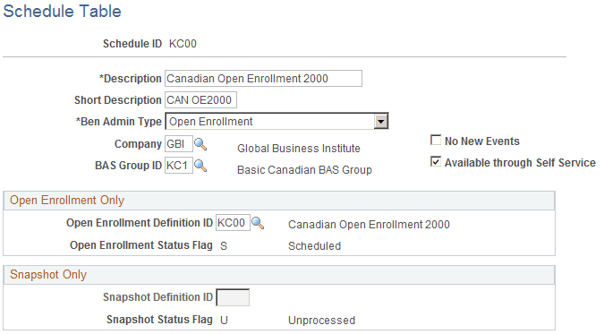

Schedule Table Page
Use the Schedule Table page (BAS_SCHEDULE) to control your processing schedule.
Navigation:
Set Up HCM, and then Product Related, and then Automated Benefits, and then Processing Controls, and then Schedule Table, and then Schedule Table
This example illustrates the fields and controls on the Schedule Table page. You can find definitions for the fields and controls later on this page.
Schedule Table page
Field or Control Description
Ben Admin Type (Benefits Administration type)
Select from the following values: Open Enrollment, Event Maintenance, or Snapshot.
Company
Enter the name of the company. If this field is left blank, all companies will qualify.
BAS Group ID (Benefits Administration schedule group identification)
Enter the BAS group ID. If this field is left blank, all benefits groups will qualify.
No New Events
Select if you don't want any new events assigned to the schedule. Existing events assigned to the schedule will continue to be processed.
For example, if you want event maintenance to begin assigning new events to a new schedule that has the same attributes as an existing schedule, you can create a new schedule and select this check box on the old schedule. New events are assigned to the new schedule and you can continue to run the old schedule until all events are finalized.
Available through Self Service
Select if you will enable employees to enter elections for this Benefits Administration process through the PeopleSoft eBenefits application.
If this check box is not selected, benefits administrators will have to update the employee elections resulting from this process through the Data Entry pages.
Open Enrollment Definition ID
Enter the open enrollment definition ID if this is to be an open enrollment processing schedule.
Open Enrollment Status Flag
Displays the current processing status of the Open Enrollment process represented by the open enrollment definition ID.
Snapshot Definition ID
Enter the snapshot definition ID if this is to be a Snapshot processing schedule.
Snapshot Status Flag
Displays the current processing status of the Snapshot process represented by the snapshot definition ID.
If you are using the PeopleSoft Benefits Administration for U.S. Federal Government application and this is for an open season period, the schedule ID should match the open enrollment definition ID for that open season period.
