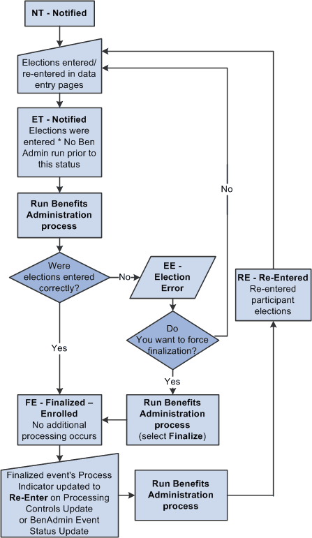

You can reprocess events at almost every stage of the Benefits Administration process, from scheduling to election entry. In many cases, event reprocessing does not involve process status values other than those described previously, but when you're planning to reenter participant benefit option elections, the system uses the special RE (reentered) process status as an interim status before rolling the event back to the ET value.
The following table describes the RE process status value:
Process Status Description Next Processing Steps
RE - Re-Entered
Enables elections associated with processing for the participant event to be reentered after the participant event has been brought to a process status of FE.
Events are updated to RE status through the Update Event Status page.
After you update the elections in the data entry pages, the system updates the process status from RE to ET.
The following flowchart illustrates the process status flow for ET events and follows it through to the final process status of FE. It also shows how the system uses the RE process status:
This image describes the process status flow for election entry, validation, loading, and reentry.
Process status flow for election entry, validation, loading, and reentry
