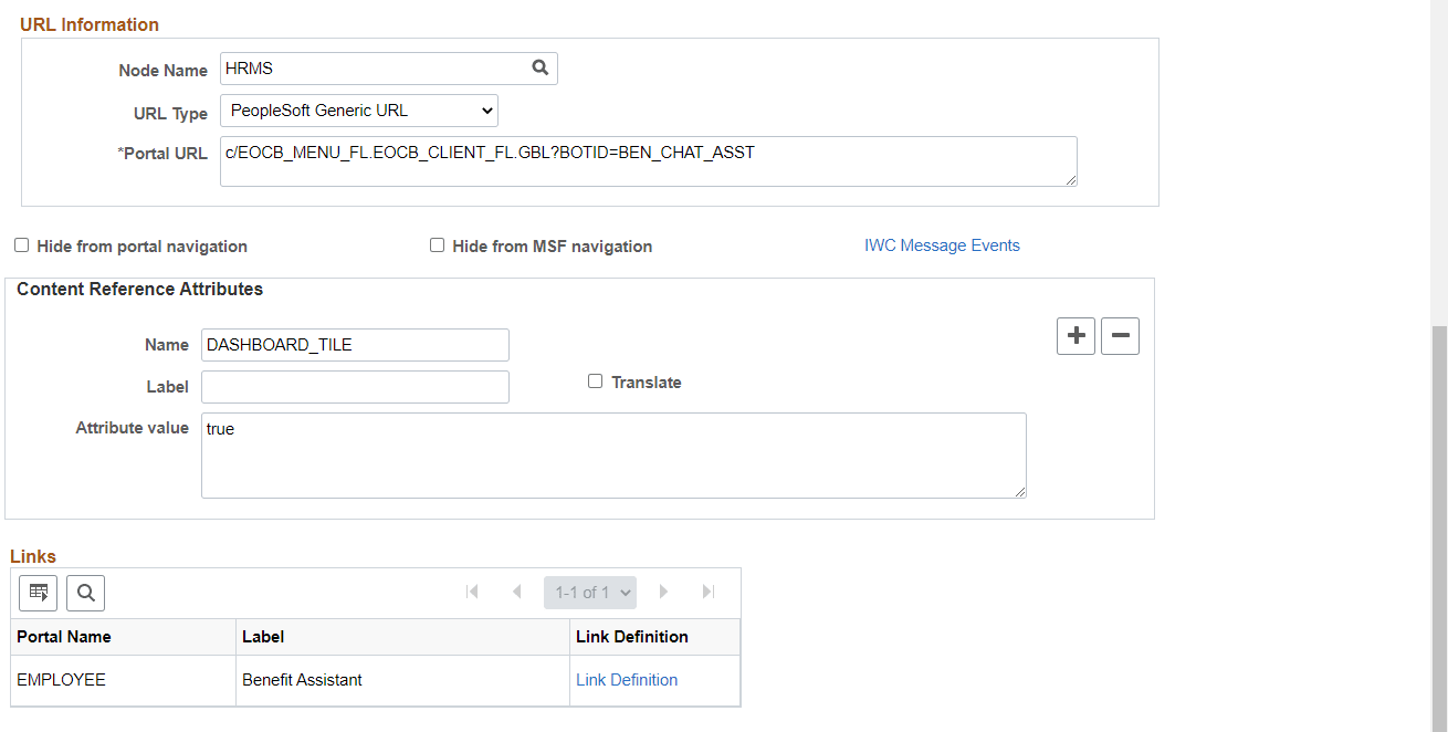

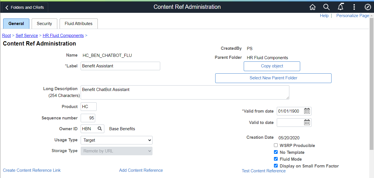

Content Ref Administration Page
Use the Content Ref Administration (PORTAL_CREF_ADM) page — Fluid Attributes tab (PORTAL_GROUPLET), to add the Benefits Assistant tile to the Benefit Details dashboard.
Navigation:
PeopleTools, and then Portal, and then Structure and Content.
Then select Self Service , and then HR Fluid Components.
Under Content References, select Edit for the label Benefits Assistant and select Fluid Attributes tab.
For details, refer the topic: Enterprise Components: Adding Chatbot to Application pages.
This example illustrates the fields and controls on the Content Ref Administration page (1 of 2).
This example illustrates the fields and controls on the Content Ref Administration page (2 of 2).

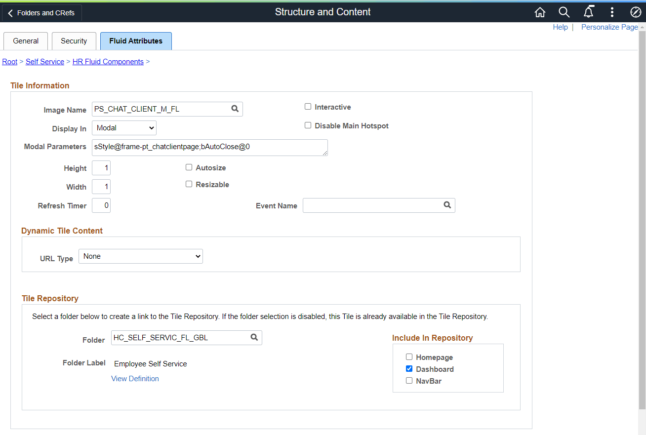

Select the Fluid Attributes tab to open the Tile Repository section.
This example illustrates the fields and controls on the Fluid Attributes tab.
Structure and Content page
Select the Dashboard checkbox under Include In Repository to enable the Benefits Assistant tile to the Benefit Details Tile dashboard.

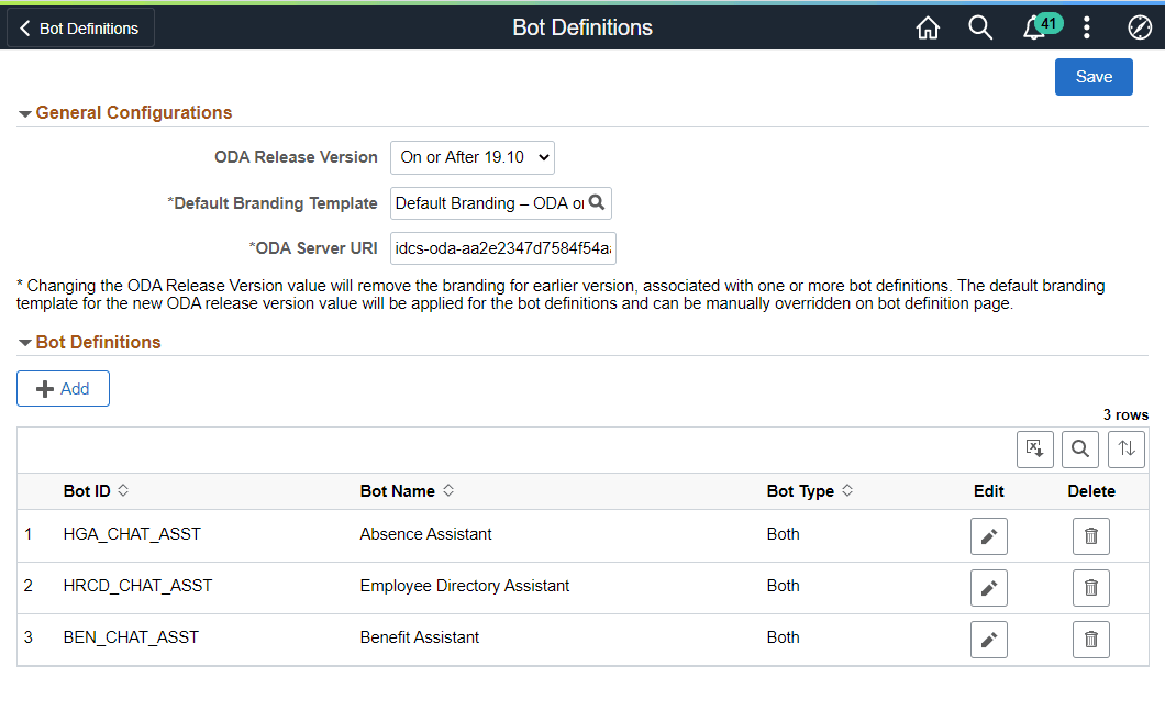

Bot Definitions Page
Use the Bot Definitions (EOCB_BOTSRCH_FL) page to view the existing chatbot identifiers and newly define a chatbot.
Navigation:
Enterprise Components, and then Chatbot Configurations, and then Bot Definition
This example illustrates the fields and controls on the Bot Definition Page. You can find definitions for the fields and controls later on this page.
Bot Definitions page
Field or Control Description
Add icon
Select Add to open the Add Bot Definition page to create a new bot definition.

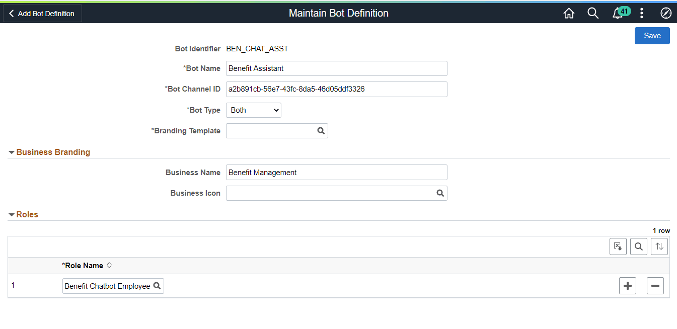

Maintain Bot Definition page
Use the Maintain Bot Definition page (EOCB_BOTDEFN_FL) to view the existing definitions for a chatbot.
Navigation:
Enterprise Components, and then Chatbot Configurations, and then Bot Definitions
This example illustrates the fields and controls on the Maintain Bot Definition page. You can find definitions for the fields and controls later on this page.
Bot Identifier
Displays the root package ID defined in the application server.
Bot Name
Enter the name of the chatbot.
Bot Channel ID
Specify the channel ID generated by the ODA Skill created for this chatbot. This ID links the chatbot with the skills in the ODA.
Bot Type
Choose whether to deploy the chatbot client as a tile or as a widget in a page or both. Bot types are embedded (for components) and widget (lower right-hand corner button).
Branding Template
Choose the Branding template for the bot.
Business Name
Name of the chatbot as it will appear to the users.
Business Icon
Choose the bot icon according to your business need. Refer, PeopleTools: Creating Image Definitions, for more information.
Role Name
Choose the roles that should be given access to this chatbot.
For details, refer Enterprise Components Documentation Enterprise Components: Understanding the Chatbot Architecture.

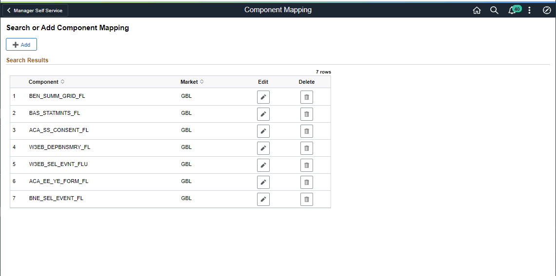

Component Mapping Page
Use the Component Mapping page (EOCB_COMPSRCH_FL) to choose the component (that is, the Benefits fluid page) on which the Benefits Assistant widget should be made available.
Navigation:
Enterprise Components, and then Chatbot Configurations, and then Component Mapping
This example illustrates the fields and controls on the Component Mapping Page.
BA_Component Mapping Page
Component
Displays the fluid components or fluid Benefits pages on which the Benefits Assistant widget can be enabled.
Edit
Click the Edit button to access the Maintain Component Mapping page and enable the Benefits Assistant on the component pages.
