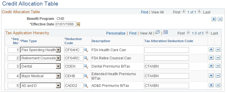

Credit Allocation Table Page
Use the Credit Allocation Table page (CAN_BA_HIER_TBL) to set up Credit Allocation tables.
Navigation:
Set Up HCM, and then Product Related, and then Automated Benefits, and then Flex Credit Management, and then Credit Allocation Table, and then Credit Allocation Table
This example illustrates the fields and controls on the Credit Allocation Table page. You can find definitions for the fields and controls later on this page.
Use this page to enter credit allocation hierarchy records and assign the priority sequence order of the allocation of flexible credits to benefit plans; link benefit plan deduction codes with their corresponding tax alteration deduction codes.
Field or Control Description
Seq Nbr (sequence number)
The system's tax optimization feature assesses the credit usage of the deductions in the order they are listed here.
For example, credits are applied first to sequence number 1 (perhaps the variable taxation plan type Dental), second to sequence number 2 (perhaps the variable taxation plan type Medical/Dental), third to sequence number 3 (perhaps the variable taxation plan type AD/D), and so on. If insufficient credit earnings are available during payroll processing to cover the entire premium costs of the Dental, Medical/Dental, or AD/D plan types, taxable benefit deduction amounts are automatically processed for the amounts of the shortages, using the applicable tax alteration deduction code.
Deduction Code
Specify one of the before-tax variable-taxation benefit-plan deduction codes that you defined on the Deduction Table - Tax Class page.
Tax Alteration Deduction Code
Specify a taxable benefit general deduction that you defined on the General Deduction Table page.
