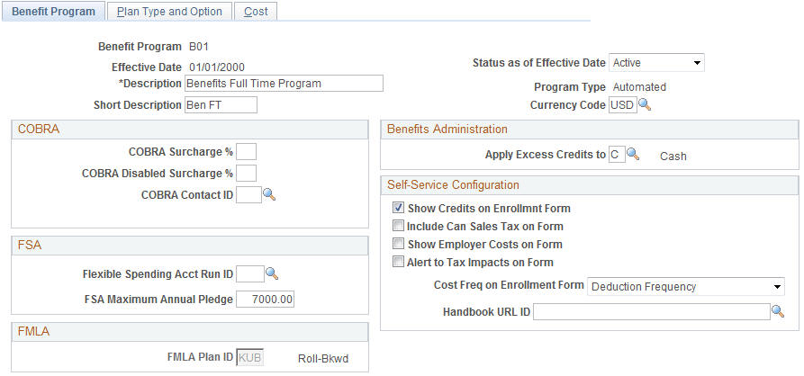

Benefit Program Page
Use the Benefit Program page (BEN_PROG_DEFN1) to add business rules for benefit programs.
Navigation:
Set Up HCM, and then Product Related, and then Base Benefits, and then Program Structure, and then Benefit Program Table, and then Benefit Program
This example illustrates the fields and controls on the Benefit Program page. You can find definitions for the fields and controls later on this page.
Field or Control Description
Flexible Spending Acct Run ID (flexible spending account run ID)
Each time you initiate claim payment processing, identify the run ID for that cycle. The system processes claim data for employees in the benefit programs with those run IDs.
FSA Maximum Annual Pledge (flexible spending account minimum annual pledge)
Enter the maximum amount that an employee in the benefit program is allowed to pledge. For a plan year, this is the total maximum that an employee can pledge for both health-care and dependent-care FSAs.
