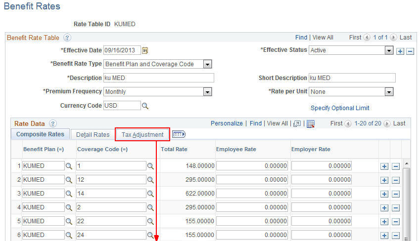

For Health Plans, define tax adjustment rates for coverage codes 22 and 24. Other coverage codes do not require tax adjustment rates.
This example illustrates the fields and controls on the Benefit Rates page.
Benefit Rates page

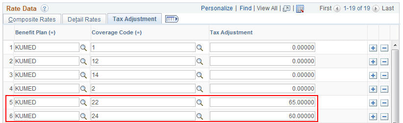

This example illustrates the fields and controls on the Benefit Rates — Tax Adjustment page.
Benefit Rates - Tax Adjustment page

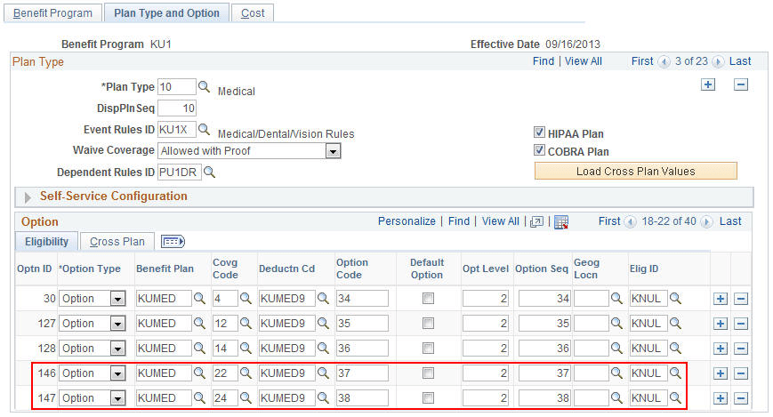

On the Benefits Program Table for Health Plans, add options for coverage codes 22 and 24.
Since coverage codes associated with same sex and heterosexual marriage can be identified, the same Benefit Rates Table can be used for both, but with a different set of tax adjustment rate entries accordingly.
This example illustrates the fields and controls on the Benefit Program — Plan Type and Option page.
Benefit Program - Plan Type and Option page

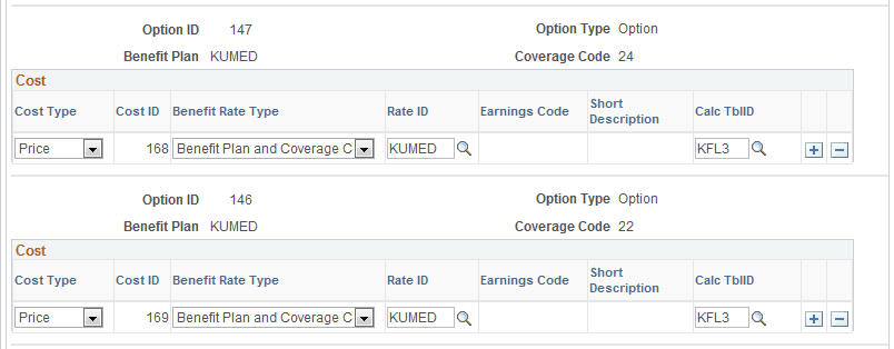

This example illustrates the fields and controls on the Benefit Program page for coverage codes 22 and 24.
Benefit Program page - Options
