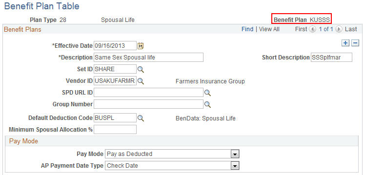

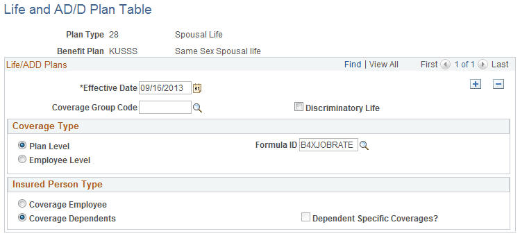

The following screenshots provide sample setup for spousal life insurance plans.
This example illustrates the fields and controls on the Benefit Plan Table page.
This example illustrates the fields and controls on the Life and AD/D Plan Table page.
Life and ADD Plan Table page

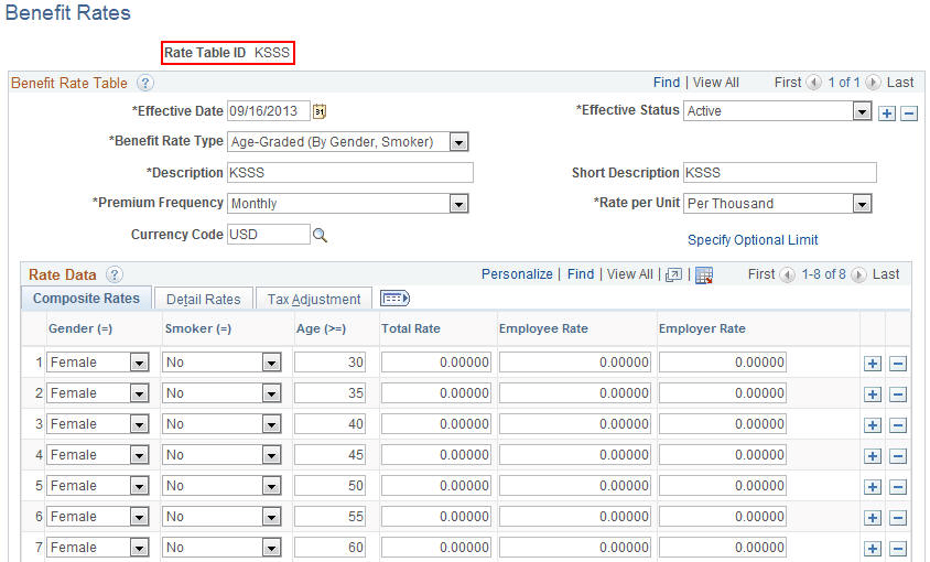

Additionally, create a new benefit rate ID on the Benefit Rates Table with tax adjustment amounts for same-sex spouse.
This example illustrates the fields and controls on the Benefit Rates page.
Benefit Rates page

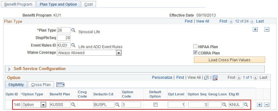

Add option entries for same-sex spouse using a separate benefit plan and different benefit rate ID.
This example illustrates the fields and controls on the Benefit Program — Plan Type and Option page.
Benefit Program - Plan Type and Option page

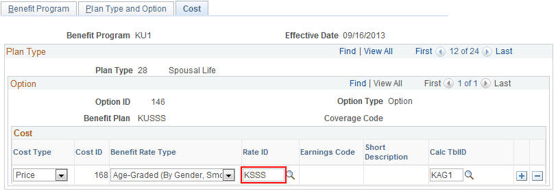

This example illustrates the fields and controls on the Benefit Program — Cost page.
Benefit Program - Cost page
