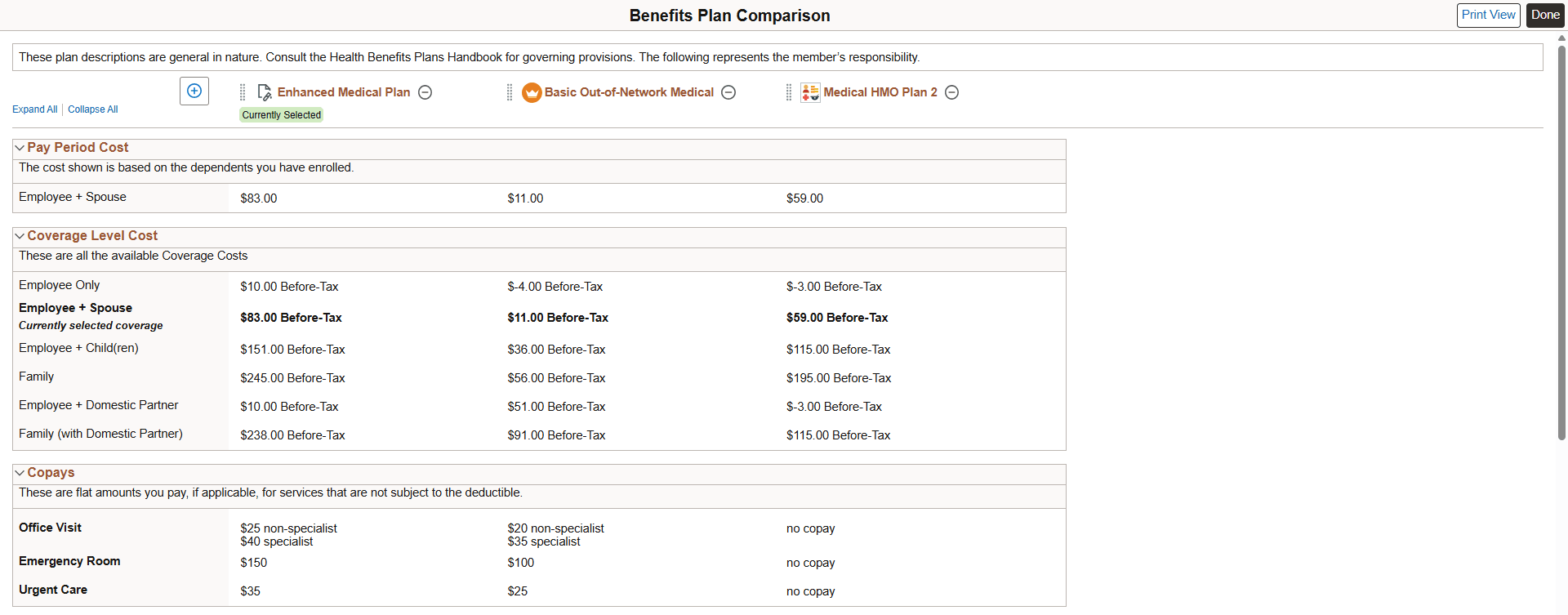

Select the Benefits Enrollment tab on the left panel, and select a plan type under the Benefit Plans section. In the plan page, select the plans to compare under the Enroll in Your Plan section. Select the Compare button, to open the Benefits Plan Comparison page.
Plan comparison is available only if a comparison template is set up for the benefit program plan type. For Waive option, the Compare Plan check box is disabled. The Benefits Plan Comparison page displays the data based on the event date. For example, to enroll dependents after a life event, the benefits plan comparison page displays the comparison template and the plan data corresponding to the life event date.

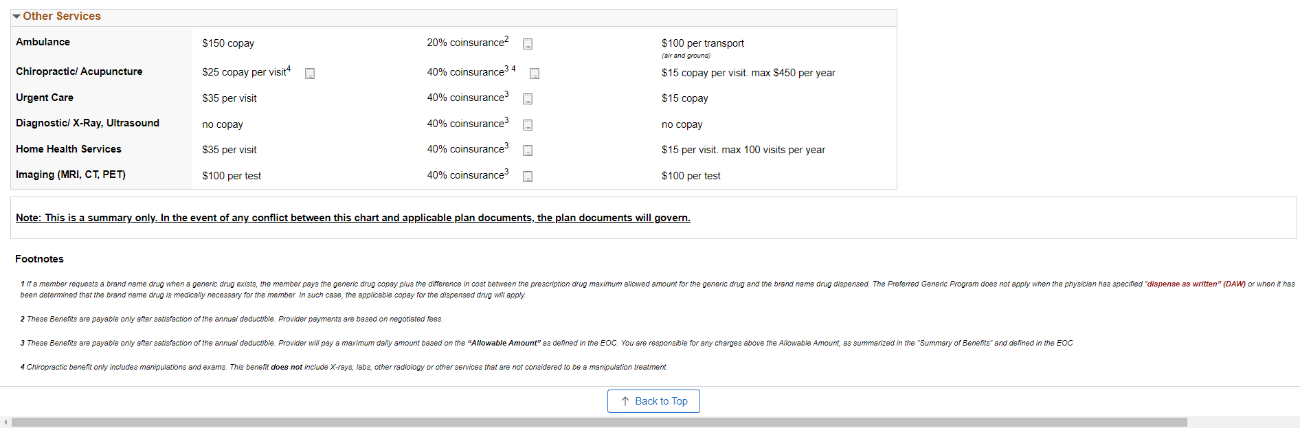

This example illustrates the fields and controls on the Benefits Plan Comparison page (1of 2).
Benefits Plan Comparison page (Page 1 of 2)
This example illustrates the fields and controls on the Benefits Plan Comparison page (2 of 2).
Benefits Plan Comparison (Page 2 of 2)
