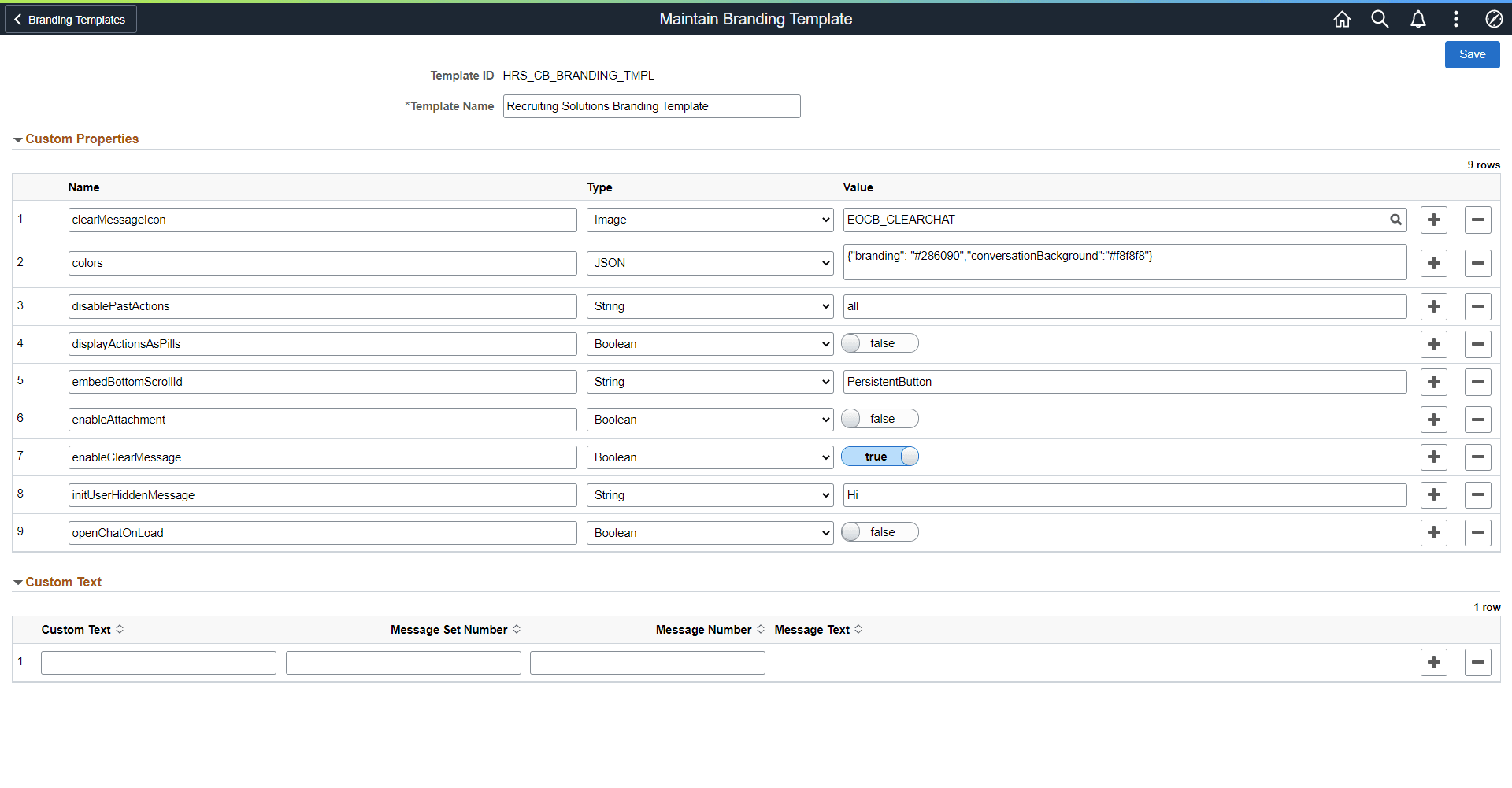

Branding Template Page
EOCB_BRNDTMPL_FL
Use this page to define the template to brand the chatbot.

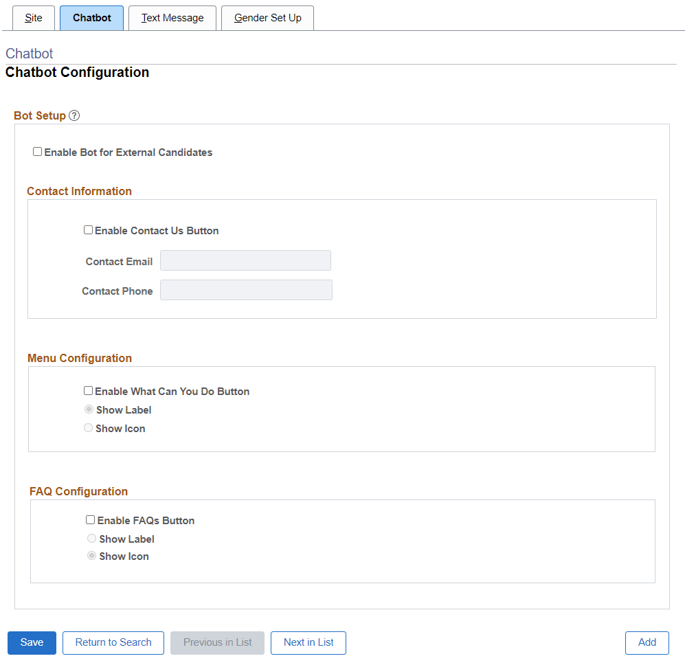

Chatbot Page
HRS_SITE_BOT_SETUP
Use this page to enable the chatbot and to configure Contact, Menu and FAQ options in the chatbot.

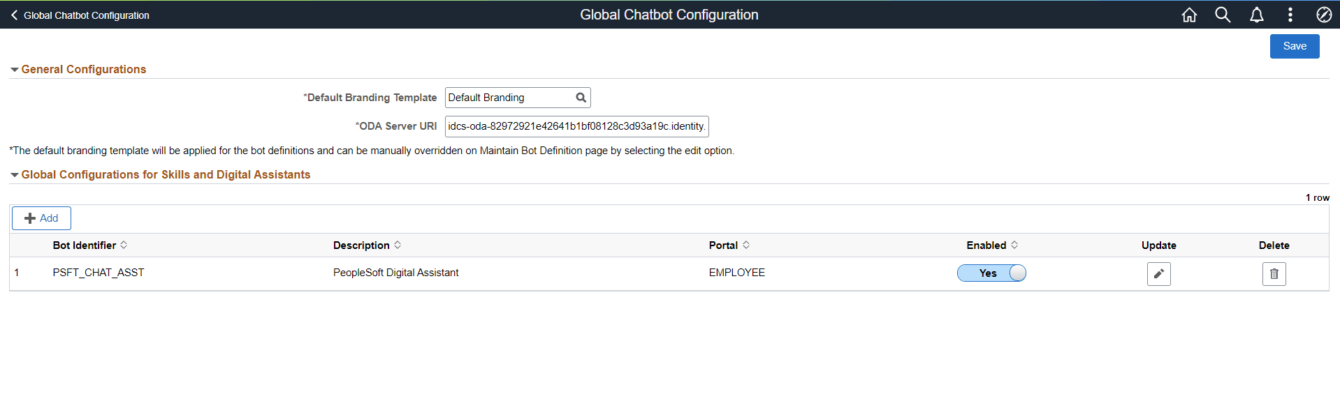

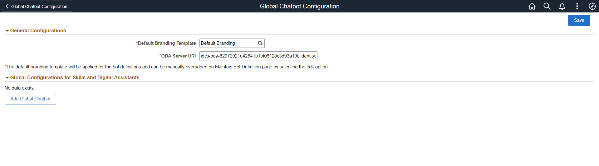

Global Chatbot Configuration Page
Use the Global Chatbot Configuration (EOCB_SKILLSRCH_FL) page to view, edit, or add global chatbot definitions for the skills and digital assistants created in Oracle Digital Assistant (ODA), and to map them to a component. You can also activate or delete global chatbot definitions from this page.
Navigation:
Enterprise Components, and then Chatbot Configurations, and then Global Chatbot Configuration
This example illustrates the fields and controls on the Global Chatbot Configuration Page.
Global Chatbot Configuration for PICASO
Field or Control Description
Default Branding Template
Enter the default branding template for the global chatbot. Branding templates control the chatbot color scheme, initial greeting, attachments, and other behaviors.
For more information on creating a template, see Branding Template Page.
ODA Server URI
Enter the Uniform Resource Identifier (URI) of your ODA instance.
Add Global Chatbot or Add
Access the Global Chatbot Configuration Page and create a new chatbot definition.
Note: When there are one or more chatbot definitions, Add button is displayed.
Bot Identifier
Displays the identifier for the global chatbot in ODA.
Description
Displays the description of the global chatbot definition.
PORTAL
Displays the PeopleSoft portal associated with the global chatbot.
Enabled
Enable or disable the global chatbot definition.
Update
Update existing global chatbot definition.
Delete
Delete an existing global chatbot definition.
Save
Save an existing global chatbot definition.

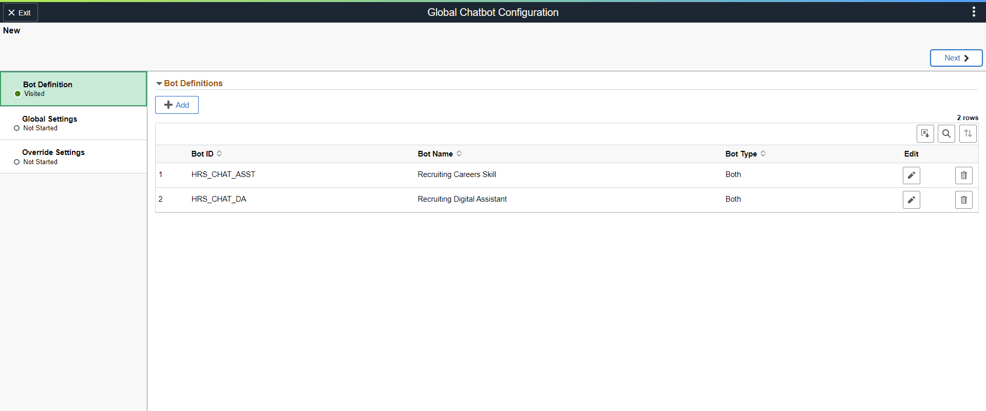

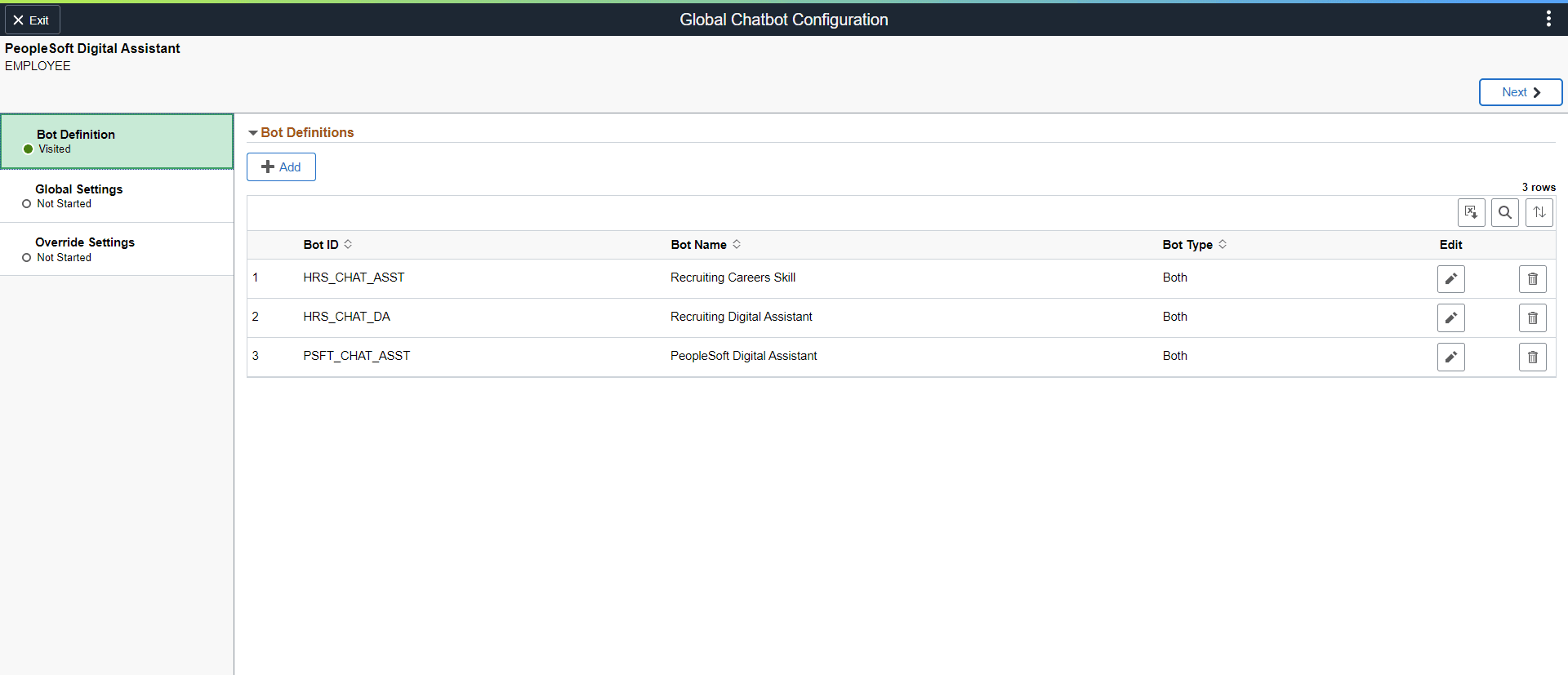

Global Chatbot Configuration – Bot Definition Page
Use the Global Chatbot Configuration – Bot Definition page (EOCB_BOTCFG_FL) to view, edit, or add chatbot definitions.
Navigation:
  • Enterprise Components, and then Chatbot Configurations, and then Global Chatbot Configuration, and then Add for new chatbot definitions.
  • Enterprise Components, and then Chatbot Configurations, and then Global Chatbot Configuration, and then Update for existing chatbot definitions.
This example illustrates the fields and controls on the Bot Definition page.
Bot Definition – PeopleSoft Digital Assistant
Add
Access the Add Bot Definition Page and add a new chatbot definition.
Bot ID
Displays the ID of the skill or digital assistant.
Bot Name
Displays the name of the skill or digital assistant.
Bot Type
Displays the format in which the chatbot client is rendered. Values are Web Based, Widget, or Both.
  • Web Based – Renders the chat client as a tile.
  • Widget – Renders the chat client as a button at the bottom of the screen.
  • Both – Renders the chat client in web and widget formats.
Edit
Access the Edit Bot Definition page and update the chatbot definition.
Delete
Delete an existing chatbot definition.
Next
Advance to the next step of global chatbot configuration.
Update

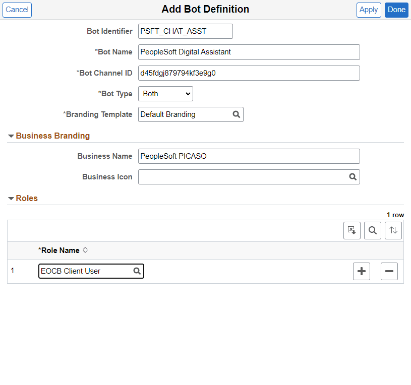

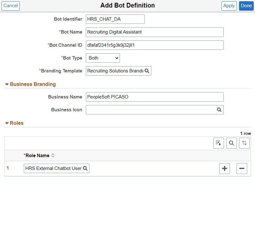

Click the Add button on the Global Chatbot Configuration – Bot Definition to add chatbot definitions for:
  • PeopleSoft Digital Assistant
  • Recruiting Digital Assistant
  • Recruiting Careers Skill
This example illustrates the fields and controls on the Add Bot Definition page.
Add Bot Definition – PeopleSoft Digital Assistant
Bot Identifier
Displays the ID of the selected skill or digital assistant.
Bot Name
Enter the name of the skill or digital assistant.
Bot App ID
Enter the ID of the channel you want to use to route a chat request to an ODA Skill or Digital Assistant.
  • For PeopleSoft Digital Assistant, enter the channel ID for PeopleSoft Digital Assistant in ODA.
  • For Recruiting Digital Assistant and Recruiting Careers Skill, enter the channel ID for Recruiting Digital Assistant in ODA.
Bot Type
Select the format in which the chatbot client is rendered. Available types are Web Based, Widget, or Both.
Introductory Text
Enter text to describe the chatbot.
Branding Template
Select a replacement branding template to override the default branding template value.
  • For PeopleSoft Digital Assistant, select the default template.
  • For Recruiting Digital Assistant and Recruiting Careers Skill, select the Recruiting Solutions template.
Business Name
Enter the name for chatbot to appear for users on the chatbot client.
Business Icon
Select an icon for the chatbot. The chatbot client takes the form of the icon you specify.
Role Name
Select user roles that can access the chatbot.
Note: To access Recruiting Digital Assistant, select HRS External Chatbot User role.

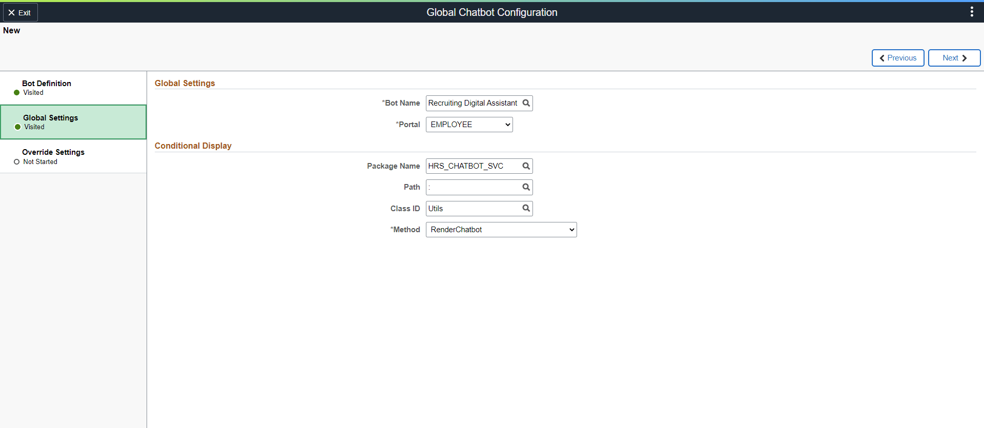

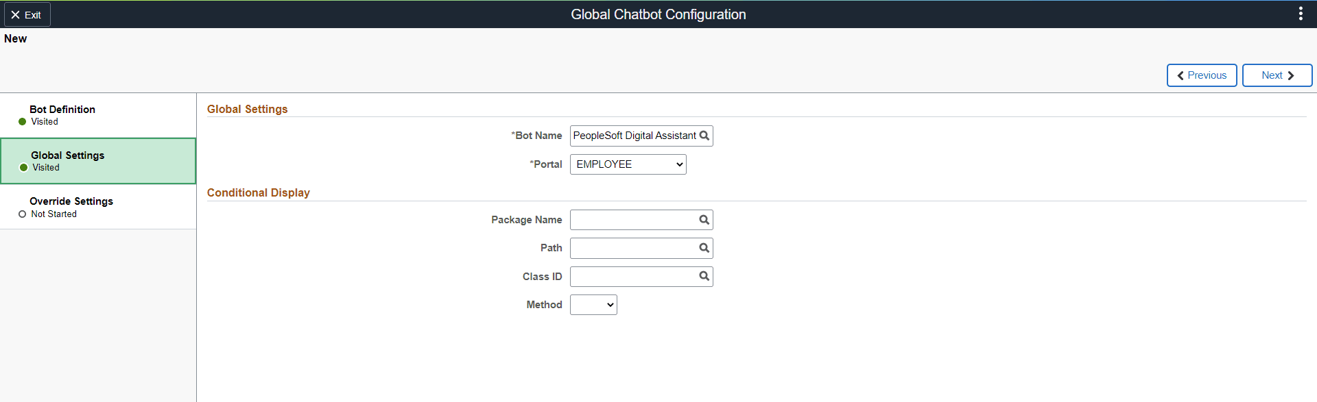

Global Chatbot Configuration – Global Settings Page
Use the Global Chatbot Configuration – Global Settings page (EOCB_GLBL_STTNG_FL) to select a skill or digital assistant as a global chatbot and associate it with a PeopleSoft portal. You can also define conditional display to prevent the display of global chatbot in components.
Navigation:
Select the Next button on the Global Chatbot Configuration – Bot Definition Page.
This example illustrates the fields and controls on the Global Settings page.
Global Settings for PICASO
Bot Name
Select the skill or digital assistant to serve as a global chatbot.
A global chatbot is visible across all components within PeopleSoft portal.
Portal
Select a PeopleSoft portal to associate with the global chatbot.
Package Name
Select the PeopleTools application package related to your conditional display requirement.
Path
Select the path (location) of the PeopleTools Application Class related to your conditional display requirement.
Class ID
Select the PeopleTools Application Class related to your conditional display requirement.
Method
Select the application class method.
To configure Recruiting Digital Assistant with PICASO, select PeopleSoft Digital Assistant as Bot Name in Global Settings. Select EMPLOYEE for Portal.

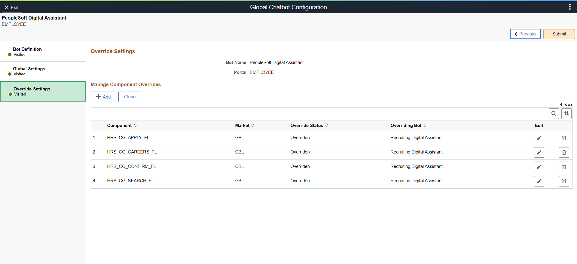

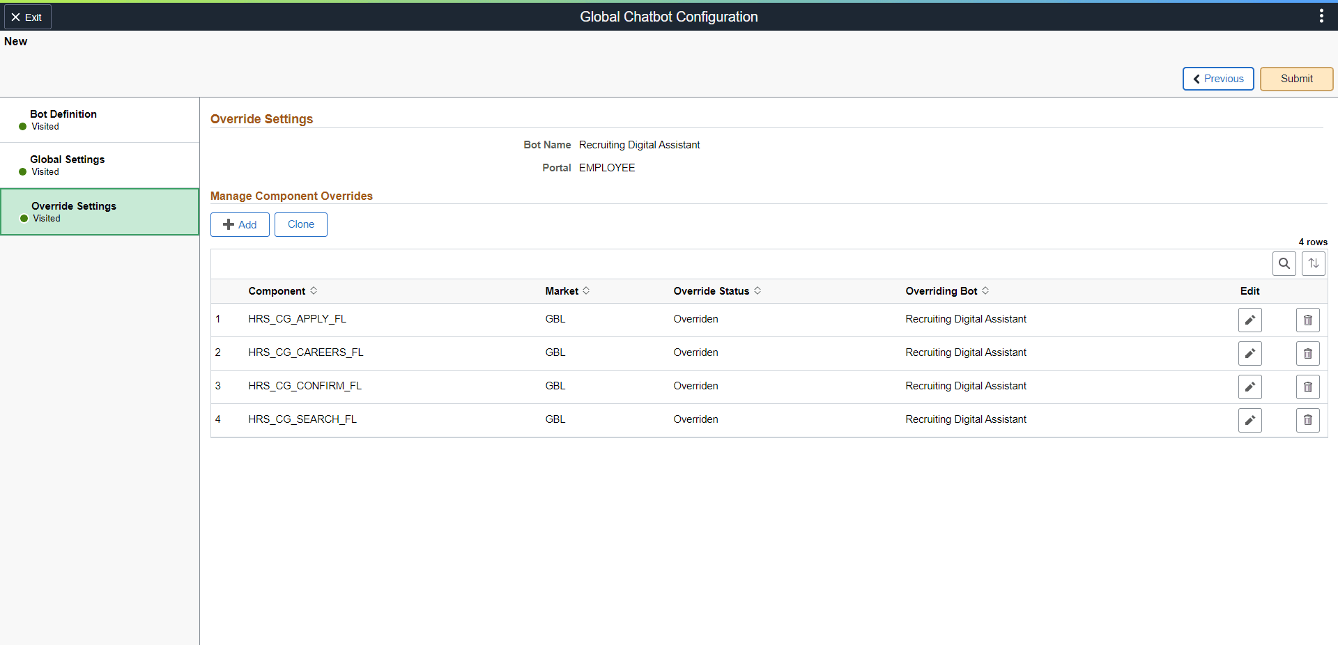

Global Chatbot Configuration – Override Settings Page
Use the Global Chatbot Configuration – Override Settings page (EOCB_OVRRDE_CMP_FL) to view existing global chatbot overrides for a component, add new overrides, or clone overrides.
Navigation:
Select the Next button on the Global Chatbot Configuration – Global Settings Page.
This example illustrates the fields and controls on the Override Settings page.
Override Settings - PeopleSoft Digital Assistant
Bot Name
Displays the name of skill or digital assistant to serve as a global chatbot.
Portal
Add
Select to access the Add Override Settings Page and hide the global chatbot or override it with a different chatbot.
Clone
Select to access the Clone Component Overrides Page and clone component override settings from an existing chatbot definition.
Component
Displays the PeopleSoft component with override settings.
Market
Displays the market for the component. Default is global market (GBL).
Override Status
Displays the override status for the component
Overriding Bot
Displays the chatbot that overrides the global chatbot.
Edit
Select to access the Edit Override Settings page and edit the override settings for the component.
Delete
Delete an existing global chatbot override.
Add the components of Recruiting Solutions pages where Recruiting Digital Assistant overrides PICASO.

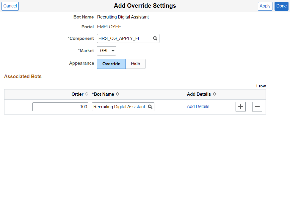

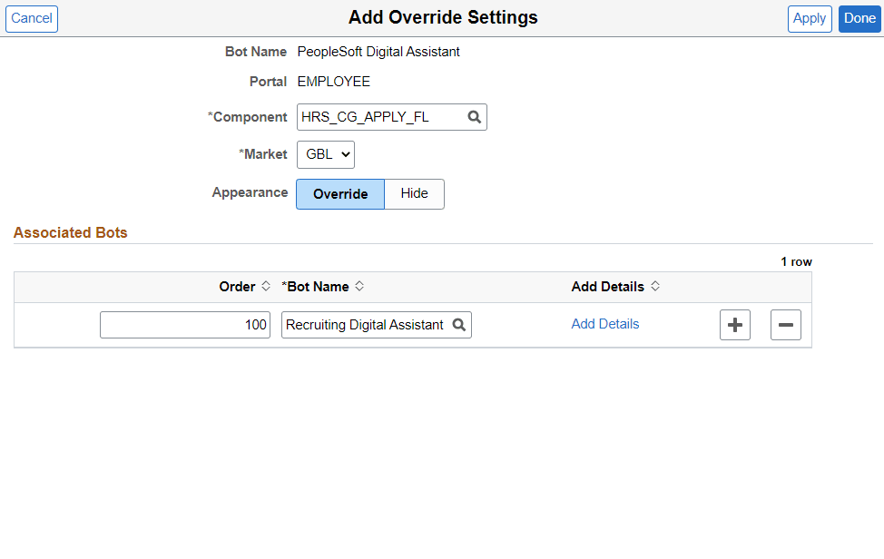

Use the Add Override Settings page (EOCB_CMP_OVRD_FL) to hide the global chatbot from a component or override it with a different chatbot. This page is useful when you want to override the global chatbot for only a few components.
Navigation:
Select the Add button on the Global Chatbot Configuration – Override Settings Page.
This example illustrates the fields and controls on the Add Override Settings page.
Add Override Settings - PeopleSoft Digital Assistant
Bot Name
Displays the name of skill or digital assistant that serves as global chatbot.
Portal
Component
Select the component for which you want to override the global chatbot.
Market
Appearance (Override or Hide)
Select Override to override the global chatbot with a different chatbot on the specified component.
Select Hide to hide the global chatbot on the specified component.
Order
When multiple chatbots are associated with the component, enter a numeric value to indicate the order in which the chatbots are displayed to a user.
Bot Name
Select the skill or assistant to override the global chatbot.
Add Details
Select to access the Add Chatbot Parameters Page and define the conditions or order in which the chatbot displays.
Enter the components of Recruiting Solutions pages where Recruiting Digital Assistant overrides PICASO.

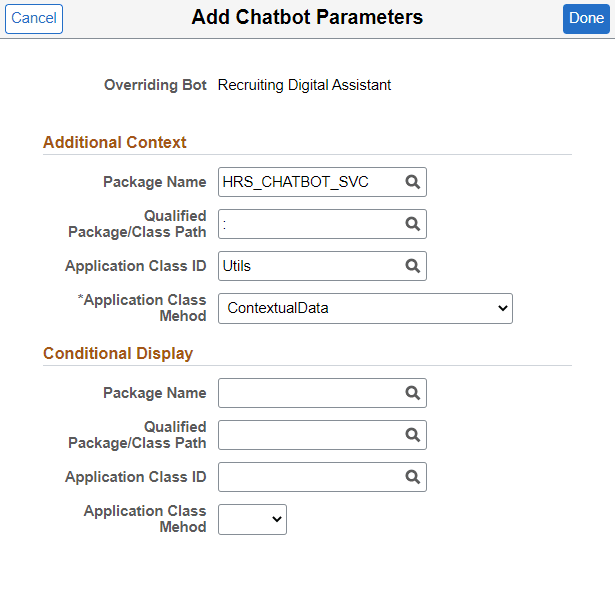

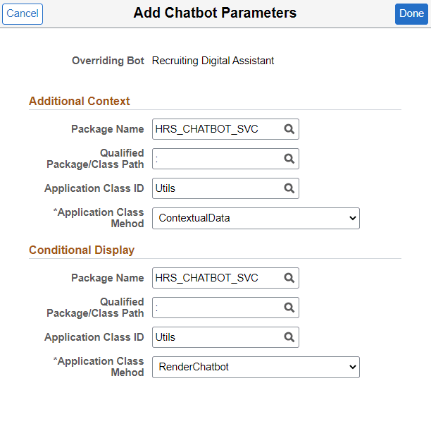

Use the Add Chatbot Parameters page (EOCB_OVRD_MAP_SCF) to define the conditions or order in which the chatbot displays, when overriding or restricting the global chatbot from a component.
Navigation:
Select the Add Details link on the Add Override Settings Page.
This example illustrates the fields and controls on the Add Chatbot Parameters page.
Add Chatbot Parameters – PeopleSoft Digital Assistant
Package Name
Qualified Package/Class Path
Application Class ID
Application Class Method
To override PICASO with Recruiting Digital Assistant, enter the Additional Context and Conditional Display parameters specific to Recruiting Solutions.

  1. Click the Add Global Chatbot button in Global Chatbot Configuration page.
  2. Click the Add button in the Global Chatbot Configuration – Bot Definition (EOCB_BOTSRCH_FL) page to enter chatbot definitions for Recruiting Digital Assistant and Recruiting Careers Skill.
    This example illustrates the fields and controls on Global Chatbot Configuration – Bot Definition page.
    Bot Definition – Recruiting Digital Assistant
  3. Enter the details for chatbot definition in the Add Bot Definition page.
    Add Bot Definition – Recruiting Digital Assistant
    For more information on the chatbot definition for Recruiting Digital Assistant, see Global Chatbot Configuration – Bot Definition Page
  4. Define the global settings for Recruiting Digital Assistant in the Global Chatbot Configuration – Global Settings (EOCB_GLBL_STTNG_FL) page.
    Global Settings - Recruiting Digital Assistant
    Use Conditional Display to control the display of chatbot in the selected portal. Enter the Conditional Display parameters to specify the override condition for Recruiting Digital Assistant.
    For more information on global settings, see Global Chatbot Configuration – Global Settings Page
  5. Click the Add button in the Global Chatbot Configuration – Override Settings (EOCB_OVRRDE_CMP_FL) page to enter the components to display Recruiting Digital Assistant.
    Override Settings – Recruiting Digital Assistant
    For more information on override settings, refer Global Chatbot Configuration – Override Settings Page.
  6. Enter the name of the component and the chatbot to override the global chatbot in the Add Override Settings page.
    Add Override Settings – Recruiting Digital Assistant
    For more information on add override settings page, see Add Override Settings Page.
  7. Click on the Add Details link to define the context parameters for Recruiting Digital Assistant.
    Add Chatbot Parameters – Recruiting Digital Assistant
    To know more on how to add chatbot parameters, refer Add Chatbot Parameters Page.
Use the Branding Template(EOCB_BRNDTMPL_FL) page to control the branding aspects of the chatbot definition.
Navigation:
Enterprise Components, and then Chatbot Configurations, and then Branding Template
This example illustrates the Maintain Branding Template page.
Maintain Branding Template – RS
Template ID
ID of the branding template on which chatbot specific template is created.
Template Name
Enter a new name for the chatbot specific branding template.
Custom Properties
Choose the custom properties for the chatbot, from ODA, to customize the chatbot layout, color and icons. In the Name field, enter the appropriate name reference as listed in the ODA documentation.
Custom Text
PeopleSoft provisions custom text to overwrite the default custom texts provided by ODA. The overriding text is created as a message catalog entry. The message catalog entry is assigned to the custom text key value.
Choose the appropriate Custom Text as listed in the ODA documentation to configure the default text that is displayed in the chat client.

Use the Chatbot Page (HRS_SITE_BOT_SETUP) to configure and enable Recruiting Digital Assistant.
Navigation:
Set Up HCM, and then Product Related, and then Recruiting, and then Candidate Gateway, and then Site, and then Chatbot
This example illustrates the Chatbot page.
Site Set Up (Careers) – Chatbot
Enable Bot for External Candidates
Select the check box to enable Recruiting Digital Assistant for external candidates. Once enabled, Recruiting Digital Assistant displays as a floating icon on the External Candidate Gateway and on the job search and application pages.
Note: Recruiting Digital Assistant is available only if the guest user id is associated with the HRS External Chatbot User role.
Contact Information
Enable Contact Us Button
Select the check box to display the Contact Us button in Recruiting Digital Assistant.
Once enabled, a Contact Us button appears at the bottom of the chat window.
Note: When this check box is enabled, at least one value (email or phone number) should be entered. You must save the page after entering the value, for the Contact Us button to be displayed in the chatbot.
Contact Email
Enter the email address to be displayed in the Recruiting Digital Assistant, when the Contact Us button is clicked.
Contact Phone
Enter the phone number to be displayed in the Recruiting Digital Assistant, when the Contact Us button is clicked.
Menu Configuration
Enable What Can You Do Button
Select the check box to display What Can You Do? button in Recruiting Digital Assistant.
Once enabled, a menu icon will appear at the bottom of the chat window. This menu will display all possible actions that the chatbot can perform for the logged in applicant.
Note: This button appears only for the logged in applicants.
Show Label
Select this option if you want to display the label, What Can You Do? on the button.
Show Icon
Select this option if you want to display the icon as the button.
FAQ Configuration
Enable FAQs Button
Select the check box to display FAQs button in Recruiting Digital Assistant.
Once enabled, FAQs button with text or icon appears at the bottom of the chat window.
Note: For FAQs to work, at least one answer intent must be added in the Recruiting Careers Skill in ODA.
Show Label
Select this option if you want to show the label FAQs on the button.
Show Icon
For more information on Recruiting Digital Assistant configuration, see the PeopleSoft Recruiting Digital Assistant Technical Brief (Doc ID 2741723.1) posted in My Oracle Support.
