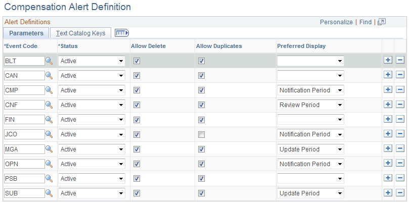

Compensation Alert Definition Page
Use the Compensation Alert Definition page (WCS_ALERT_SETUP) to define and configure compensation alerts for use within the eCompensation Manager Self Service functionality.
Navigation:
Set Up HCM, and then Product Related, and then Compensation, and then Utilities, and then Compensation Alert Definition, and then Compensation Alert Definition
This example illustrates the fields and controls on the Compensation Alert Definition page.
The PeopleSoft eCompensation Manager Desktop application delivers 18 alert definitions. The Compensation Alert Definition component, however, is strictly intended for the maintenance of the valid alert message definitions that are available for processing. The records in the tables are delivered as default data and should only be changed or manipulated in cases where your implementation demands it.
Parameters Tab
Field or Control Description
Event Code
Displays the code that determines which event needs to be raised.
Status
Select Active to activate a specific event for processing.
Allow Delete and Allow Duplicates
Select the Allow Delete check box to allow users to delete rows. If the Allow Duplicate check box has also been selected, then duplicate alert messages are supported. If the Allow Duplicates check box is deselected, the system replaces any existing message.
Preferred Display
Select either Default, Notify, Review, or Update to indicate the preferred time period the alert should be available for display. Please note that this preferred period may not be defined depending on how the cycle definition has been set up.
These display periods relate directly back to the same periods that have been set within the Administer Compensation Cycle component, which was created by the administrator. The actual range of date are specific to each cycle.
Text Catalog Keys Tab
Text catalog keys are used to populate the message text for the alert. The Object owner identifier, Sub ID and Text ID fields all contain existing prompt values currently in use when setting up the HR Test Catalog.

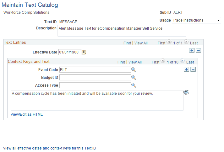

Maintain Text Catalog Page
Use the Maintain Text Catalog page (HR_SSTEXT_TEXT) to create or update the message text used for compensation alerts within the eCompensation Manager Self Service functionality.
Navigation:
Set Up HCM, and then Product Related, and then Compensation, and then Utilities, and then Compensation Alert Text, and then Maintain Text Catalog
This example illustrates the fields and controls on the Maintain Text Catalog page.
The PeopleSoft eCompensation Manager Desktop application delivers nine context keys that you can configure for your Manager Self Service pages.
Usage
Select one of these values based on how the text will be used:
  • Email Body
  • Email Subject
  • Error/Warning
  • Field Label
  • Grid/Scroll Heading
  • Groupbox Title
  • Hyperlink/Button
  • Page Instructions
  • Page Title
Event Code
Select one of these event codes:
  • APR - Group Status set to Approved.
  • BIP - Cycle Status set Building.
  • BLT - Cycle status set to Built.
  • CAN - Cycle status set to Canceled.
  • CLC - Group status set to Calculated.
  • CMP - Group status set to Completed.
  • CNA - Confirmer is added to a group.
  • CNF - Group status set to Confirmed.
  • DEF - Cycle Status set to Defined.
  • FIN - Cycle Status set to Finalized.
  • INP - Group Status to In Progress.
  • MGA - Manager added to a group.
  • OPN - Cycle status set to Open.
  • PSB - Group status Pushed Back.
  • RMV - Individual is removed a group.
  • RTL - Group status set to Ready.
  • RVA - Reviewer added to a group.
  • SUB - Group status set to Submitted.
Budget ID
Select a cycle ID with which you want to associate the text.
Access Type
Select one of these values to indicate the role that should have access to the text message:
  • Confirmer
  • Reviewer
  • Submitter
