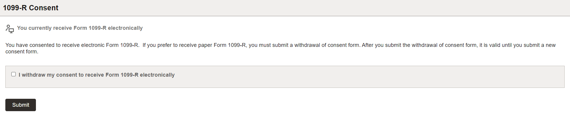

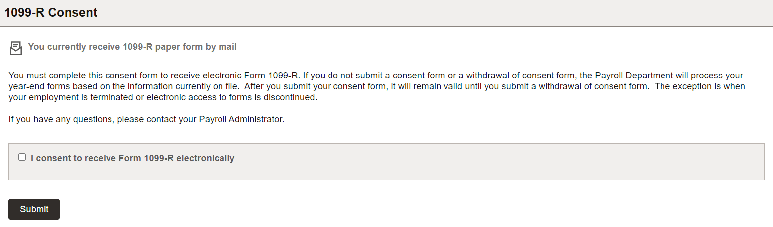

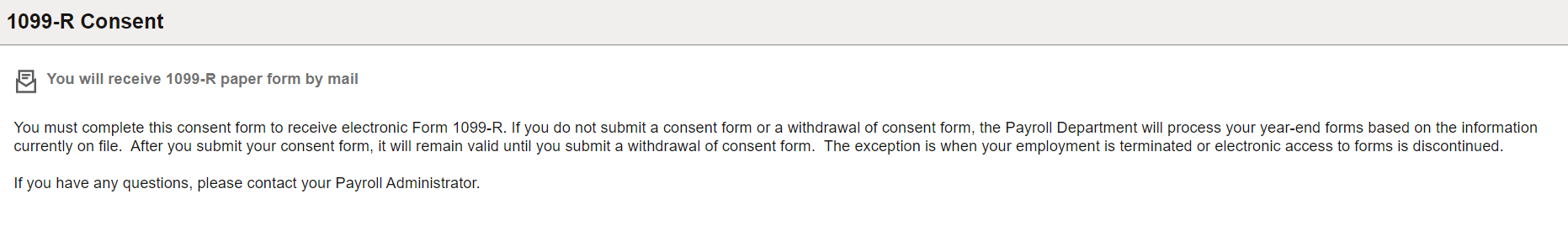

1099-R Consent Page
PY_1099R_CONS_FL
Submit or withdraw consent to receive electronic Form 1099-R.

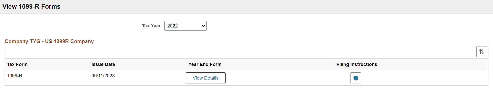

View 1099-R Forms Page
PY_SS_1099R_FRM_FL
View 1099-R forms in Employee Self-Service.

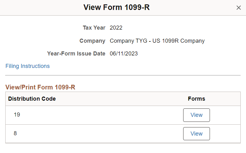

View Form 1099-R Page
PY_SS_1099R_SCF
Select and view 1099-R forms by distribution code.

Employees can submit or withdraw consent to receive year-end forms electronically using Fluid Self-Service.
To update the consent:
  1. Access the Payroll page using Payroll tile.
  2. Select the required consent page from the left navigation pane and select the check box to indicate that consent is being submitted or withdrawn.
  3. Once you select the Submit button, the Verify Identity Page appears for authentication.
  4. Enter your PeopleSoft user ID and password for identity verification and select the Continue button.
    The system updates the employee’s consent status, displays a confirmation page, and sends the employee a confirmation email. The confirmation email is sent to the employee’s preferred email address as indicated in the employee’s personal data record. If the employee does not have a preferred email address, the consent status is still updated, but a message informs the employee that no email will be sent.

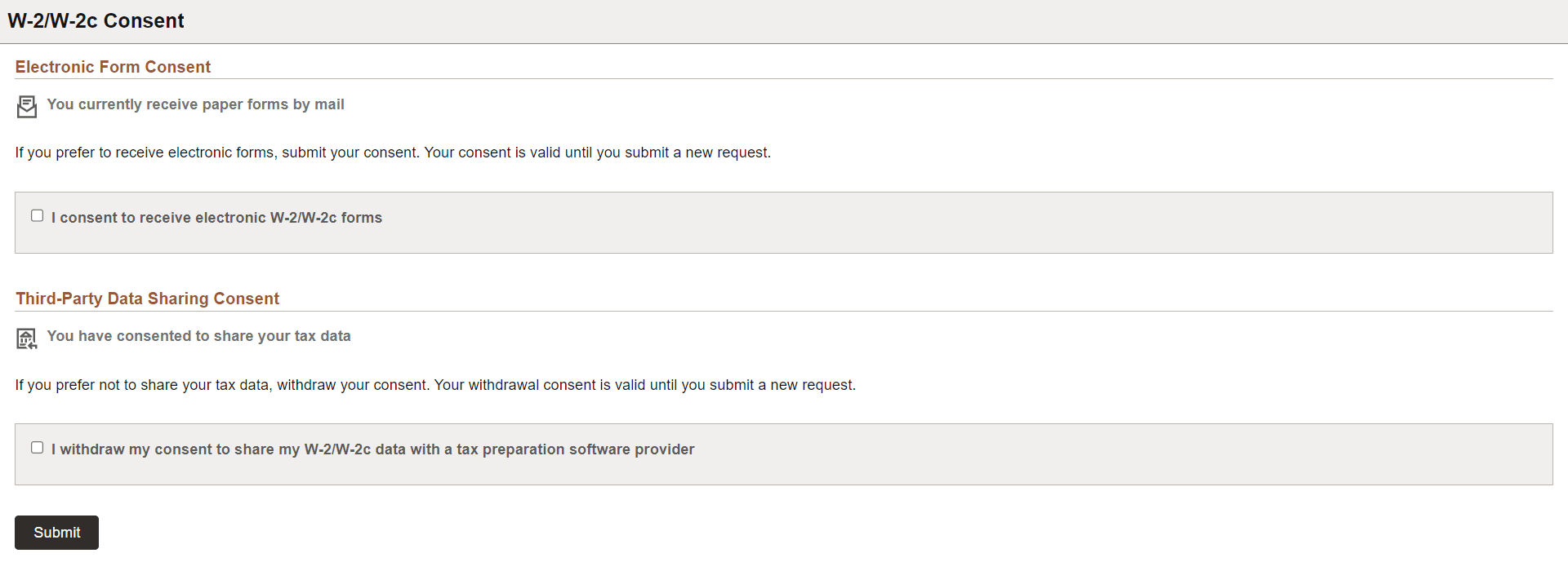

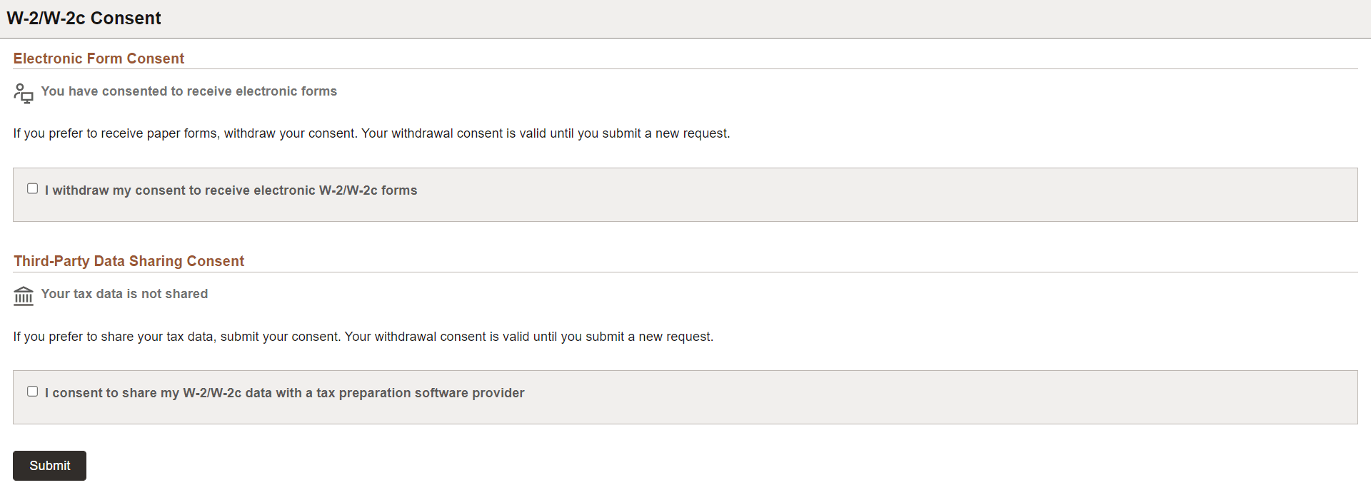

W-2/W-2c Consent Page
Use the W-2/W-2c Consent page (PY_W2_CONSENT_FL) to submit or withdraw consent to receive electronic W-2 and W-2c forms and share data with tax preparation software providers.
Navigation:
(Desktop) This example illustrates the W-2/W-2c Consent page for employees who are currently receiving paper forms and share data with tax preparation software providers.
W-2/W-2c Consent page (currently receiving paper form and sharing tax data with tax preparation software provider)
This example illustrates the W-2/W-2c Consent page for employees currently receiving electronic forms and do not share data with any tax preparation software provider.
W-2/W-2c Consent page (currently receiving electronic form and not sharing tax data with tax preparation software provider)
Electronic Form Consent
Field or Control Description
I consent to receive electronic W-2/W-2c forms
Select to give consent to receive the forms electronically and stop receiving paper forms.This check box appears if the employee currently receives the year-end form in paper by mail.
I withdraw my consent to receive electronic W-2/W-2c forms
Select withdraw consent and receive paper forms.This check box appears if the employee currently receives the year-end form electronically.
Third-Party Data Sharing Consent
This section appears when the Display Third-Party Data Sharing Consent in Self Service option is selected on the PeopleSoft Payroll for North America: Payroll for NA Installation Page.
I consent to share my W-2/W-2c data with a tax preparation software provider
Select to give consent to share W-2/W-2c data with a tax preparation software provider in an import file. This check box appears if:
  • The employee has not provided the consent.
  • The employee is newly hired and the system is configured to exclude the tax data for all employees from the import files. Or,
  • The administrator has run the process to reset the export consent status of employees to exclude their tax data from the import files.
I withdraw my consent to share my W-2/W-2c data with a tax preparation software provider
Select to withdraw consent to share W-2/W-2c data with a tax preparation software provider in an import file. This check box appears if:
  • The employee has provided the consent previously.
  • The employee is newly hired and the system is configured to include the tax data for all employees in the import files. Or,
  • The administrator has run the process to reset the export consent status of employees to include their tax data in the import files.
Submit
Select this button to submit the changes. Do not submit without selecting a check box first.
Enter your login information on the Verify Identity Page that appears for authentication purposes.

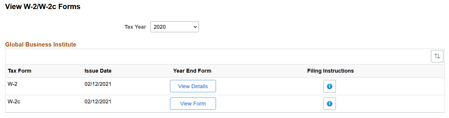

View W-2/W-2c Forms Page
Use the View W-2/W-2c Forms page (PY_SS_YEW2_FORM_FL) to view W-2/W-2c forms in Employee Self-Service.
Employees can submit or withdraw consent to stop receiving paper W-2 and W-2c forms using W-2/W-2c Consent Page.
Navigation:
(Desktop) This example illustrates the fields and controls on the View W-2/W-2c Forms page,where the employee can view forms electronically after giving the consent.
(Smartphone) This example illustrates the fields and controls on the View W-2/W-2c Forms page, viewed from a smartphone.
(Smartphone) View W-2/W-2c Forms page
Important:
You can also view the screen reader version (HTML) of year-end forms in standard mode, if the country-specific option is selected in the Fluid HTML View in Standard Mode section on the PeopleSoft Payroll for North America: Payroll for NA Installation Page,
To view the screen reader version of W-2/W-2c form pages, see View <Tax Form or Slip> Page (Screen Reader Mode) and View <Tax Form Name and Year> Page.
Tax Year
Select the tax year of the year-end forms you want to view or print. Year-end forms are listed by tax year.
Sort icon
Sort the list by Tax Form, Issue Date, or Company. Company will be available in the sort option only if multiple companies are available for the same tax year.
View Form
Select the button to view or print the year-end form in PDF.
Note: In screen reader mode, the system displays US forms online on a PeopleSoft page (in HTML) if the corresponding accessibility year-end setup is available for the selected year, in addition to the PDF version. This page will be displayed based on the setup that is defined on the Year End Accessibility Page.
View Details
Select the button to select and view tax forms by state on the View W-2 Details Page.
The button appears for employees with forms for different states.
Filing Instructions
Select to view or print the filing instructions of the tax form in PDF.

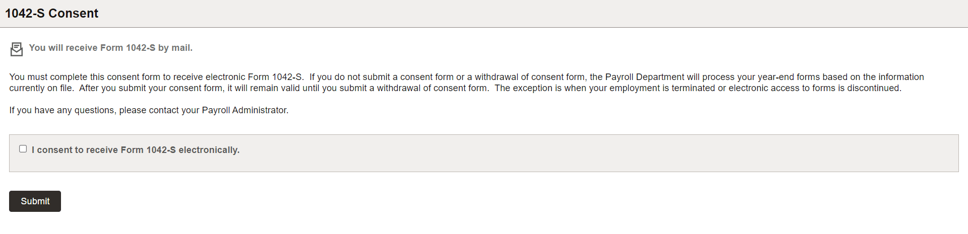

1042-S Consent Page
Use the 1042-S Consent page (PY_1042S_CONS_FL) to submit or withdraw consent to receive electronic Form 1042-S.
Navigation:
Select the 1042-S Consent tile from the Payroll Dashboard or the sample HCM Application Fundamentals: Quick Access – Benefits, Pay & Time Dashboard.
(Desktop) This example illustrates the 1042-S Consent page for employees who are currently receiving paper forms.
1042-S Consent page (currently receiving paper form)

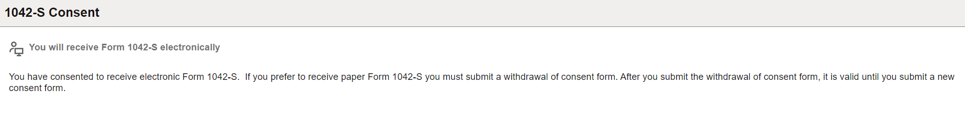

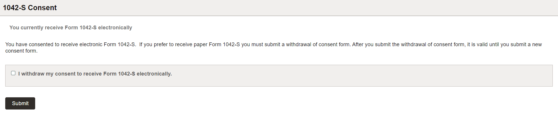

This example illustrates the 1042-S Consent page for employees currently receiving electronic forms.
1042-S Consent page (currently receiving electronic form)
Changing Consent
These page elements appear when an employee accesses the page.
I consent to receive Form 1042-S electronically
This check box appears if the employee currently receives paper forms by mail. The employee selects this box to give consent to receive the forms electronically and stop receiving paper forms.
I withdraw my consent to receive Form 1042-S electronically
This check box appears if the employee currently receives their year-end forms electronically. The employee selects this box to withdraw consent and receive paper forms.
Submit
Select this button to submit the changes. Enter your login information on the Verify Identity Page that appears for authentication purposes.

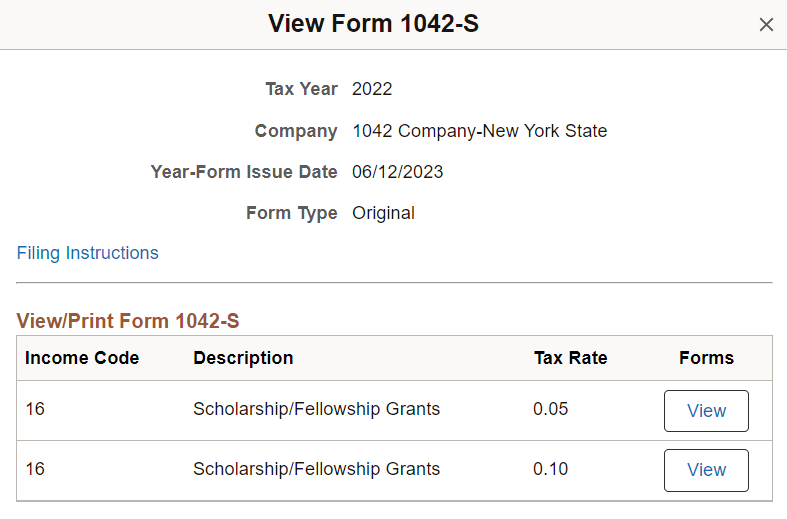

View Form 1042-S Page
Use the View Form 1042-S modal page (PY_SS_YE_NRA_SCF) to select and view 1042-S forms by income code.
Navigation:
Select the View Form button on the View Form 1042-S page.
This example illustrates the View Form 1042-S modal page.

1099-R Consent Page
Use the 1099-R Consent page (PY_1099R_CONS_FL) to submit or withdraw consent to receive electronic Form 1099-R.
Navigation:
Select the 1099-R Consent tile from the Payroll Dashboard or the sample HCM Application Fundamentals: Quick Access – Benefits, Pay & Time Dashboard.
(Desktop) This example illustrates the 1099-R Consent page for employees who are currently receiving paper forms.
1099-R Consent page (currently receiving paper form)
This example illustrates the 1099-R Consent page for employees currently receiving electronic forms.
1099-R Consent page (currently receiving electronic form)
Changing Consent
I consent to receive Form 1099-R electronically
I withdraw my consent to receive Form 1099-R electronically
Submit
Confirmation Information
The 1099-R Consent page displays confirmation information once the employees verify their identity and complete the process of submitting or withdrawing consent.
This example illustrates the 1099-R Consent page after an employee has submitted consent to receive year-end forms in paper form.
1099-R Consent page (confirmation of submission)
Use the View 1099-R Forms page (PY_SS_1099R_FRM_FL) to view 1099-R forms in Employee Self-Service.
Employees can submit or withdraw consent to stop receiving paper 1099-R forms using 1099-R Consent Page.
Navigation:
Select the 1099-R Forms tile from the Payroll Dashboard or the sample HCM Application Fundamentals: Quick Access – Benefits, Pay & Time Dashboard.
(Desktop) This example illustrates the fields and controls on the View 1099-R Forms page,where the employee can view forms electronically after giving the consent.
(Smartphone) This example illustrates the fields and controls on the View 1099-R Forms page, viewed from a smartphone.
(Smartphone) View 1099-R Forms page
Important:
You can also view the screen reader version (HTML) of year-end forms in standard mode, if the tax form options are selected in the Fluid HTML View in Standard Mode section on the PeopleSoft Payroll for North America: Payroll for NA Installation Page,
To view the screen reader version of 1099-R form pages, see View <Tax Form or Slip> Page (Screen Reader Mode) and View <Tax Form Name and Year> Page.
Tax Year
Sort icon
View Details
For employees who have more than one 1099-R, select this button to view tax forms by distribution code on the View Form 1099-R modal page that appears.
Filing Instructions
Use the View Form 1099-R modal page (PY_SS_1099R_SCF) to select and view 1099-R forms by distribution code.
Navigation:
Select the View Form button on the View 1099-R Forms page.
This example illustrates the View Form 1099-R modal page.
This page becomes available if the employee has multiple tax forms of the same issue date.
Filing Instructions
View
