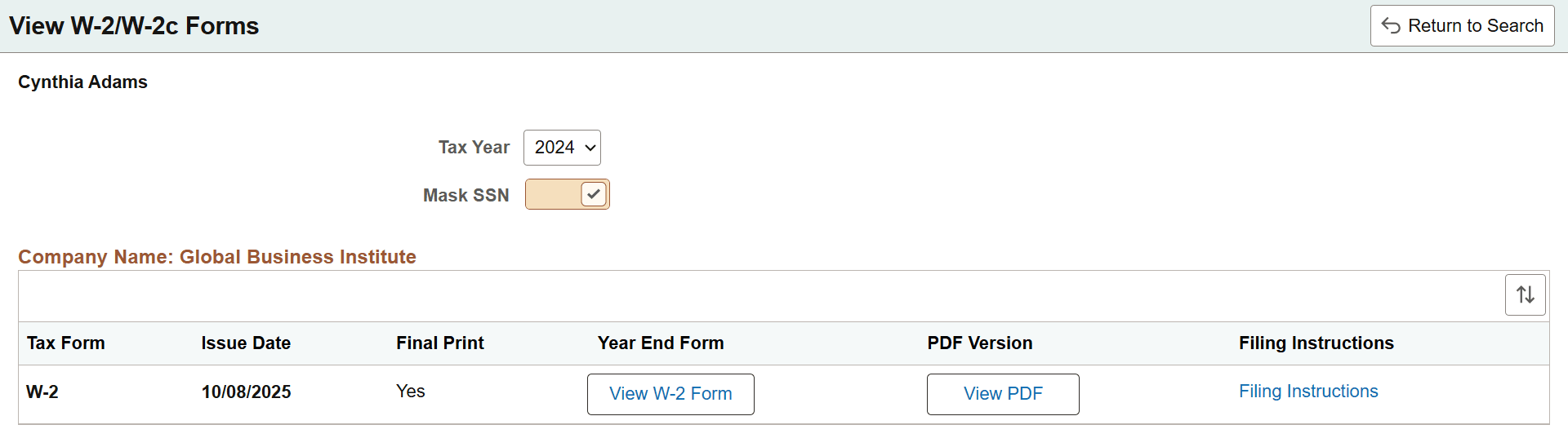

This is an example of the Fluid View W-2/W-2c Forms page for administrators. The page layout is similar across all year-end forms and slips.
Example of the Fluid View W-2/W-2c Forms page for administrators

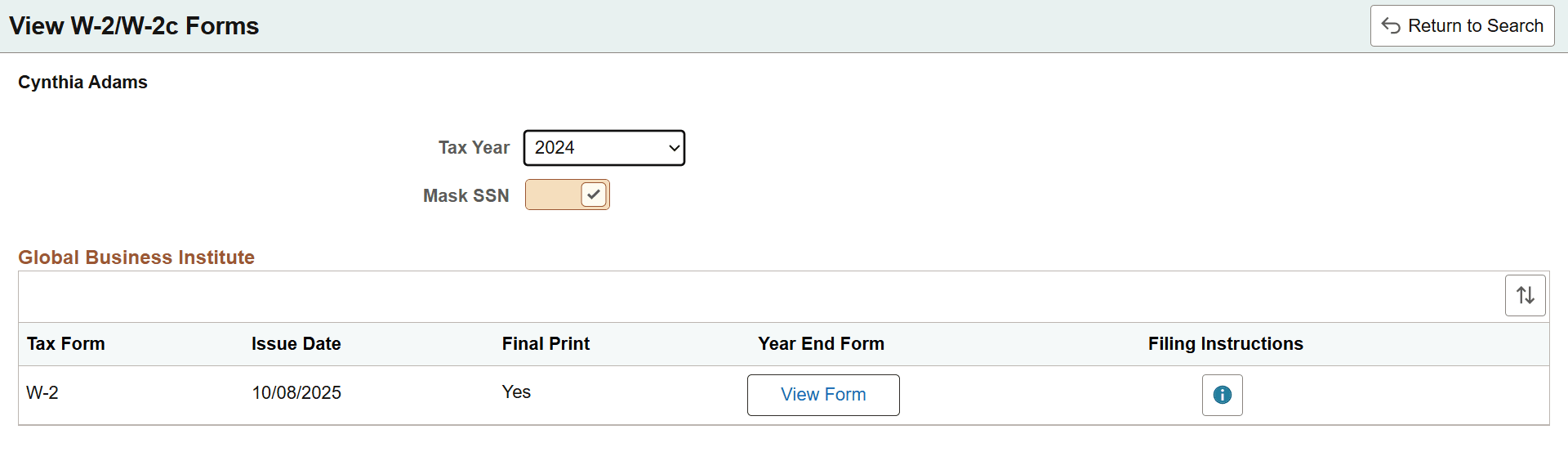

This is an example of the Fluid View W-2/W-2c Forms page for administrators in screen reader mode.
Example of the Fluid View W-2/W-2c Forms page for administrators in screen reader mode)
