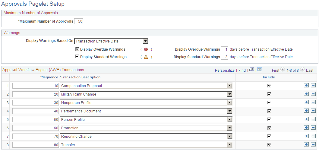

Understanding Approvals
Approval workflow is triggered when a requester submits a transaction, such as a promotion, for approval. The application hands the transaction over to the Approval Framework, which finds the appropriate approval process definition and launches the approval workflow.
The system enables you to generate approvals for the following transaction types from the Manager Dashboard:

Steps to Setting Up the Approvals Pagelet
To ensure that approvals are set up properly for the Manager Dashboard, you will need to perform the following steps to generate approvals:
  1. Set up the Approvals Pagelet Setup page (Set Up HCM, and then Common Definitions, and then Manager Dashboard, and then Approvals Pagelet Setup).
    • Set the maximum number of approvals large enough or that the transaction sequence priority is set such that the approval type you are generating will appear in the pagelet.
    • Select to include an approval transaction under the Approval Workflow Engine (AWE) Transactions group box.
  2. Confirm user profile settings (PeopleTools, and then Security, and then User Profiles, and then User Profiles).
    • Ensure that only one user ID is associated to an employee. When multiple user IDs are linked to an employee, you cannot guarantee to which user ID the approval process will assign approvals. To change the employee associated to a user ID, access the ID page to view or modify the employee ID assignment.
    • Grant page access to the Manager Dashboard by assign the Manager Dashboard role to the user on the Roles page.

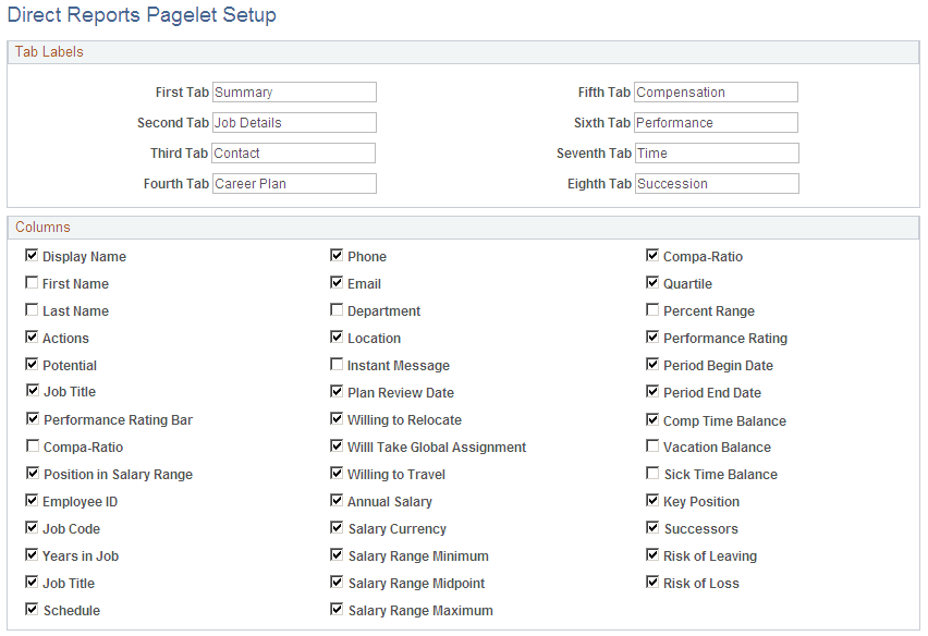

Understanding the Direct Line Reports Pagelet Features
The Direct Line Reports pagelet enables managers to view, in a single location, data from across HCM about each of their employees. To manage this large amount of information, the Direct Reports Pagelet Setup page enables you to group the field columns into eight different tab sections in the pagelet grid. The pagelet also enables managers to initiate self service actions for a specific employee through the use of the Actions menu link.
See Understanding Accessing Direct Line Report Information on the Dashboard Pagelets.
This topic discusses the delivered Direct Line Reports pagelet format.
The Delivered Direct Line Reports Pagelet Format
The Direct Line Reports pagelet contains a grid with eight tabs. The labels on the tabs are configurable and you can hide or show fields (columns). The user has the ability to personalize his or her grid by hiding columns and tabs, reordering columns and tabs, and freezing columns of their choice.
This tables list the delivered eight tab names and fields within those tabs for the Direct Line Reports pagelet:
Unless otherwise noted, the fields come delivered on and available.

Alerts Pagelet Setup Page
Use the Alerts Pagelet Setup page (UX_ALERT_SETUP) to set up the Alerts pagelet for Manager Dashboard.
Define what options are available to users when setting personal preferences as well as identify the alert levels and number of alerts you want to display in the Alerts pagelet.
The Talent Summary - Licenses and Certificate pagelet uses the setup definitions defined for the Expiring Licenses/Certificates row.

Approvals Pagelet Setup Page
Use the Approvals Pagelet Setup page (UX_APPR_PLT_CFG) to set up the Approvals pagelet by identifying transactions you want to support and defining date notification rules.
Navigation:
Set Up HCM, and then Common Definitions, and then Approvals, and then Approvals Pagelet Setup, and then Approvals Pagelet Setup
This example illustrates the fields and controls on the Approvals Pagelet Setup page. You can find definitions for the fields and controls later on this page.
Maximum Number of Approvals
Enter the maximum number of approvals that should appear in the Approvals pagelet on the Manager Dashboard.
Warnings
Field or Control Description
Display Warnings Based On
Chose the method the system should use to notify managers of an upcoming approval that requires their approval. The system uses this information to determine the date to calculate and display the overdue and standard warning icons in the pagelet grid. Valid values are:
  • Approval Receipt Date - reflects the date the manager received the approval in his or her queue.
  • Transaction Effective Date - reflects the date on which a transaction becomes effective or occurs. For example, the date on which a promotion will take place.
The value you select here will determine the label text for the overdue and standard warning days fields.
Oracle PeopleSoft delivers Notification Composer Framework to manage the setup and administration of all notifications in one central location.
Once you have adopted the Notification Composer feature, you must use it to create new notifications and manage your existing notifications.
Notifications delivered with HCM Image 47 or later must use Notification Composer.
For more information about Notification Composer Framework, see Enterprise Components: Understanding Notification Composer.
Display Overdue Warnings Critical alert icon
Select this check box to have the Response overdue icon display in the Warning column on the Pending Approvals pagelet. This works in conjunction with the overdue warning days field on this page. These approvals will appear first for each approval type.
Display Overdue Warnings -__ days after Approval Receipt Date
This field is available when you select Approval Receipt Date in the Display Warnings Based On field and select the Display Overdue Warnings check box.
Enter the number of days after a manager has received an approval request that the system should mark a pending approval as overdue. For example, you enter 7 in this field. An employee submits an approval request on October 20. On October 27, and forward, the system will mark this pending approval with the Response overdue icon.
Note: This number should be larger than the number in the Display Standard Warnings __ days after Approval Receipt Date field, if both warnings are selected to display.
Display Overdue Warnings -__ days before Transaction Effective Date
This field is available when you select Transaction Effective Date in the Display Warnings Based On field and select the Display Overdue Warnings check box.
Enter the number of days before a transaction is to take place to mark a pending approval as overdue and requiring a response. For example, you enter 5 in this field. An employee is eligible for a promotion on October 20. On October 15, and forward, the system will mark this pending approval with the Response overdue icon.
Note: This number should be smaller than the number in the Display Standard Warnings __ days before Transaction Effective Date field, if both warnings are selected to display.
Display Standard Warnings Warning alert icon
Select this check box to have the Response due icon display in the Warning column on the Pending Approvals pagelet. This works in conjunction with the standard warning days field on this page. These approvals will appear after approvals with overdue warnings for each approval type.
Enter the number of days after a manager has received an approval request that the system should mark a pending approval with a standard warning requiring a response. For example, you enter 3 in this field. An employee submits an approval request on October 20. On October 23 the system will mark this pending approval with the Response due icon and it will remain until the warning days number on this page is reached.
Note: This number should be smaller than the number in the Display Overdue Warnings __ days after Approval Receipt Date field, if both warnings are selected to display.
This field is available when you select Transaction Effective Date in the Display Warnings Based On field and select the Display Standard Warnings check box.
Enter the number of days before a transaction is to take place to mark a pending approval with a standard warning requiring a response. For example, you enter 10 in this field. An employee is eligible for a promotion on October 20. On October 10 the system will mark this pending approval with the Response due icon and remain until the warning days number is reached.
Note: This number should be larger than the number in the Display Overdue Warnings __ days before Transaction Effective Date field, if both warnings are selected to display.
Sequence
Enter a priority number for an approval transaction to determine the order in which the approvals should appear in the Pending Approvals pagelet. The lower the number, the earlier the approvals of that type are displayed in the pagelet grid.
Transaction Description
Select the approval transactions you support in your organization. The descriptions come from the Workflow Transactions registry (Set Up HCM, and then Common Definitions, and then Approvals, and then Workflow Transactions). This is also the description that will appear in the pagelet. AWE transactions are listed in the Understanding Approvals topic of the documentation.
See Understanding Approvals.
Include
Select to have the Pending Approvals pagelet display an approval transaction type. An approval transaction will not display on the pagelet if this check box is deselected.
Direct Reports Pagelet Setup Page
Use the Direct Reports Pagelet Setup page (UX_DIR_PLT_CFG) to set up the Direct Reports pagelet by defining how you want to display information to your managers about their direct reports.
Navigation:
Set Up HCM, and then Common Definitions, and then Manager Dashboard, and then Direct Reports Pagelet Setup, and then Direct Reports Pagelet Setup
This example illustrates the fields and controls on the Direct Reports Pagelet Setup page (1 of 2). You can find definitions for the fields and controls later on this page.
This example illustrates the fields and controls on the Direct Reports Pagelet Setup page (2 of 2). You can find definitions for the fields and controls later on this page.
Tab Labels
Use this section to identify the tab names that should appear on the Direct Line Reports pagelet. You can enter up to a total of eight tab names for the grid. If all of the columns under a tab are hidden using this setup page, then the tab label will be hidden as well.
Columns
Select each column (field) name that should be available to the manager when viewing the Direct Line Reports grid. The columns come predefined to map to a tab label, however the user can move or hide these columns on the Direct Line Reports: Personalize page.
Deselect a check box to hide the column from the user on the Direct Line Reports pagelet and on the Personalize page.
The following fields have special considerations:
