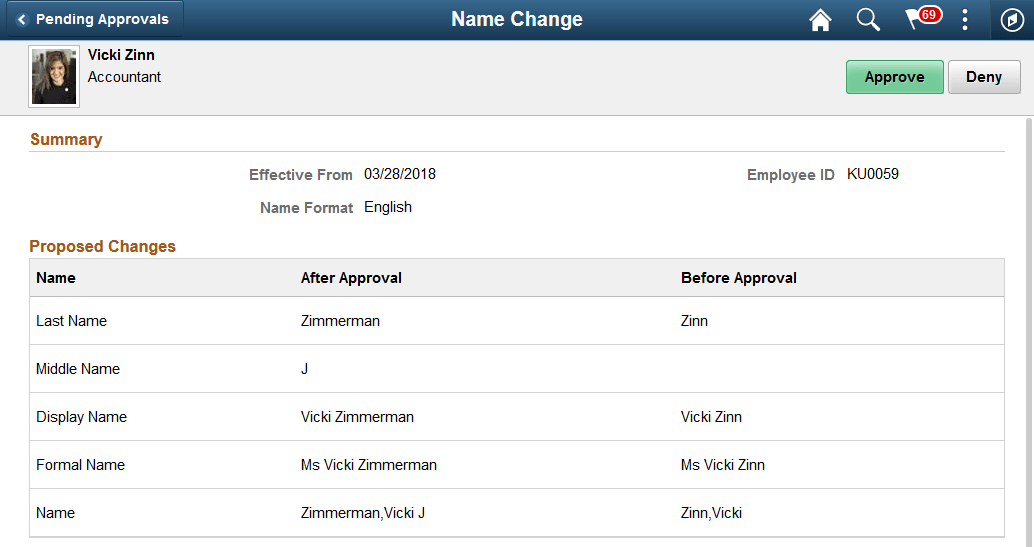

This example illustrates the fields and controls on the Pending Approvals - <Transaction Name> page (1 of 2). This example shows a Name Change transaction.
Pending Approvals - <Transaction Name> page (1 of 2) showing a Name Change transaction
This example illustrates the fields and controls on the Pending Approvals - <Transaction Name> page (2 of 2). This example shows a Name Change transaction.
Pending Approvals - <Transaction Name> page (2 of 2) showing a Name Change transaction

Summary and Details Sections
These sections show a quick summary of who is being impacted by the transaction request and when. The section and field names on the page will vary based upon the transaction type. Some sections and fields may not apply to certain transactions. The preceding screen shot displays an example of a transaction that shows a Summary section.
Field or Control Description
Date-related fields
Displays the effective date for the transaction (not the date that the transaction was submitted).
The field name description will vary based upon the transaction type.
Employee ID
Displays the ID of the employee being affected by this transaction request.
Name Format
For a Name Change request, the page will display the name format used for the employee’s name. For example, English or Japanese.
Requester
Displays the name of the manager who submitted the transaction for approval.
Reason
If the transaction specified a reason to use in the new job data row, that reason appears here.
Proposed Changes Section
This section is not shown for the delivered Reporting Change, Retire Employee, and Terminate Employee transactions.
These sections show the proposed changes to the employee’s record. The grid lists the specific data changes that are being requested. The fields in this section vary depending on the transaction.
Job Information, Type, Name, or Description
Displays the name of the field to be updated.
The Type column applies to the address type that is being updated, such as Home or Mailing.
The Name column lists the different types of names for an employee, such as Last Name, First Name, or Display Name.
After Approval
Displays the proposed new value for the specified field.
Before Approval
Displays the current value of the specified field so that you can compare the old data to the proposed change.
