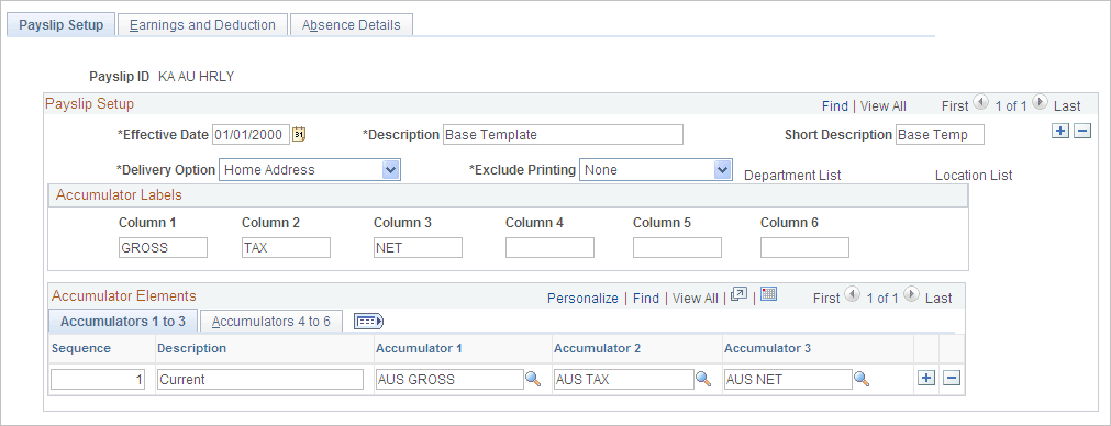

Payslip Setup Page
Use the Payslip Setup page (GPAU_PSLP) to set up delivery and print exclusion options, column headings (labels) and column content (rows of accumulators).
Navigation:
Set Up HCM, and then Product Related, and then Global Payroll & Absence Mgmt, and then Payslips, and then Templates AUS
This example illustrates the fields and controls on the Payslip Setup page. You can find definitions for the fields and controls later on this page.
Payslip Setup page
Field or Control Description
Payslip ID
Displays the payslip ID. A template can be attached to multiple pay groups.
Note: Only one template can be attached to a particular pay group at a time.
Delivery Option
Select an address to receive printed payslips. It can be an internal address of Department or Location, or an external address of Home Address or Mail Address as recorded on the payee's personal data record.
You can override the selection made here on the Payee Payslip Overrides page. Because this selection is effective-dated, you can override the delivery option for a period of time, if necessary.
Exclude Printing
Select either Department or Location to exclude departments or locations from the payslip print run. The corresponding link becomes active, so you can select departments or locations.
You can override the exclusion on the Print Payslips page before you run the print program.
Note: If you enter a particular pay entity for the print option on the Print Payslips page and you have excluded a location within the pay entity, the payslips are not printed.
Accumulator Labels
Column 1 to Column 6
Enter the labels that appear on the printed payslips as the column headings for the accumulators. These column headings appear in the payslip region under the heading Pay Summary.
Accumulator Elements: Accumulators 1 to 3 Tab
Sequence
Enter a sequence number to set the order in which the accumulators appear. The accumulators appear in ascending order with the lowest number first.
Description
Enter a description of each accumulator row.
Accumulator 1 to Accumulator 3
Select the accumulators that appear in the corresponding column.
For example, suppose that you enter Current and YTD as the descriptions for accumulators 1 and 2. To also display quarter-to-date accumulated amounts, create a new row, enter the description QTD, and then select the accumulators that correlate to the columns headings.
Accumulator Elements: Accumulators 4 to 6 Tab
Accumulator 4 to Accumulator 6
Set up accumulators 4 to 6. There are no Sequence and Description fields because the same sequence number and description apply to all six accumulators in the row.
This diagram shows how column numbers, sequences, and accumulator numbers appear on the printed payslip.
Columns and rows in the Pay Summary region of the payslip

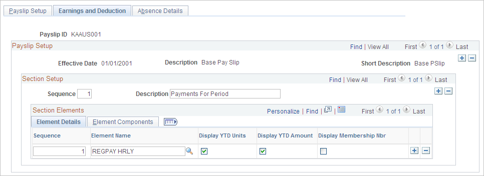

Earnings and Deduction Page
Use the Earnings and Deduction page (GPAU_PSLP1) to create sections of earnings and deductions, select description options, and set the element components that the payslip displays.
Navigation:
Set Up HCM, and then Product Related, and then Global Payroll & Absence Mgmt, and then Payslips, and then Templates AUS, and then Earnings and Deductions
This example illustrates the fields and controls on the Earnings and Deduction page. You can find definitions for the fields and controls later on this page.
Earnings and Deductions Section Setup
Description
Descriptions appear as section headings under the Payment Details heading on the payslip.
Element Details Tab
Display YTD Units and Display YTD Amount
Select these check boxes to have the YTD units and amounts for each element appear in the Payment Details region under the heading Year to Date Values.
Display Membership #
Select to display the recipient's membership ID in the Description region.
Element Components Tab
Description Type
Select the type of description to appear for each earnings or deduction row in the Payment Details region of the payslip. Select from the following values:
Custom: A text box appears for you to enter a description.
Description: The element's description appears as entered on the element's name page in its component.
Element Name: The element's name appears from its name page in its component. It also appears on the Elements Details tab.
Recipient Name: The name of the recipient appears. Select this option to display the name of the superannuation fund.
Print Unit, Base, Rate, and Percentage
Select the components of the element's calculation rule that you want to display for each earning or deduction in the sections.
You can select only the components in the element's calculation rule. For example, for an earnings with calculation rule Unit × Rate, only the Unit and Rate check boxes are available.
Note: Amounts are always displayed.
