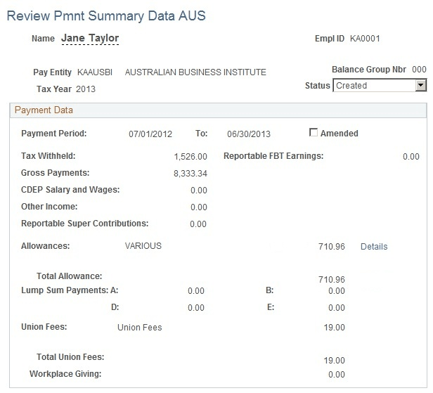

Review Pmnt Summary Data AUS Page
Use the Review Pmnt Summary Data AUS page (GPAU_EE_PSM) to view the results of running the Create Payroll Summary process.
Navigation:
Global Payroll & Absence Mgmt, and then Year-End Processing, and then Review Pmnt Summary Data AUS, and then Review Pmnt Summary Data AUS
This example illustrates the fields and controls on the Review Pmnt Summary Data AUS page. You can find definitions for the fields and controls later on this page.
After running the Create Payment Summary Data process for the tax year and payee population that you select, you can view the results. The EOY VR CATEGORY Supporting Element Override value that you set for each earning and deduction dictates in which total their values are included. The display is by employee name and ID, pay entity, balance group ID, and tax year.
Field or Control Description
Payment Period
For normal end-of-tax-year processing, this shows 01/07/YY - 1 to 30/06/YY. For terminated employees, it shows 01/07/YY - 1 to termination date. For hired employees, it shows hire date to 30/06/YY.
Tax Withheld
Total of all category T deductions.
Gross Payments
Total of all category G earnings.
CDEP Salary and Wages
Total of all category C earnings.
Other Income
Total of all category O earnings.
Reportable Super Contributions
Displays the Reportable Employer Super Contributions (RESC).
The system provides two override values for the EOY VR CATEGORY:
  • PT captures only pre-tax deductions
  • RS captures the salary packaged superannuation components that must be reported under RESC, but should not further reduce from gross.
Allowances
Total of all category A earnings.
If an employee has one or two allowances, then it is listed here. If there are more than two allowances, it will be listed as VARIOUS and the total of the allowances under this category will be displayed. A Details link is also displayed, which opens a window listing all the allowances.
Total Allowances
Total of all allowances.
Lump Sum Payments (A, B, D and E)
All earnings of category LA, LB, LD, and LE, respectively.
Type
Displays the type of Lump Sum A payment, based on the Action Reason of the termination specified in the Job Data pages. This field does not display a value when the employee has not received any Lump Sum A payments.
The system displays the value Rwhen the termination Action Reason is Elimination of Position (redundancy), Partial/Total Disability (invalidity), or Early Retirement. displays the value T for all other reasons.
Union Fees
All deductions of category U.
If an employee has one or two types of deductions under Union Fees and Professional Association Fees, then it is listed here. If there are more than two deductions, it will be listed as VARIOUS and the total of the deductions under this category will be displayed. A Details link is also displayed, which opens a window listing all the deductions under Union Fees.
Workplace Giving
Total of all workplace giving.
If the employer had made payments to more than one deductible gift recipient on behalf of the employee, then it will be listed as VARIOUS and the sum of the payments will be displayed. A Details link is also displayed, which opens a window listing all the payments made under Workplace Giving.
Lump Sum C earnings don't appear, because Lump Sum C ETPs are extracted and reported separately.
