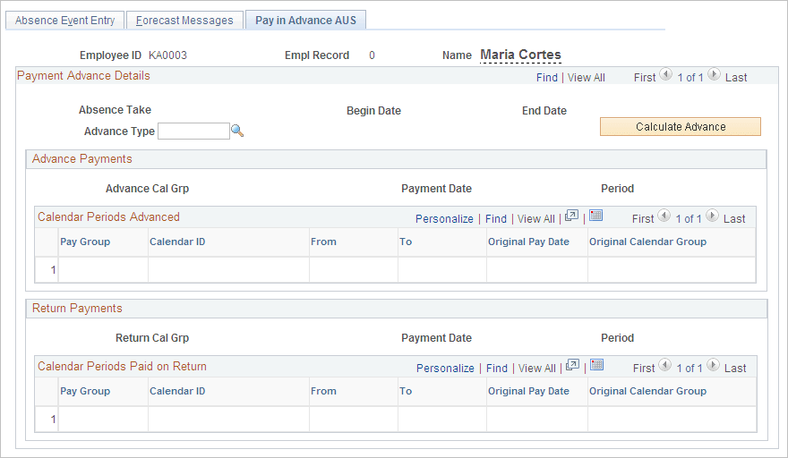

Pay In Advance AUS Page
Use the Pay In Advance AUS page (GPAU_ABS_EVENT_ADV) to enter an advance type and view the details of advance payments.
Navigation:
Global Payroll & Absence Mgmt, and then Payee Data, and then Maintain Absences, and then Absence Event AUS, and then Pay in Advance AUS
This example illustrates the fields and controls on the Pay in Advance AUS page. You can find definitions for the fields and controls later on this page.
This page is an addition to the Absence Event component. The page displays details of the advance payment according to the advance type that you enter.
Enter the advance type for the absence event. When you click the Calculate Advance button, the system displays information about how and when the advance payment is made based on the rules for the advance type.
The system displays the information in two group boxes, Advance Payments and Return Payments.
Advance Payments
Field or Control Description
Advance Cal Grp (advance calendar group)
This is the calendar group for the advance payment.
Payment Date
This is the payment date of the regular pay calendar in the calendar group.
Period
These are the From and To dates of the regular pay calendar in the calendar group.
Calendar Periods Advanced
Pay Group
This is the pay group in which the payment would be made if it were not advanced.
Calendar ID
This is the calendar in which the payment would be made if it were not advanced
From and To
These are the From and To dates of the period being advanced.
Orig Pay Dt (original payment date)
This is the payment date when the payment would be made if it were not advanced.
Orig Cal Grp (original calendar group)
This is the calendar group in which the payment would be made if not it were not advanced.
Return Payments
Return Cal Grp (return calendar group)
This is the calendar group in which any unadvanced payment is made.
Note: None of the Return Payments fields are populated if the advance type advances all pay from the period in which the leave occurs, or if the advance type advances some of the pay and pays the balance in its normal period.
Payment Date
Period
Calendar Periods Paid on Return
Pay Group
This is the pay group in which the payment would have been made if not paid on return.
Calendar ID
This is the calendar in which the payment would have been made if not paid on return.
From and To
These are the From and To dates of the period being paid on return.
This is the payment date for the calendar in which the payment would have been made if not paid on return.
This is the calendar group in which the payment would have been made if not paid on return.
If you select the Allow Override check box when you define the advance type, you can override the advance or return calendar group the system selected for this advance. You cannot, however, change any calendars or calendar data for a system-selected or overridden calendar group.
