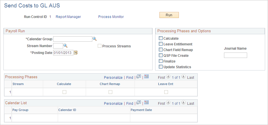

Send Costs to GL AUS Page
Use the Send Costs to GL AUS page (GPAU_GL_PREPARE) to initiate the processes for calculation of GL data, leave entitlement, QSP flat file creation, finalization of the GLI, and statistical data updating.
Navigation:
Global Payroll & Absence Mgmt, and then Time and Labor / GL Costs, and then Send Costs to GL AUS, and then Send Costs to GL AUS
This example illustrates the fields and controls on the Send Costs to GL AUS page. You can find definitions for the fields and controls later on this page.
The differences between this page and the page that you access by selecting Compensate Employees, and then Manage Payroll Process, and then Process are the three additional processing phases and options: Chart Field Remap, Leave Entitlement, and QSP File Create.
