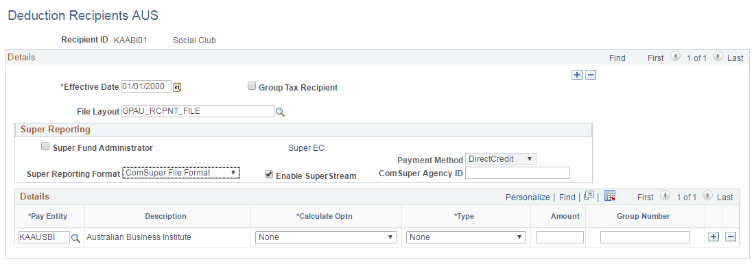

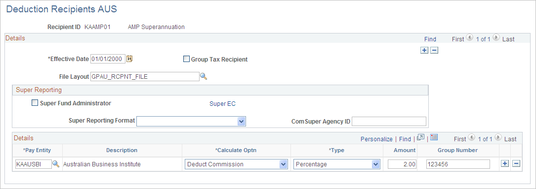

Deduction Recipients AUS Page
Use the Deduction Recipients AUS page (GPAU_RECIPIENT_EXT) to enter Australia-specific additional information about recipients that are set up in the core application for Global Payroll.
Navigation:
Set Up HCM, and then Product Related, and then Global Payroll & Absence Mgmt, and then Banking, and then Deduction Recipients AUS
This example illustrates the fields and controls on the Deduction Recipients AUS page. You can find definitions for the fields and controls later on this page.
Deduction Recipient AUS page
Field or Control Description
Group Tax Recipient
Select if the recipient is the ATO, the recipient of group tax.
File Layout
Select the appropriate file layout from those that you have created in Application Designer for report files that you submit to recipients. When you run the Recipient File - Electronic report, the Application Engine process uses the file layout that you enter here.
Note: The GPAU_RCPFILE Application Engine process uses only the GPAU_RCPNT FILE recipient schedule file. You can make minor changes to that file—for example, field order. However, if you make major file layout changes, you must create additional Application Engine programs to process them.
The lodgment reference for net pay is the employee ID plus payment date. For recipient payments, it is the group number plus payment date. For group tax payments, it is the EFT code plus payment date.
Super Reporting
Super Fund Administrator
Select to designate the recipient as a Super Fund administrator.
Note: This field is not visible when ‘SuperStream File Format’ is selected as the Super Reporting Format.
Super EC
Click to access the SuperEC Detail page.
Select a reporting format. Valid values are Agest, ComSuper File Format, SuperEC file Format and SuperStream File Format.
When you select SuperStream File Format for the respective Super Fund scheme. Deduction Recipients AUS page refreshes to display Payment Method field.
If ComSuper File Format is selected, a new check box with Enable SuperStream and the chosen Payment Method Direct Credit become visible. The Enable SuperStream flag is set to True by default. This flag enables the recipient for SuperStream report. If the flag is set to False, the deduction recipient cannot be processed for SuperStream report and will be available only for PIF format file generation.
Payment Method
The payment method being used to transfer the superannuation contributions to the Super Fund. Select the payment method from the following options:
BPAY: Select “BPAY” if the Deduction Recipient (Super Fund / Scheme) is paid using the BPAY facility. If payment is made using BPAY, the employer must include the Biller Code and the Customer Reference Number.
DirectCredit: Select DirectCredit if the Deduction Recipient (Super Fund / Scheme) is paid using the DirectCredit facility.
DirectDebit: Select DirectCredit if the Deduction Recipient (Super Fund / Scheme) is paid using the DirectDebit facility.
Note: This field appears only when ‘SuperStream File Format’ is selected as the Super Reporting Format.
ComSuper Agency ID
Enter the ComSuper agency ID.
Details
Pay Entity
Enter the pay entity that receives this commission. If the commission is deducted from the payment due to the recipient, the debit to the pay entity's source bank account is reduced by the commission amount.
Calculate Optn (calculate option)
Select from the following values:
Ded Comm (deduct commission): The system deducts the commission amount from the payment due to the recipient.
Rpt Only (report only): The system reports the commission amount in the EFT file but does not deduct it from the payment.
Type
Select Flat Amt (flat amount) or Percentage.
Amount
Enter the flat amount or percentage to be calculated.
Group Number
Enter the unique identifier that the recipient has supplied for the pay entity. For payment to recipients excluding the group tax recipient and payee level recipients, the group number is part of the unique lodgment reference that is part of each recipient EFT file.

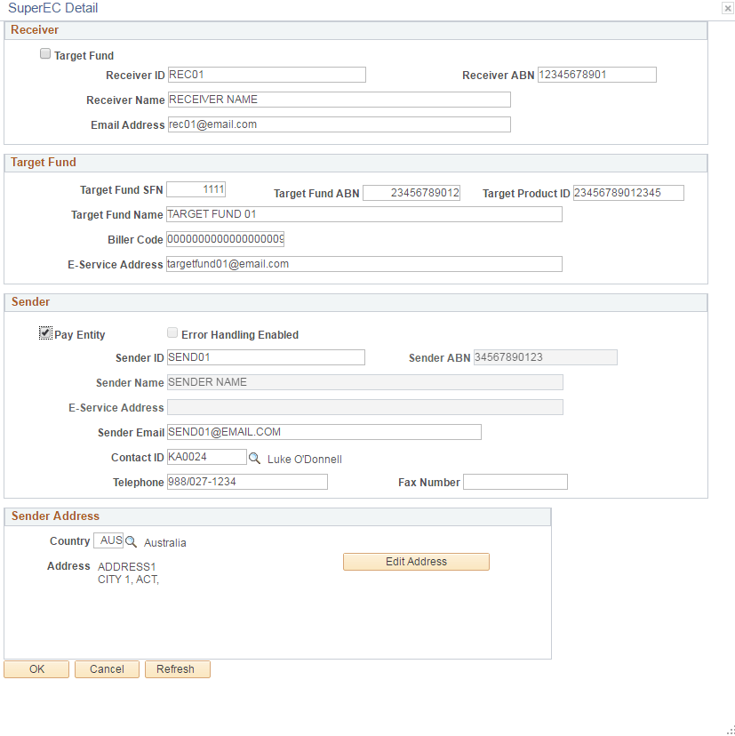

SuperEC Detail Page
Use the Super EC link available in Deduction Recipients AUS page to navigate to the SuperEC Detail secondary page to setup Sender/Receiver/Target Fund information for the Deduction Recipient
SuperEC Detail page
SuperEC Detail page
Receiver
Target Fund
Check the Target Fund check box if the target fund and reciver are same.
If selected, the Target Fund Name and Target Fund ABN will be used in place of the Receiver Name and Receiver ABN fields in the report.
Note: This field appears only when ‘SuperStream File Format or ComSuper File Format’ is selected as the Super Reporting Format.
Receiver ID
Enter the ID of the Message Receiver.
Receiver ABN
Enter the Australian Business Number (ABN) of the receiver.
Receiver Name
Enter the Organization Name of the Message Receiver.
Email Address
Enter the email address of the Message Receiver.
Target Fund
This section contains details of the Super Fund Organization and the Super Fund Scheme Product ID.
Target Fund ABN
Enter the Australian Business Number (ABN) of the Super Fund Organization.
Target Product ID
Enter the Super Fund USI.
Target Fund Name
Enter the fund name.
Biller Code
Enter the Biller Code of the Super Fund.
Note: This field is applicable only for BPAY payment transactions.
E-Service Address
Enter the ‘E-Service Address’ field to specify the Electronic Service Address of the Super Fund scheme.
Sender
Pay Entity
Check the Pay Entity check box to indicate if the Pay Entity is the sender of the file. If checked, the AE program GPAU_COM_RPT will fetch and load the Pay Entity’s details in places where ‘Sender’ information is to be reported.
Error Handling Enabled
Select the check box if the ‘Sender’ of the file is capable of decoding the member registration/contribution error responses generated by the target system.
Sender ID
Enter the ID of the sender.
Sender ABN
Enter the Sender ABN
Sender Name
Enter the name of the sender.
Sender Email
Enter the email address of the sender.
Contact ID
Select the ID of the contact person.
Note: For this purpose the user should have already added a person (Add a Person) within the Workforce Administration > Personal Information section identifying the person as POI (Person of Interest).
You can use the Edit Address option to edit the saved address of the sender.
