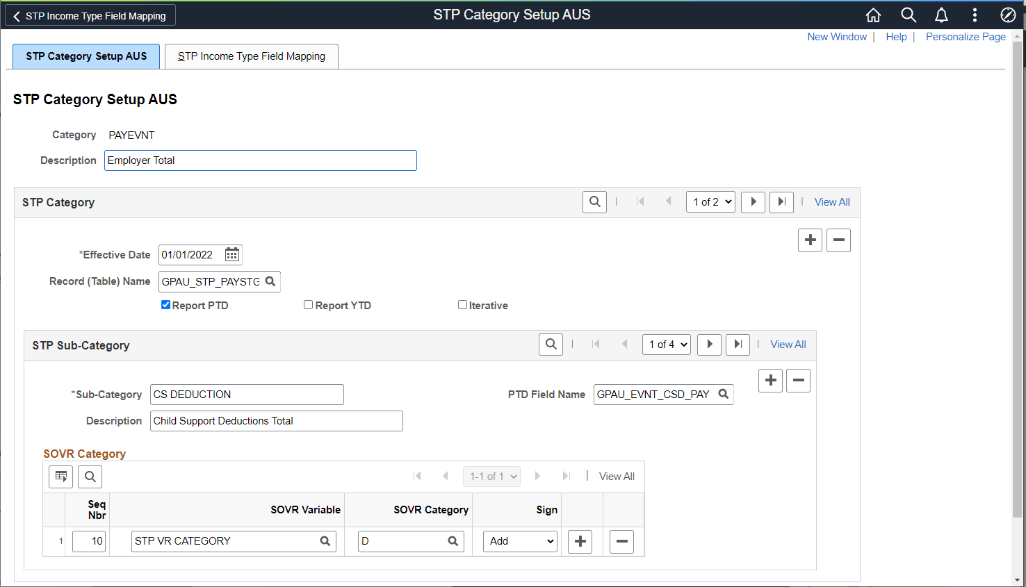

STP Category Setup AUS Page
Use the STP Category Setup AUS page (GPAU_STP_CAT) to map between XML Tuple with Category and XML Fact with Sub Category. SOVR Variable determines, the Variable that assigned in the Earnings to determine the SOVR category and the Supplementary Element Override. The setup uses the EOY VR CATEGORY (existing one which is used for generating the Payment Summaries), and STP VR CATEGORY (this is a new variable created to map against respective earnings/deductions) required for STP file generation and reporting.
Navigation:
Set Up HCM, and then Product Related, and then Global Payroll & Absence Mgmt, and then Reports, and then STP Category Setup AUS
The STP Category setup AUS page sets the mapping between XML Tuple with Category and XML Fact with Subcategory.
This example illustrates the fields and controls on the STP Category Setup AUS page.
Field or Control Description
Effective Date
Mapping should be modified to the actual migration date along with the effective date of STP Category setup. Income Type field mapping is mandatory with the latest effective date in the STP Category setup for addition of new income types like CHP and SWP.
Record (Table) Name
Select the Staging Record where the data to be stored for reporting while running STP Preparation Process. This field is to define the Staging table record where the data to be stored for final reporting.
Report PTD
Select the check box if PTDs are required under the specified Category and Sub-Category. This enables PTD field name where we can define the Field of the staging table defined under Record Name. The PTD value calculated update in the respective field defined.
Report YTD
Select the check box if YTDs are required under the specified Category and Sub-Category. This enables YTD field name where we can define the Field of the staging table defined under Record Name. The YTD value calculated update in the respective field defined.
SOVR Variable
Select the variable that is assigned in the Earnings. This determine the SOVR category and the Supplementary Element Override. The SOVR Variable are either EOY VR Category or STP VR Category.
SOVR Category
Select the respective EOY VR or STP VR Category corresponding to those earnings and deductions that is required for each facts of that Tuple. This determines the actual SOVR categories that contribute to the Sub-Category, which is the Final amount to display in the report.
This setup is pre-seeded as system data and employer can make necessary changes to set up additional categories as part of STP Reporting.

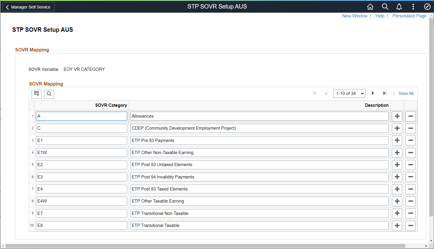

STP SOVR Setup
PeopleSoft delivers pre-seeded STP SOVR values that will be displayed in the STP Category Setup AUS page. However, if you want to create a new SOVR value, then you can make use of the GPAU_STP_SOVRCAT component.
Use SOVR Mapping (GPAU_STP_SOVRCAT) page to add SOVR category.

This example illustrates fields and controls of STP SOVR Setup AUS Page.
Use the “+” button to add a new SOVR category.
Map the STP VR CATEGORY “FA” against the respective earning elements with an effective date under the tab Supporting Element Override. Users need to ensure the mapping of the respective SOVR to the correct Earnings and Deductions to report under the correct categories of STP.
Ensure the mapping of the respective SOVR to the correct Earnings and Deductions to report under the correct categories of STP as per ATO definitions.
Employee’s year to date payroll results is reported in Single Touch Payroll Pay Event file. Year to date accumulators is contributed by the respective earnings and deductions that are processed in payroll. Each earnings and deductions are assigned with SOVR category in the supporting element override tab as shown above with the help of a variable EOY VR CATEGORY.
These SOVR categories are used to retrieve the list of accumulators for Payment Summary (PSM) reporting in Global Payroll Australia and the same approach is used for STP reporting. Some of earnings and deductions which do not have the SOVR category will be assigned a new category with an element type as variable STP VR CATEGORY or STP VR P2 CATEGORY which are specific to STP instead of existing variable EOY VR CATEGORY so that there will not be any impact on existing PSM reporting and also to make sure if the users are using the feature for any other kind of reconciliation.

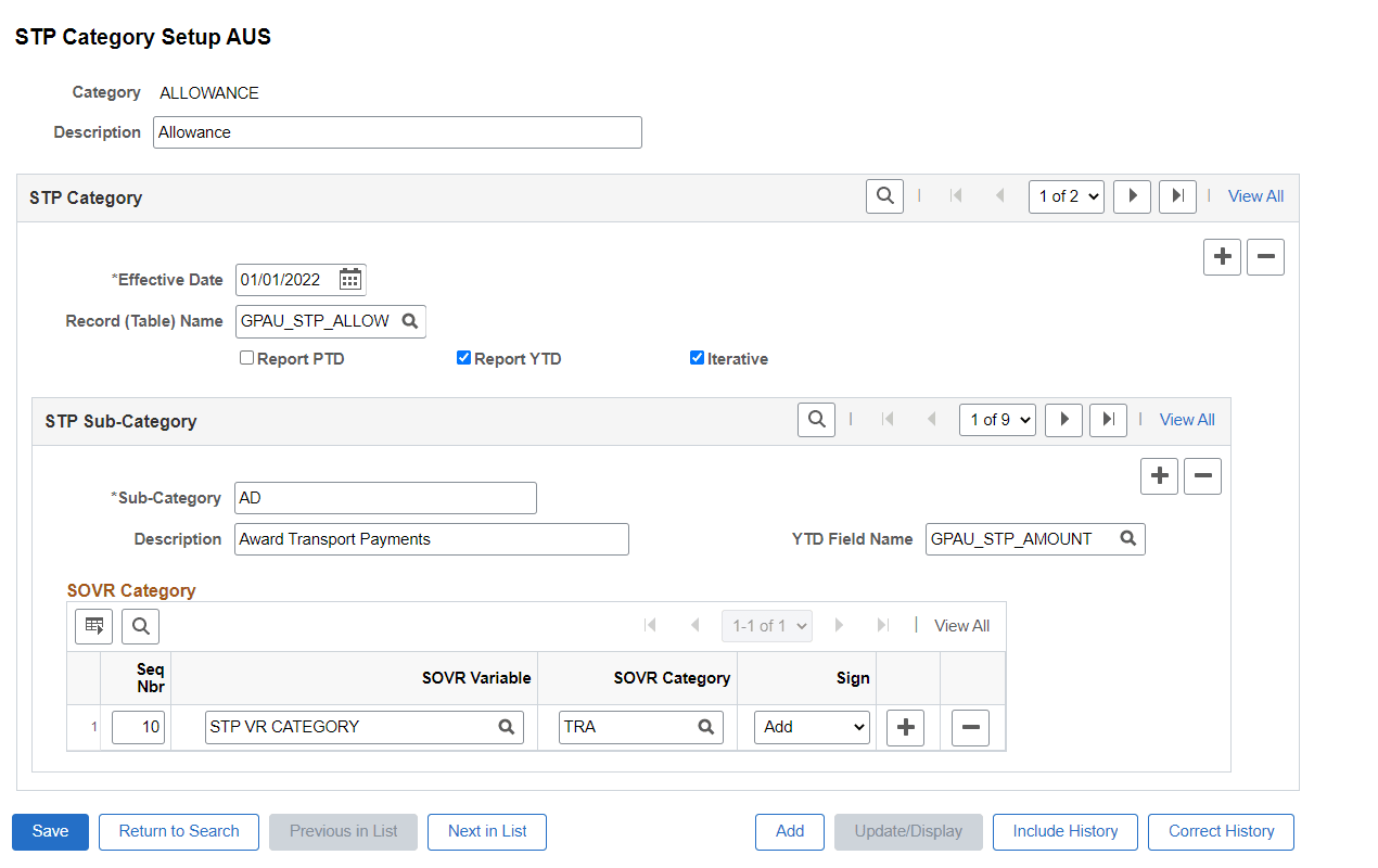

New SOVR Category under the variable STP VR CATEGORY is added in order to classify allowance type as others with description “First Aid Allowance” under STP Category Setup, under Category “Allowance”.
The example illustrates STP Category Setup AUS with Allowance category.
This example illustrates the STP Category Setup AUS page
This example illustrates the XML mapping with the respective fields in the STP Category Setup AUS page.

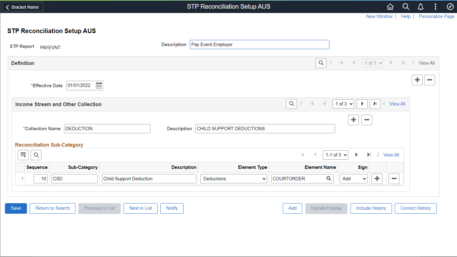

STP Reconciliation Setup AUS
STP Reconciliation Setup AUS is configured with the Earnings/Deductions contributing to the sub-category and the various collections reported in the STP file.
Employee can map any customized Earnings/Deductions used instead of the PeopleSoft delivered Earnings/Deductions that are being reported in STP. This setup is delivered as a system data as part of the Reconciliation solution.

This example illustrates the fields and controls of STP Reconciliation Setup AUS page.
Effective Date
The date from which the setup is valid.
Collection Name
The name of the Tuple that are being used for reporting.
Sequence
The Sequence Order of the Field on the report.
Sub-Category
The name of the facts that are being used for reporting under the respective Tuple.
Description
The description of the sub-category.
Sign
The values are:
  • Add - Specify whether the corresponding field adds to the collection total.
  • Subtract - Specify whether the corresponding field deducts from the collection total.
Element Type
Displays the Element Type. Values can be:
  • Earning
  • Deduction
