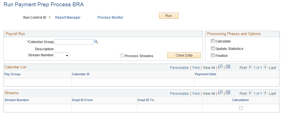

Run Payment Prep Process BRA Page
Use the Run Payment Prep Process BRA (run payment preparation process BRA) page (GPBR_RC_PAYMENT) to launch the PS Job that populates the GP_PAYMENT and GPBR_PAYMENT records.
Navigation:
Global Payroll & Absence Mgmt, and then Payment Processing, and then Prepare Payment Process BRA, and then Run Payment Prep Process BRA
This example illustrates the fields and controls on the Run Payment Prep Process BRA page.
The fields on the Run Payment Prep Process BRA page in Global Payroll for Brazil are the same as on the Run Payment Prep Process page in the core application, except that an additional field (Clear Data) appears on the Run Payment Prep Process BRA page. For more information about the Run Payment Prep Process page, refer to the PeopleSoft Global Payroll: Run Payment Prep Process Page topic.
Field or Control Description
Clear Data
Click when you want to recalculate the Brazilian banking process. If you click this button, you can clear the GPBR PAYMENT output table and fill it again if the calculation changes.
Finalize
Select only if you are absolutely sure that this process is generating the information for all the eligible payees. Selecting this check box turns on an indicator field in the Calendar Group record.
