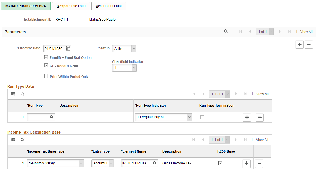

MANAD Parameters BRA Page
Use the MANAD Parameters BRA page (GPBR_MANAD_PARMS) to map Global Payroll data to information to be displayed on the MANAD report.
Navigation:
Set Up HCM, and then Product Related, and then Global Payroll & Absence Mgmt, and then Reports, and then MANAD Parameters BRA, and then MANAD Parameters BRA
This example illustrates the fields and controls on the MANAD Parameters BRA page (1 of 2).
This example illustrates the fields and controls on the MANAD Parameters BRA page (2 of 2).
Field or Control Description
EmplID + Empl Rcd Option (employee ID + employee record option)
Select to display the employee’s ID and employee record in the MANAD report.
GL - Record K200
Select to include a chartfield value in the MANAD report.
Chartfield Indicator
Select the indicator number of the chartfield value to be included in the MANAD report.
Print Within Period Only
Select to the print data that falls within the period specified on the run control page.
See Also MANAD File Process BRA Page
Run Type Data
Use this section to map payroll run types in the Global Payroll system to run types for use in the MANAD report.
For example, in a payroll run for December, there can be vacation earnings, 13th salary earnings, terminations earnings as well as deductions in addition to the regular payroll amount. When all these amounts are paid through their specific run types, the amounts need to be recorded in the MANAD report under the mapped run types that are predefined for MANAD reporting.
Income Tax Calculation Base
Use this section to map the income tax base types (predefined for MANAD reporting) to accumulator elements in the Global Payroll system. This information is used to classify each accumulator in Record K300 according to their participation in income tax calculation bases.
Suppose that both SALARIO and PREMIO are members of the IR REN BRUTA accumulator and this accumulator is mapped to the 1 - Monthly Salary income tax base type in this section. In the MANAD report, the Record K300 of SALARIO and PREMIO earnings for all employees will appear with type 1 in the Income Tax Classification field.

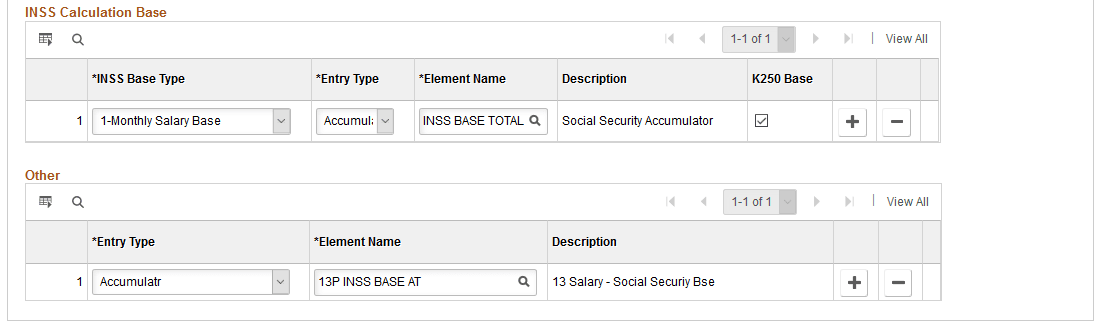

INSS Calculation Base
Use this section to map social welfare classifications (predefined for MANAD reporting) to elements in the Global Payroll system. This information is used to classify each accumulator, earnings and deductions element in Record K300 according to their participation in social security calculations.
INSS Base Type
Select an INSS base type to map to a Global Payroll element.
If you select 1-Monthly Salary Base or 2-13th Salary Base, the system limits the entry type to Accumulator only.
The rest of the base types can be mapped to accumulator, deduction, and earnings elements.
K250 Base
Select for the corresponding entry to be included in Record K250 for MANAD.

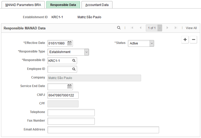

Responsible Data Page
Use the Responsible Data page (GPBR_MANAD_RESP) to enter data of the company or person responsible for issuing the MANAD report.
Navigation:
Set Up HCM, and then Product Related, and then Global Payroll & Absence Mgmt, and then Reports, and then MANAD Parameters BRA, and then Responsible Data
This example illustrates the fields and controls on the Responsible Data page.
Use this page to enter data for the entity (company or establishment) or person (employee or non-employee) who is responsible for issuing the MANAD report (Record 0100).

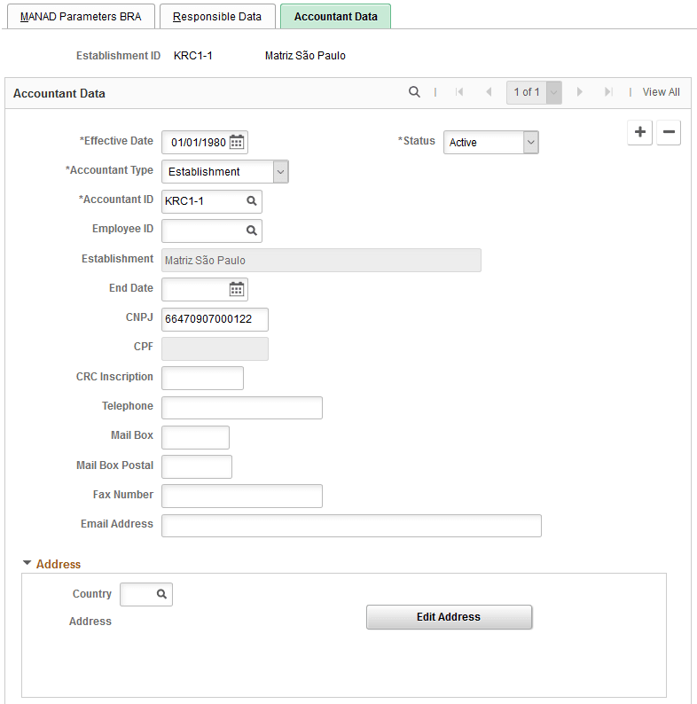

Accountant Data Page
Use the Accountant Data page (GPBR_MANAD_ACCT) to enter data of the accountant responsible for issuing the MANAD report
Navigation:
Set Up HCM, and then Product Related, and then Global Payroll & Absence Mgmt, and then Reports, and then MANAD Parameters BRA, and then Accountant Data
This example illustrates the fields and controls on the Accountant Data page.
Use this page to enter data for the accountant (entity or person) who is responsible for issuing the MANAD report.
If the end date of the accounting service is not specified on this page, the system derives the end date by subtracting one day from the begin date of the next responsible entity.
