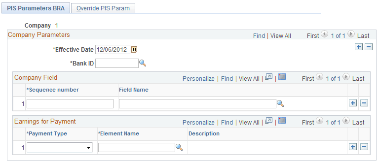

PIS Parameters BRA Page
Use the PIS Parameters BRA page (GPBR_PARM_PIS) to define a company's PIS parameters.
Navigation:
Set Up HCM, and then Product Related, and then Global Payroll & Absence Mgmt, and then Social Security/Insurance, and then PIS Parameters BRA, and then PIS Parameters BRA
This example illustrates the fields and controls on the PIS Parameters BRA page.
Field or Control Description
Bank ID
Select the Bank ID for CAIXA.
Company Field
Use these fields to specify additional data that you want to include in the Release of Resources file that is returned to CAIXA. You can select any field from the PS_JOB record, such as EMPLID (employee ID) or DEPTID (department ID). When you update the Release of Resources file, the system will include, for each listed employee, the first ten positions from the combined fields. This data can help you research and verify information in the file.
Earnings for Payment
Use these fields to select the earning element that is used to process each type of PIS payment.
Payment Type
Select the payment type, Income (Rendimento) or Allowance (Abono Salarial). Enter only one row for each payment type.

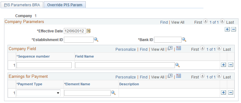

Override PIS Param Page
Use the Override PIS Param (override PIS parameters) page (GPBR_PARM_PIS_E) to override a company's PIS parameters for a specific establishment.
Navigation:
Set Up HCM, and then Product Related, and then Global Payroll & Absence Mgmt, and then Social Security/Insurance, and then PIS Parameters BRA, and then Override PIS Param
This example illustrates the fields and controls on the Override PIS Param page.
Select the establishment to which the override instructions apply. When processing PIS for this establishment, the system will use the instructions entered here rather than the instructions entered for the company on the PIS Parameters BRA page.
