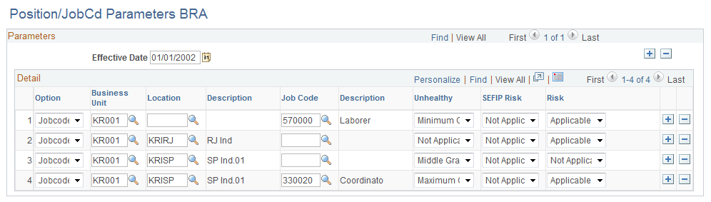

Position/JobCd Parameters BRA Page
Use the Position/JobCd Parameters BRA (position/job code parameters) page (GPBR_MIXED_PARM) to define unhealthy and hazardous indicators for job codes and positions.
Navigation:
Set Up HCM, and then Product Related, and then Global Payroll & Absence Mgmt, and then Framework, and then Organizational, and then Position/JobCd Parameters BRA, and then Position/JobCd Parameters BRA
This example illustrates the fields and controls on the Position/JobCd Parameters BRA page.
Field or Control Description
Option
Select whether you are assigning unhealthy/risk indicators to a Jobcode or a Position.
Position, Business Unit, Location, and Job Code
Select the position or job code you are assigning unhealthy/risk indicators to using these fields.
Unhealthy
Select the appropriate health risk level for the activities of the job code, position, or location. The system uses this indicator to calculate an earning that compensates for this health risk factor.
SEFIP Risk
Select the appropriate risk level for the activities of the job code, position, or location. The system uses this information to generate the SEFIP report and to determine the employee's retirement deduction.
See Calculating INSS for Special Retirement.
Risk
Select the appropriate hazard level for the activities of the job code, position, or location. The system uses this indicator to calculate an earning that compensates for this hazardous factor.
