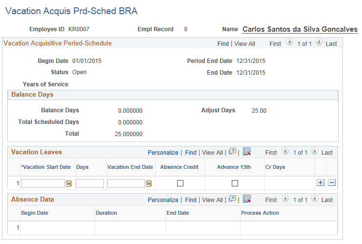

Vacation Acquis Prd-Sched BRA Page
Use the Vacation Acquis Prd-Sched BRA (Vacation Acquisitive Period Schedule BRA) page (GPBR_VACN_MAINT) to list the acquisitive period for all employees.
Maintaining the employees' acquisitive periods can happen manually or automatically.
Navigation:
Global Payroll & Absence Mgmt, and then Payee Data, and then Maintain Absences, and then Vacation Leave BRA, and then Vacation Acquis Prd-Sched BRA
This example illustrates the fields and controls on the Vacation Acquis Prd-Sched BRA page.
Vacation Acquisitive Period-Schedule
Use the fields in this group box to view current and past acquisitive periods or to adjust period lengths, if necessary.
Field or Control Description
Begin Date and End Date
View or modify the begin and end dates of an employee's entitlement period.
Note: The begin and end dates that appear on this page can be modified if necessary. If you modify the dates, the system does not recalculate dates for this period; instead, it uses the dates that you enter.
Status
View and maintain the status of the current entitlement periods or, if you are viewing historical data, view and modify the status of prior entitlement periods. Values are:
Closed Expired: The entitlement period is no longer active, and the employee has no usable vacation days that are associated with that period.
Closed per Absence: The period was automatically closed by the leave parameters that you defined in theAbsence Interference on Acquisitive Period group box on the Vacation Parameters BRA page. For example, you can program an entitlement period to close automatically if an employee has more than 180 days of disability leave in a period.
In Progress: The entitlement period is the current period.
Open: The entitlement period is no longer the current period, but the employee has vacation days that are associated with that period that can still be taken.
See Understanding Vacation Setup.
Note: The entitlement period statuses that appear on this page are updated automatically by the Update Vacation Entitlement process. However, you can modify these statuses, if necessary.
Years of Service
Displays the employee's years of service.
Max Days # (maximum number of days)
Displays the maximum days that an employee can acquire during the acquisitive period.
Balance Days
Balance Days
Displays the number of days in the vacation balance.
Note: The balance = (Total vacation days per entitlement period) – (Programmed Vacations) – (Days Sold) + Adjustments.
Total Scheduled Days
Displays the total number of programmed leave days that are recorded in Global Payroll for Brazil.
Adjust Days
Enter the number of days (positive or negative) by which you want to adjust the leave balance that is displayed in the Balance Days field.
Total
Displays the sum of the Balance Days and Total Take Days.
The information in this group box is updated when you save the page and during the Update Vacation Entitlement process.
Vacation Leaves
Use the fields in this group box to define programmed (planned) or confirmed vacations for an employee. A programmed vacation is one that can be set up in advance of the actual vacation take and defines the vacation begin and end dates. In addition, the leave program controls whether the payees will receive an advance on the 13th salary during the vacation period and allows employees to sell vacation.
Vacation Start Date
Enter the begin date of the vacation.
Days
Enter the duration of the vacation.
Note: When you enter the begin date and a duration, the system automatically calculates the end date of the vacation and populates the Vacation End Date field.
Vacation End Date
This field is automatically populated when you enter a vacation begin date in the Vacation Start Date field and a duration in theDays field. If you want, you can populate this field yourself and the duration will be recalculated accordingly.
Note: If the leave that you enter exceeds the number of leaves per period that is allowed on the Vacation Parameters BRA page, the system issues a warning. Similarly, if the number of leave days in the vacation exceeds the leave balance, the system issues a warning.
Status
View and maintain the status of vacations. Values are:
Calculated: Indicates that payroll has processed the leave take.
Note: The value of this field is automatically updated to Calculated when a vacation take is processed. If vacation approval is required, all takes must be Confirmed before they can be Calculated. Otherwise, the status of a vacation can change directly from Programmed to Calculated.
Canceled: Select to cancel an already programmed vacation. The process also cancels the programmed vacation when an entitlement period is closed and it contains a programmed vacation.
Closed: Indicates vacation days were taken and paid.
Confirmed: Select to approve a programmed leave.
Note: To require official confirmation (approval) of a vacation before the payroll process can process the take, select the Needs Confirmation for Program check box on the Vacation Parameters BRA page. When you do this, you must confirm any take that you enter on Vacation Acquis Prd-Sched page before it can be calculated.
Programmed: Select when the vacation take is first entered—before the leave has been either confirmed or calculated.
Absence Credit
Select to sell unused vacations days—that is, days that remain at the end of a vacation. When you select this option, the Cr Days (credit days) field becomes available.
Enter the number of unused vacation days to sell for the employee.
The value of these days is credited to the employee.
Advance 13th
Select to enable the employee to receive an advance on his or her 13th salary.
Note: When you save this page, an override to payee calendars is automatically generated in the core Global Payroll records. This override enables Global Payroll for Brazil to process automatically the entire vacation event in a single calendar group with a payment two days before the vacation begin date. However, you can insert or modify the payee calendars manually.
Absence Data
This section displays the event history of the corresponding vacation leave, if applicable.
For example, if the system splits up a vacation leave as a result of an absence event that occurs during that scheduled vacation, you can see the list of voided vacation events related to the split in this section for reference purposes.
