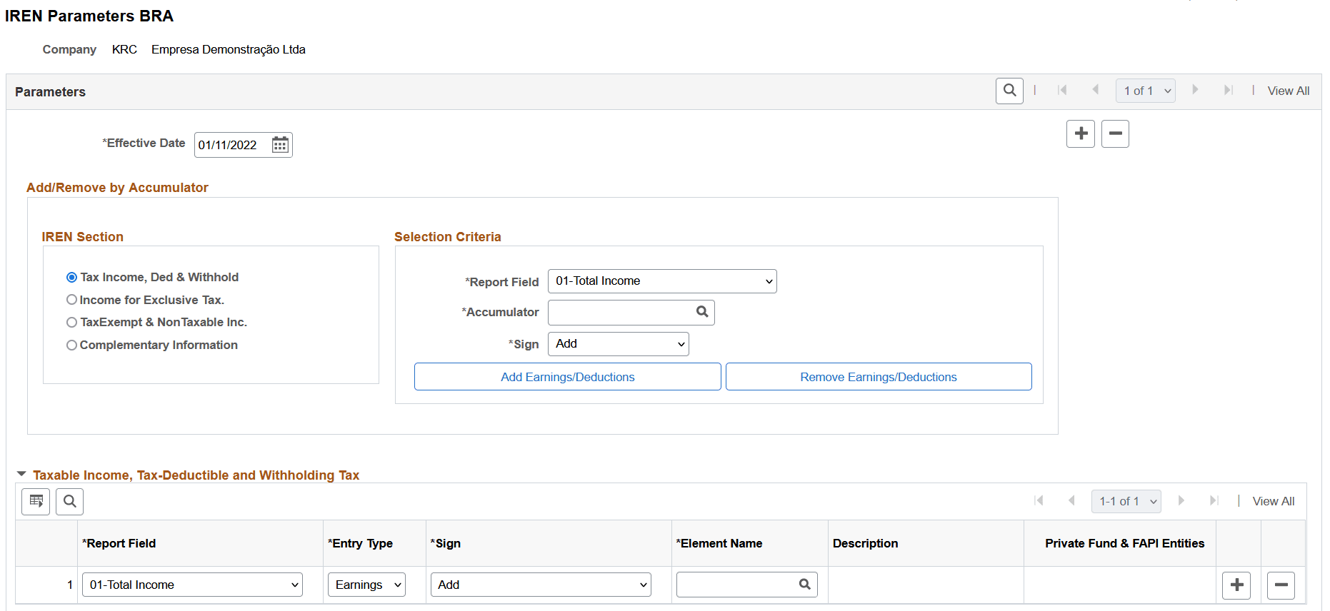

IREN Parameters BRA Page
Use the IREN Parameters BRA page (GPBR_IREN) to define IREN parameters for a company.
Navigation:
Set Up HCM, and then Product Related, and then Global Payroll & Absence Mgmt, and then Taxes, and then IRRF Parameters BRA, and then IREN Parameters BRA
This example illustrates the fields and controls on the IREN Parameters BRA page (1 of 2).
This example illustrates the fields and controls on the IREN Parameters BRA page (2 of 2).

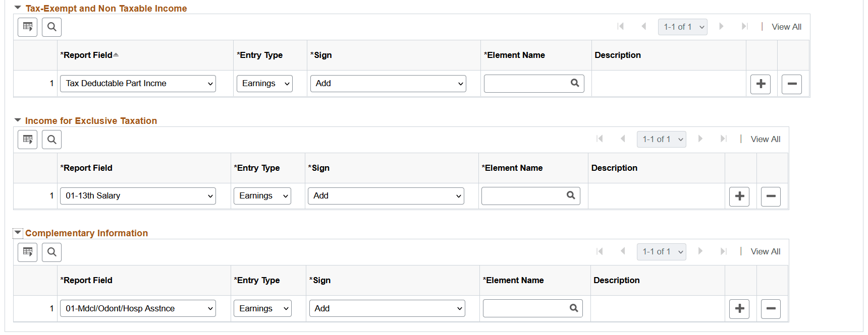

Each section of this page corresponds to a section of the IREN report that has the same name. Map the report fields in each section to the elements that will provide the values for these fields.
Add/Remove by Accumulator
You can add or remove earnings or deductions to a section of the report by selecting the appropriate report section in the IREN Section region of the page. Then, specify the Report Field and Accumulator, and finally click the Add Earnings/Deductions button or the Remove Earnings/Deductions button and the system adds or removes the appropriate earnings or deductions, based on the accumulator you specified.
Field or Control Description
IREN Section
Click the name of the report section for which you wish to add or remove earnings or deductions.
Report Field
Select the field in the IREN report, based on the section you choose, for which you wish to add or remove earnings or deductions.
Accumulator
Specify the accumulator for which you want to add or remove earnings or deductions.
Add Earnings/Deductions and Remove Earnings/Deductions
Click to add or remove the earnings or deductions to the IREN report based on the specified accumulator.
Report Section Regions
For each report section, specify the entries in the report fields that you want to include in the report.
Report Field
Specify the report field for which you wish to add elements.
Entry Type
Specify whether the element is either an earnings element or a deductions element.
Element Name
Specify the element name that you wish to add to the specified section of the report.

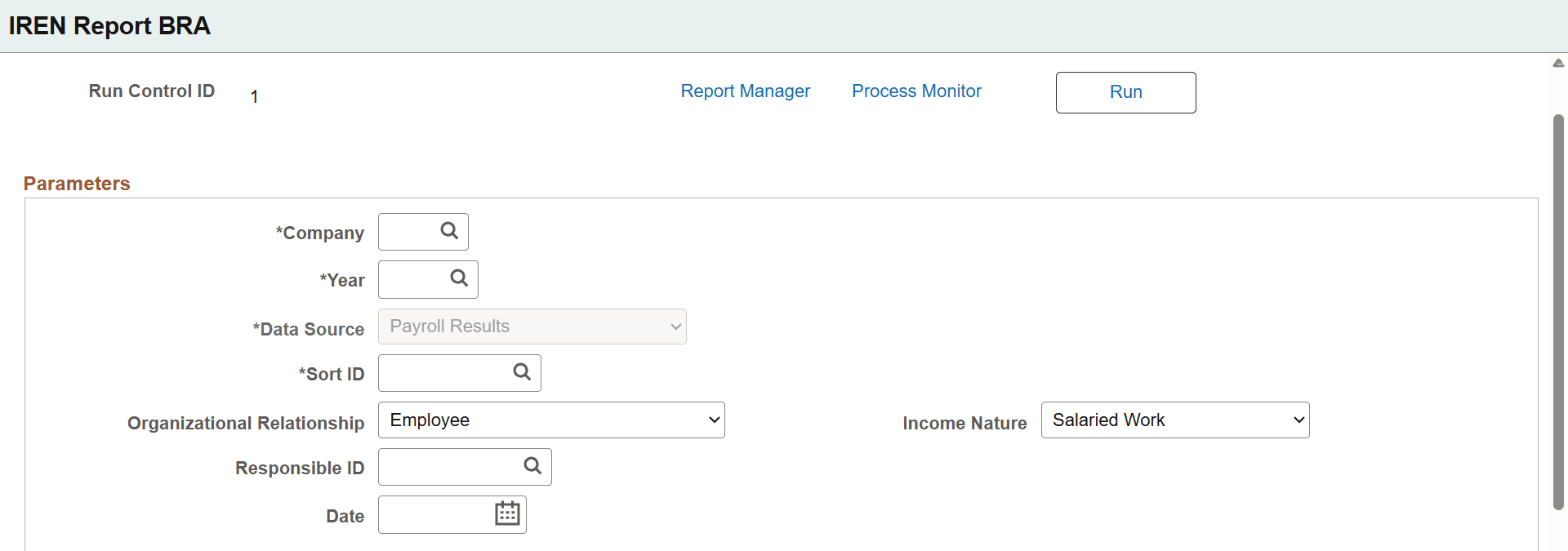

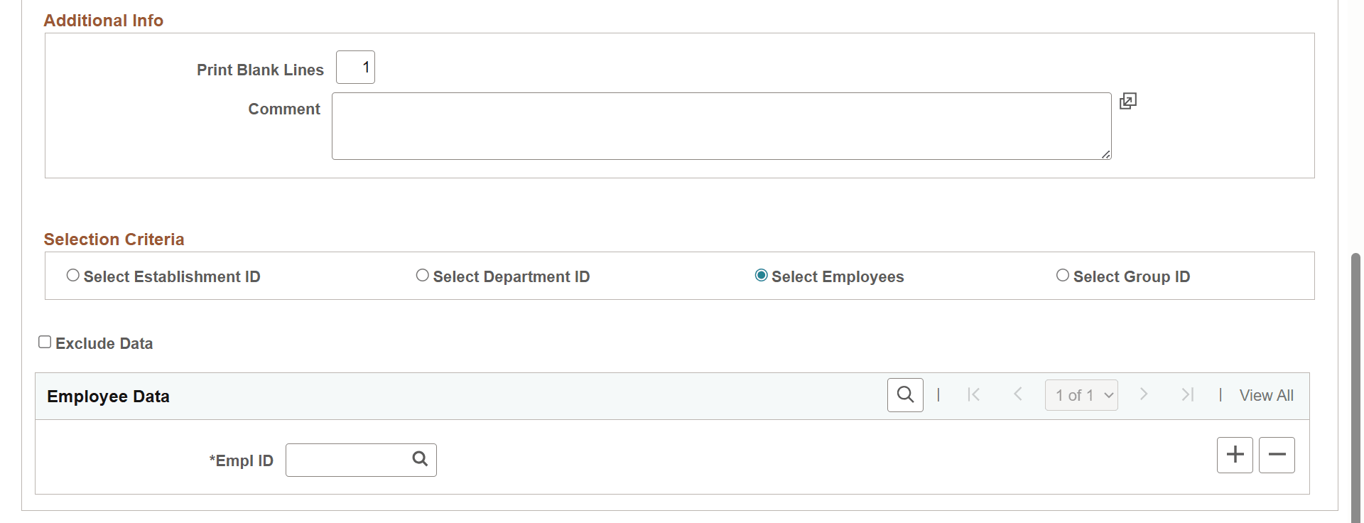

Use the IREN Report BRA page (GPBR_RC_IREN) to generate the IREN report.
Navigation:
Global Payroll & Absence Mgmt, and then Taxes, and then IRRF Report BRA, and then IREN Report BRA
Data Source
Select the data source to use for the IRRF report. Values include:
Both: Use both payroll and eSocial S-5002 data for side-by-side comparison (capability is available beginning with calendar year 2025).
Event S-5002: Use only eSocial S-5002 event data. Payroll Results: Use only internal payroll results (legacy behavior). This field becomes editable when the value of the Year field is 2025 or later.
Organizational Relationship
You can generate the report for employees, contingent workers, or persons of interest.
Income Nature
You can include salaried or unsalaried workers.
Responsible ID
Identify the person who is responsible for this report.
Date
Enter the date to print on the report.
