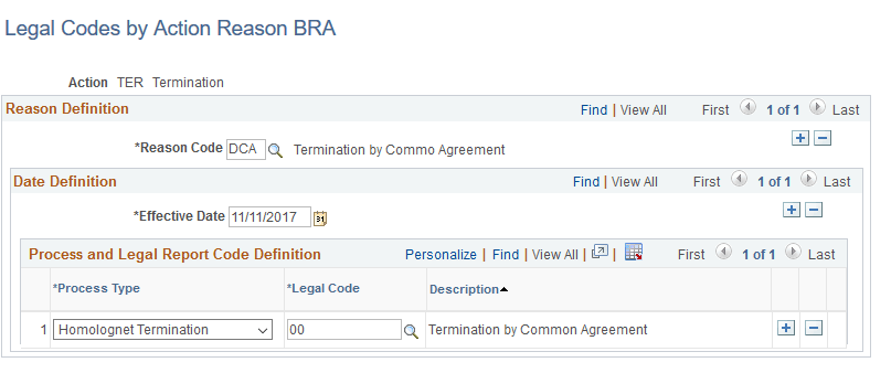

Legal Codes by Action Reason BRA Page
Use the Legal Codes by Action Reason BRA page (GPBR_RPTMOV_DEF) to associate action reasons with process type legal codes.
Navigation:
Set Up HCM, and then Product Related, and then Global Payroll & Absence Mgmt, and then Reports, and then Legal Codes by Action Reason BRA
This example illustrates the fields and controls on the Legal Codes by Action Reason BRA page.
As part of the setup for Termination Contract reporting to support terminations by agreement, you need to associate the system-delivered legal code (00) with the appropriate action and reason for your business needs.

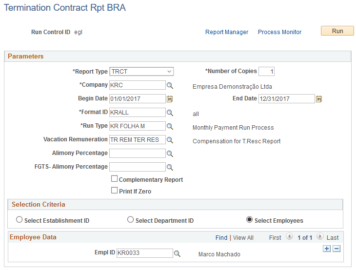

Termination Contract Rpt BRA Page
Use the Termination Contract Rpt BRA (termination contract report BRA) page (GPBR_RC_TER_CON) to run the Employment Contract Termination report.
Navigation:
Global Payroll & Absence Mgmt, and then Termination Processing, and then TRCT Report BRA, and then Termination Contract Rpt BRA
This example illustrates the fields and controls on the Termination Contract Rpt BRA page.
Field or Control Description
Report Type
Select a report type to run, THRCT, TQRCT, TRCT, or run all of them.
Begin Date and End Date
Enter a date range. The system will select only records falling on or between these dates.
Format ID
Select the element list that contains all the required earnings and deductions that need to be printed, for example, KRDEMPGTO.
Run Type
Select the termination run type.
Vacation Remuneration
Select the accumulator that contains the total amount for termination compensation purposes. TR REM TER RES is provided as an example for this accumulator.
Alimony Percentage
If the employee has any garnishment, such as alimony, and you would like to print the percentage that the employee pays, you need to provide a variable element name. TR VR %PEN ALIM is provided as an example of a variable element. You need to override this variable at the payee level to assign a percentage at the payee level.
Select Establishment ID and Establishment ID
Select to report on all dismissed employees from selected establishments. Enter the establishment IDs in the Establishment Data group box.
Select Department ID, Set ID, and Department ID
Select to report on all dismissed employees from selected departments. Enter the setIDs and department IDs in the Department Data group box.
Select Employees and Empl ID
Select to report on selected employees. Enter the employee IDs in the Employee Data group box.
