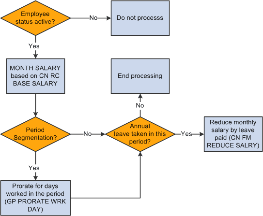

Monthly Salary
Global Payroll for China delivers the MONTH SALARY earning as an example of how to calculate monthly salary for your payees.
  • The CN GC ACTIVE generation control ensures that only payees with a Job status of Active receive the MONTH SALARY earning.
  • The system determines the amount of MONTH SALARY based on the CN RC BASE SALARY rate code.
  • The post processing formula CN FM REDUCE SALRY reduces MONTH SALARY by any leave taken during the period.
  • The proration rule GP PRORATE WRK DAY prorates MONTH SALARY based on the number of days worked in the calendar period.
    Proration and rounding rules are set at the pay group level.
This diagram illustrates the process flow for the MONTH SALARY earning:
This diagram illustrates the process flow for the MONTH SALARY earning.
Process flow for MONTH SALARY earning

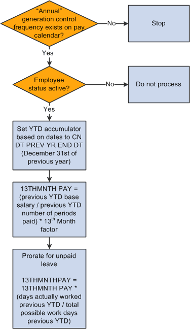

13th Month Pay
Global Payroll for China delivers the 13THMNTH PAY earning as an example of how to provide 13th Month Pay for your payees.
  • The system pays 13THMNTH PAY annually based on the previous 12 months' earnings.
  • The system calculates 13THMNTH PAY using a payee's base monthly salary only (annual salary/12, prorated for days worked during the month), not the actual MONTH SALARY earning. It also does not include any allowances or deductions in the calculation of 13THMNTH PAY.
  • For payees hired between the 1st and 15th of a month in the calculation year, 100% of their base monthly salary for the hire month and subsequent months contributes to 13THMNTH PAY. For payees hired after the 15th of a month, 50% of the base monthly salary for the hire month and 100% of the base monthly salary for subsequent months contribute to 13THMNTH PAY.
  • The system prorates 13THMNTH PAY for unpaid vacation leave taken during the year, that is, leave days exceeding the annual leave entitlement.
This diagram illustrates the process flow for the 13THMNTH PAY earning:
This diagram illustrates the process flow for the 13THMNTH PAY earning.
Process flow for 13THMNTH PAY earning
