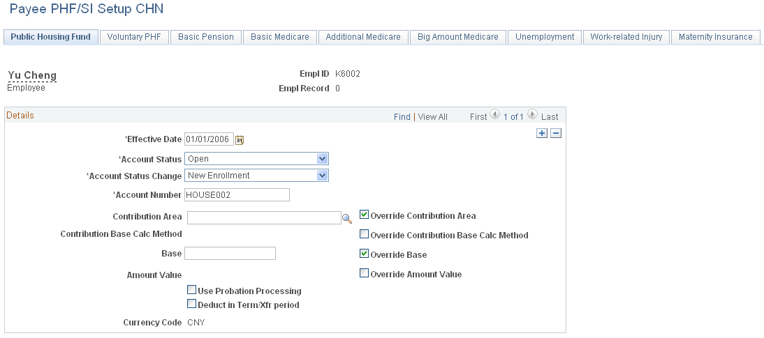

Payee PHF/SI Setup CHN Page
Benefit Administrators use the Payee PHF/SI Setup CHN (GPCN_CONT_EE) page to override employee PHF/SI deduction information..
Navigation:
Global Payroll & Absence Mgmt, and then Payee Data, and then Social Security / Insurance, and then Payee PHF/SI Setup CHN, and then Payee PHF/SI Setup CHN
This example illustrates the fields and controls on the Payee PHF/SI Setup CHN page.
Each tabbed page in this component represents a contribution type. The contribution types for which pages appear here, the order in which they appear, and the tab or page labels, are all based on the values that are selected on the Define PHF/SI Sequence CHN page.
