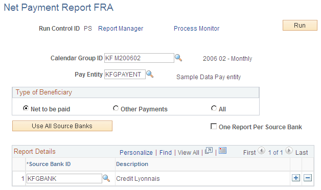

Net Payment Report FRA Page
Use the Net Payment Report FRA page (GPFR_BANK_REPORT) to select the Calendar Group ID and Pay Entity to use for the reports.
Navigation:
Global Payroll & Absence Mgmt, and then Payment Processing, and then Net Payment Report FRA, and then Net Payment Report FRA
This example illustrates the fields and controls on the Net Payment Report FRA page. You can find definitions for the fields and controls later on this page.
Field or Control Description
Type of Beneficiary
Select the type of recipients to display in the payment report. Values are:
Net to be paid: Employee recipients.
Other Payments: Recipients other than employees.
All: All pay recipient types.
Use All Source Banks
Select to include all the source banks used by the Calendar Group and Pay Entity selected.
One Report Per Source Bank
Select to generate one report per source bank. If selected, you can specify only one Source Bank ID in the Report Details section of this page. You must run the reports separately for each source bank.
Source Bank ID
Select the source bank(s) for the EFT file.
