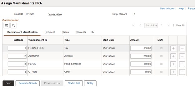

This example illustrates the fields and controls on the Assign Garnishments FRA page: Garnishment Identification tab.
Garnishment Identification Tab
Field or Control Description
Garnishment ID
Enter the garnishment number on the garnishment notification. Enter up to 40 alphanumeric characters. You should enter the SATD identification when applicable.
Type
Select the type of garnishment. Valid values are:
  • Alimony
  • Penal Sentence
  • Tax
  • Other
Start Date
(Required) Enter the date on which the payee's earnings become subject to garnishment. The date should fall within the current processing period. You cannot change this date once the system processes the first garnishment amount.
If you enter a start date that falls within an earlier processing period, the system will not begin to calculate the garnishment until you process a retroactive pay run. In addition, the results may be unpredictable and may require manual adjustment.
Amount
If the garnishment is for alimony, enter the amount of the monthly payment.
In all other cases, enter the initial amount of the garnishment. That is, enter the total amount owed according to the garnishment notice.
If you need to change the amount of the garnishment later, use positive input. See Changing a Garnishment Balance later in this section for more information.
DSN
Use this check box to identify the garnishments that will be reported through DSN. Only those garnishments with this check box ON, will be included in the DSN file. The option of paying garnishment notified by DGFIP through DSN was introduced starting DSN 2024.

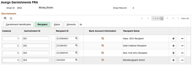

Recipient Tab
Recipient information is required for the correct payment of the garnishment, unless the garnishment will be paid through DSN.
This example illustrates the fields and controls on the Assign Garnishments FRA page: Recipient tab.
Assign Garnishments FRA page_Recipient
Recipient ID
Select the garnishment recipient.
Recipient Name
Enter the name of the garnishment recipient. This field is required only if the recipient does not have a Recipient ID.
Bank Account Information
Select to add information about the bank account that will receive the garnishment payment. Specify the payment method, country code, bank ID, bank branch ID, account number, account name, and currency code.

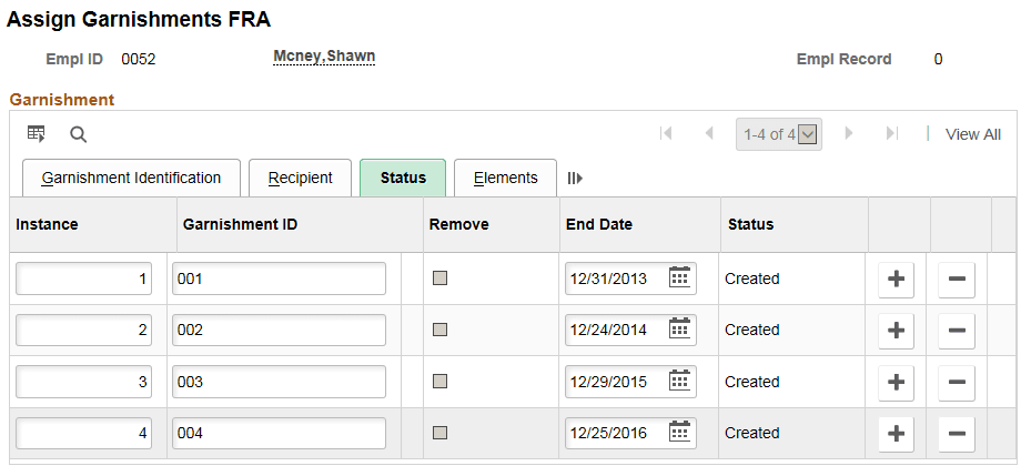

Status Tab
This example illustrates the fields and controls on the Assign Garnishments FRA page: Status tab.
Assign Garnishments FRA page Status Tab
Remove
Select this check box only if you want to remove a garnishment. To delete the garnishment, you must remove it first, save the page, and then click the minus (-) button to the right.
End Date
Enter the final payment date.
Status
Displays the status. Valid values are:
Created: Appears when you click the plus (+) button to add a new row.
Processed:The status is set to Processed when you save the garnishment data.
Updated: Indicates that you modified the garnishment data.
Removed: Indicates that the system has deleted the deduction.

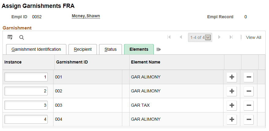

Elements Tab
This example illustrates the fields and controls on the Assign Garnishments FRA page: Elements tab
Assign Garnishments FRA page Elements tab
Element Name
Displays the name of the deduction element that calculates the garnishment amount during payroll processing. The elements for garnishments are:
  • Alimony Deductions: GAR ALIMONY
  • Penal sentence deductions: GAR PENAL
  • Tax debt deductions: GAR TAX
  • Ordinary debt deductions: GAR OTH
Note: In case of multiple garnishments of the same type, the system will create different instances of the corresponding deduction. The number of garnishments that the same employee can have is therefore unlimited.
