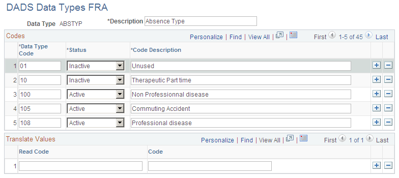

DADS Data Types Page
Use the DADS Data Types FRA page (GPFR_DA_DATTYP) to view data types and translate values.
This list contains information for each data type defined by unified DADS requirements.

Set Up HCM, and then Product Related, and then Global Payroll & Absence Mgmt, and then Social Security / Insurance, and then DADS Data Types FRA, and then DADS Data Types FRA
This example illustrates the fields and controls on the DADS Data Types FRA page. You can find definitions for the fields and controls later on this page.
Use data types to translate DADS records used in the report. When you add or modify a DADS data record, data types provide a view of the description instead of only the DADS record code number.
Field or Control Description
Read Code
Maps the field value to the DADS structure code that you specify in the associated Code field. The field value is extracted from the PeopleSoft application.
Code
DADS structure code translated from the Read Code field.

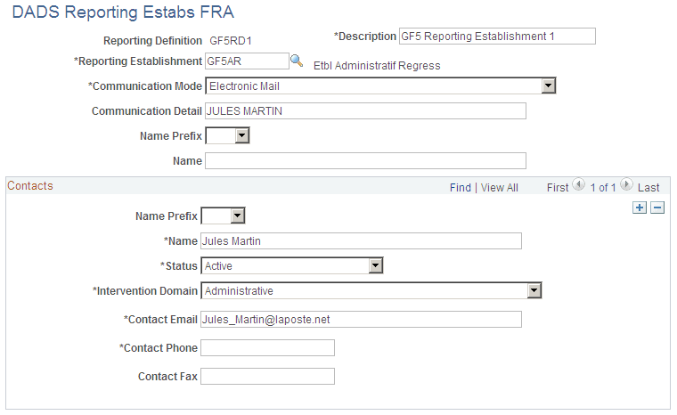

Reporting Estabs FRA Page
Use the DADS Reporting Estabs FRA page (GPFR_DA_ESTREP) to define reporting establishments and contacts.

Set Up HCM, and then Product Related, and then Global Payroll & Absence Mgmt, and then Social Security / Insurance, and then DADS Reporting FRA, and then DADS Reporting FRA
This example illustrates the fields and controls on the DADS Reporting page. You can find definitions for the fields and controls later on this page.
DADS Reporting Establishment page allows defining the reporting establishments and the contacts within these establishments. The reporting establishments created are referenced in the Sending Reference setup.
Enter the establishment code. One reporting establishment must be set up for each declared company. Use this page to define the reporting establishment and the information related to the establishment (such as people to contact and communication mode with DADS) that is used in structure 10.
Communication Mode
Enter the transmission method for the DADS log file. Valid values are Electronic Mail and Postal Mail.
Communication Detail
Values vary depending on the communication mode:
Electronic Mail: Enter the email address.
Postal Mail: Enter specific contact data, such as a phone number.
Name Prefix
Enter the name prefix for person who can be contacted by the DADS organization representatives.
Name
Enter the name of the person who can be contacted by the DADS organization representatives.
Contacts
Name Prefix
Enter the name prefix for the contact.
Name
Enter up to three active contacts for each reporting establishment.
Status
Select a status. A status of Active indicates that a contact must be used.
Intervention Domain
Select Administrative, Computing, or Other.
Contact Email
Enter the email address of the contact.
Note: The underscore character "_" may be used in this field.
Contact Phone
Enter the phone number of the contact.
Contact Fax
Enter the fax number of the contact.

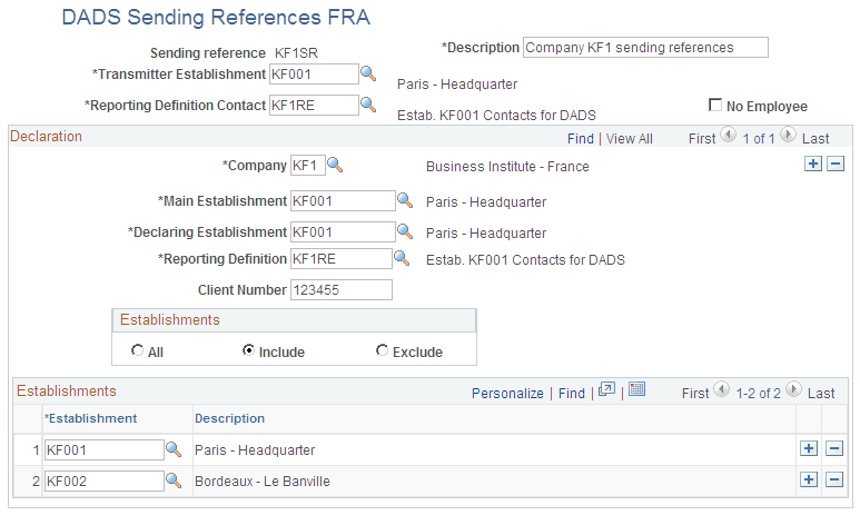

DADS Sending References FRA Page
Use the DADS Sending References FRA page (GPFR_DA_SNDREF) to define the layout of the output file.
One file is a set of declared companies, which comprise groups of employees called establishments.

Set Up HCM, and then Product Related, and then Global Payroll & Absence Mgmt, and then Social Security / Insurance, and then DADS Sending References FRA, and then DADS Sending References FRA
This example illustrates the fields and controls on the DADS Sending References FRA page. You can find definitions for the fields and controls later on this page.
Sending reference information is used in structures S10 and S20 to identity the transmitter and company of the declaration. It is also used in structure S80 to identify establishments to be included in the declaration.
Transmitter Establishment
Enter an establishment defined in the PeopleSoft HR Establishment table. The transmitter establishment is declared in record S10.G01.00.001 and S10.G01.00.001.002 (transmitter SIREN plus NIC number).
Reporting Definition Contact
Select an entry defined on the Reporting Establishment page. The reporting establishment contact must be indicated for the sending reference. A reporting establishment contact can be used several times for different sending references. Data from the reporting definition populates the records S10.G01.00.013.001 and S10.G01.00.013.002 (log file recipient SIREN and NIC) as well as the transmitter contact information (S10.G01.01 structure).
No Employee
Select if there are no employees to declare for the report.
If selected, all the establishments in the Establishment List in the page must have employed no staff during the declared year. The file generated must have a recipient type of None. No S30 structure must be present in the file; the record S20.G01.00.004.001 is equal to the code 05 for DADS-U empty and the record S20.G01.00.004.002 is equal to the code 55 for Code Type declaration None.
Company
Enter the company that is part of the DADS file for the defined sending reference. The company is declared in the record S20.G01.00.001 (SIREN number).
Main Establishment
Enter a main establishment. For each declared company, the main establishment must appear on the establishments list. The main establishment is declared in the record S20.G01.00.008 (main establishment NIC).
Declaring Establishment
Enter a declaring establishment. You can use the value that appears in the Main Establishment field. The declaring establishment is reported in the record S20.G01.00.010 (NIC number).
Select an entry defined on the Reporting Establishment page. The Reporting Establishment must be indicated for each company. The reporting definition information is used to declare the records S20.G01.00.014.001 to S20.G01.00.016 (SIREN plus NIC numbers).
Client Number
Optional. Enter a client number. The client number is declared in the record S20.G01.00.013. This field can be used when the transmitter of the DADS attributes a client to the companies he declares, for example for accounting firms performing declarations for their clients.
All
Select to declare all establishments.
Include
Select to declare only the establishments displayed on the page.
Exclude
Select to declare all establishments except those listed on the page.
Establishment and Description
Enter at least one establishment. The establishment lists the employees to be processed.
