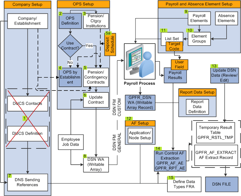

As the monthly DSN report generation follows the monthly payroll process, all the payroll related set ups such as OPS set ups, payroll & absence element setups etc. are prerequisites for DSN data extraction.
To set up DSN extraction, use Define Data Types FRA and DSN Sending Reference FRA components.
This diagram shows how the data is extracted in DSN Reporting process.
DSN Reporting Process

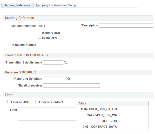

Sending Reference Page
Use the Sending Reference page (GPFR_DSN_SNDREF) to create a sending reference that defines the transmitter and receiver of the DSN file. It is also used to identify the establishments to be included in the DSN declaration
Navigation:
Set Up HCM, and then Product Related, and then Global Payroll & Absence Mgmt, and then Social Security Insurance, and then DSN Sending Reference FRA
This example illustrates the fields and controls on the Sending Reference page. You can find definitions for the fields and controls later on this page.
Sending Reference
Field or Control Description
Monthly DSN
Select the checkbox if the DSN file needs to be sent monthly.
Event DSN
Select the checkbox if the DSN file needs to be sent on occurrence of an event.
Fraction Number
Enter a fraction number. This is to identify the fraction of the DSN file if there are multiple files generated by multiple systems. This information is fed into the attribute S20.G00.05.003
Transmitter
Transmitter Establishment
Select an establishment defined in the PeopleSoft HR Establishment table. The transmitter establishment is the establishment corresponding to the selected company that sends the DSN information.
Receiver
Reporting Definition
Select an entry defined on the Reporting Establishment page. It is the establishment to which the DSN information is reported. For each company, a Reporting Establishment must be indicated.
Email of receiver
Enter the email id of the receiver.

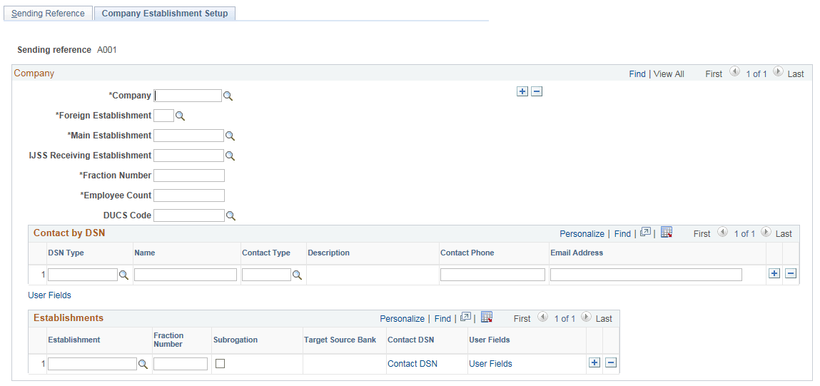

Company Establishment Setup Page
Use the Company Establishment Setup page (GPFR_DSN_SNDREF1) to select the companies / establishments to be grouped for the DSN output file.
Multiple companies/establishments can be selected and grouped under a single sending reference.
This example illustrates the fields and controls on the Company Establishment Setup page. You can find definitions for the fields and controls later on this page
Navigation:
Set Up HCM, and then Product Related, and then Global Payroll & Absence Mgmt, and then Social Security Insurance, and then DSN Sending Reference FRA, and then Company Establishment Setup Page
Company
You can define multiple companies and corresponding parameters under a single sending reference.
Company
Select the company that generates DSN file for the defined sending reference.
Foreign Establishment
To identify if the company is:
  • Foreign company with establishment in France
  • Foreign company outside EU without establishment in France
  • Foreign Company in the EU without establishment in France
Main Establishment
Select the main establishment that handles the regulatory requirements of the selected company.
IJSS Receiving Establishment
Select the establishment that handles the IJSS related information of the selected company.
Fraction Number
Enter a fraction number. This is to identify the fraction of the DSN file if there are multiple files generated by multiple systems. This information is fed into the attribute S20.G00.05.003. Note that this precedes the one defined under Sending Reference level.
Employee Count
Enter the number of employees included in the DSN process from the selected company.
DUCS Code
Select the DUCS code associated with the company.
These are defined under DUCS Definition FRA component, which is used only for DSN version 2.5 and not used thereafter.
Contact by DSN
For each company selected, you can enter the contact information based on the DSN file type. You can add multiple DSN types and corresponding contact details for the selected company.
DSN Type
Select the type of DSN file based on the information to be reported.
Contact Type
Select the type of the contact to be used based on the information to be reported.
Establishment
For the selected company, you can add multiple establishments and corresponding contact details. Note that only these establishments will be considered for DSN Reporting.
Establishment
Select the establishment corresponding to the selected company.
Subrogation
Select the checkbox if subrogation facility needs to be enabled.
Contact DSN
The Contact Information Defined here precedes the Contact Information provided at Company level.
