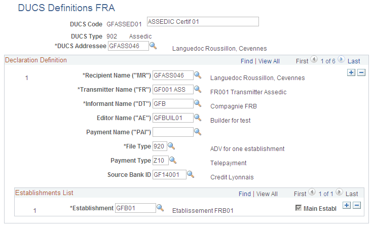

DUCS Definitions Page
GPFR_DUCS
Define how establishments are used in creating DUCS.
Understanding DUCS Setup
Create a DUCS file by running a batch program, in which the system searches and compiles relevant data, writes it to a specific table, and then creates a flat file and a control report. If needed, you can change the payment before posting the file.
There are three kinds of setup:
  • Basic setup.
    For this setup, you use the delivered DUCS Types page and the DUCS Parameters component as follows:
    • Define each DUCS type on the DUCS Types page.
    • Define DUCS parameters in the DUCS Parameters component.
  • Contributions setup.
    The BRC rows are set up in the details of the BRC Node Set of the DUCS 4.2 application of Application Framework
  • Organization setup.
    This setup involves the DUCS Contacts component and the DUCS Definition page. The PeopleSoft system does not provide this data because it depends on the organization of each company.
    • Define all DUCS contacts, recipients, transmitters, informants, editors, and establishments in the DUCS Contacts component.
    • Assign these contacts their specific roles on the DUCS Definition page.
      This is where the report information is connected with the transmission and banking information. Transmission of payment is done using the source bank information that you establish in the system.

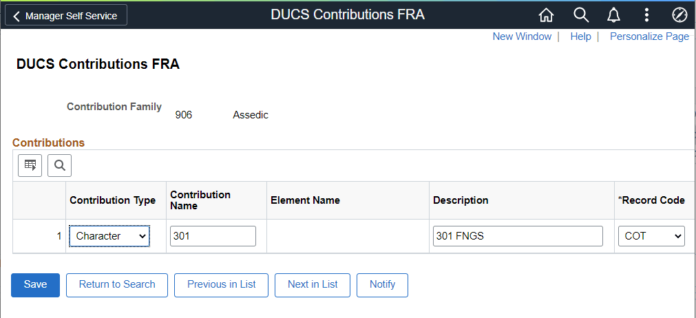

DUCS Contributions FRA Page
Use the DUCS Contributions FRA page (GPFR_DUCS_CONTRIBS) to .
Navigation:
Set Up HCM, and then Product Related, and then Global Payroll & Absence Mgmt, and then Social Security / Insurance, and then DUCS Contributions FRA, and then DUCS Contributions FRA
This example illustrates the fields and controls on the DUCS Contributions FRA page. You can find definitions for the fields and controls later on this page.
Field or Control Description
Contribution Type
Displays the type of contribution.
Contribution Name
Displays the name of the contribution for the contribution type.
Element Name
Displays the name of the element for the contribution type.
Description
Displays the description of the contribution type.
Details
Click to access the DUCS Contribution Details page. Use this page to set up the DUCS text file and PDF report.
Use the DUCS Definitions FRA page (GPFR_DUCS) to define how establishments are used in creating DUCS.
Navigation:
Set Up HCM, and then Product Related, and then Global Payroll & Absence Mgmt, and then Social Security / Insurance, and then DUCS Definitions FRA, and then DUCS Definitions FRA
This example illustrates the fields and controls on the DUCS Definitions FRA page. You can find definitions for the fields and controls later on this page.
DUCS Addressee
Select the addressee from the DUCS Contact Definition component. This information is for your information only; it's not a DUCS requirement.
Declaration Definition
Recipient Name ("MR")
Select the recipient of the DUCS file. The Contact Definition field on the Contact Definition page determines available values. The recipient name corresponds to the recipient of the DUCS declaration as defined in the DUCS requirement book.
Transmitter Name ("FR")
Select the transmitter name. The Contact Definition field on the Contact Definition page determines available values. In general, it is the establishment responsible for sending the DUCS file.
Informant Name ("DT")
Select the informant name. The Contact Definition field on the Contact Definition page determines available values. You must indicate here the legal declaring entity (Entité Juridique Déclarante) as defined in the DUCS requirement book. For URSSAF and ASSEDIC, the informant should be companies, while for ARRCO, AGIRC, and contingency funds, it is the member.
Editor Name ("AE")
Select the editor name. The Contact Definition field on the Contact Definition page determines available values. You must indicate here the name of the party preparing the declaration for you.
Payment Name ("PAI")
Select the payment name. The payment name is the name of the contact who is in charge of the payment of the contributions. The Contact Definition field on the Contact Definition page determines available values.
File Type
Select a file type from the DUCS Parameters - Declaration Type page. Available values correspond to the relevant DUCS type.
Payment Type
Select a payment mode or method. Valid values are determined by the Pay Mode field on the DUCS Parameters - Pay Information page: Check, Transfer, Automatic Deduction, and Telepayment.
Source Bank ID
Select the bank account to be debited. You must have established a source bank account.
Establishments List
Establishment
Select the declared entities. For the URSSAF and the ASSEDIC, it is Establishments; for ARRCO, AGIRC, and contingency funds, it is the payment center (centre payeur). If you are setting up VLU or PG, enter at least two establishments; otherwise, enter one establishment. The Contact Definition field on the Contact Definition page determines available values.
Main Establ. (main establishment)
If you are setting up VLU or PG, select this check box to indicate the main establishment, as defined by the DUCS requirements. This information produce a type FZ record as defined in the DUCS requirement book.
