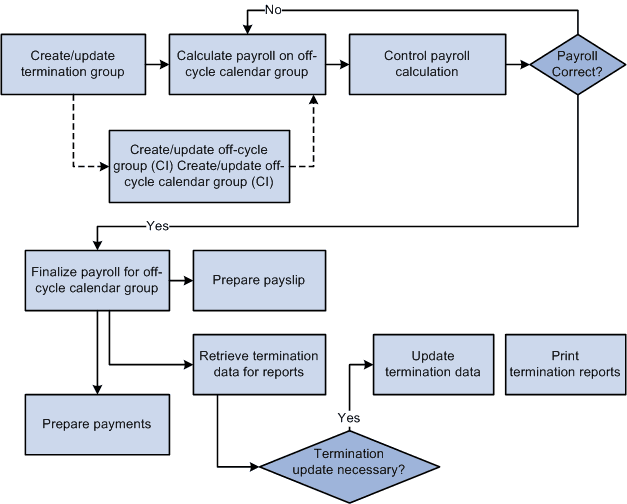

This diagram provides a high-level view of the termination business process
Termination business process
This process can be summarized as follows:
  1. Create the terminated employee group.
  2. Review the off-cycle group. (Optional)
  3. Review the off-cycle calendar group. (Optional)
  4. Launch the payroll identification and calculation for the off-cycle calendar group to which terminated employees are attached.
  5. Review payee messages.
  6. Review payroll results.
  7. Review payee status.
  8. Determine if payroll is correct. If not correct, return to step 4.
  9. Finalize termination group.
  10. Prepare and edit payslip.
  11. Launch the data extraction/retrieval process for the termination group.
  12. Update the termination data if necessary.
  13. Edit the termination reports.
  14. Prepare payments.
