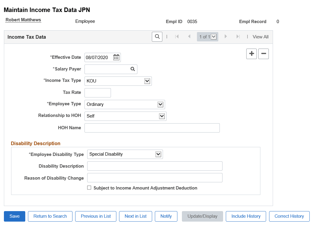

Maintain Income Tax Data JPN Page
Use the Maintain Income Tax Data JPN page (GPJP_IT_PYE_TAX) to enter employee income tax data, such as salary payer number, employee type, and disability information.
Navigation:
Global Payroll & Absence Mgmt, and then Payee Data, and then Taxes, and then Maintain Income Tax Data JPN, and then Maintain Income Tax Data JPN
This example illustrates the fields and controls on the Maintain Income Tax Data JPN page. You can find definitions for the fields and controls later on this page.
Maintain Tax Data JPN
Field or Control Description
Income Tax Type
Select from the following values: Designated Rate, KOU, and OTSU.
For employees with multiple jobs, KOU can be selected only once across all employment records. Otherwise, the system generates an error message. As the system doesn't allow multiple employment records with tax type KOU at the same time, you have to update the current KOU record to a non-KOU value and then update the non-KOU record to KOU.
If the employee type is not KOU, the employee can't update this dependent data on the self-service pages.
Tax Rate
Enter a value here only if you select Designated Rate for the income tax type. For example, enter 0.2 if the designated tax rate is 20 percent.
Relationship to HOH (relationship to head of household)
Select the relationship of the employee to the head of the household. If the employee is the head of household, select Self.
HOH Name (head of household's name)
If the employee is not the head of the household, enter the name of the person who is.
Disability Information
Enter or edit disability information that is provided by employees on the Dependent Deduction report.
Subject to Income Amount Adjustment Deduction
Select this checkbox to enable ‘Income Amount Adjustment Deduction’ for an employee. This checkbox is enabled only when the user selects the ‘Employee Disability Type’ as “Specially Disabled”.
Note: If user selects the checkbox in Maintain Income Tax Data JPN Page, you cannot select this check box for Dependent details in Maintain Dep Tax JPN page. If this selection is already done in Maintain Dep Tax JPN page, then you cannot select the checkbox in the Maintain Income Tax data JPN Page, an error message “Multiple selection is not allowed as Income Amount Adjustment is already selected for self or other dependent” is displayed.

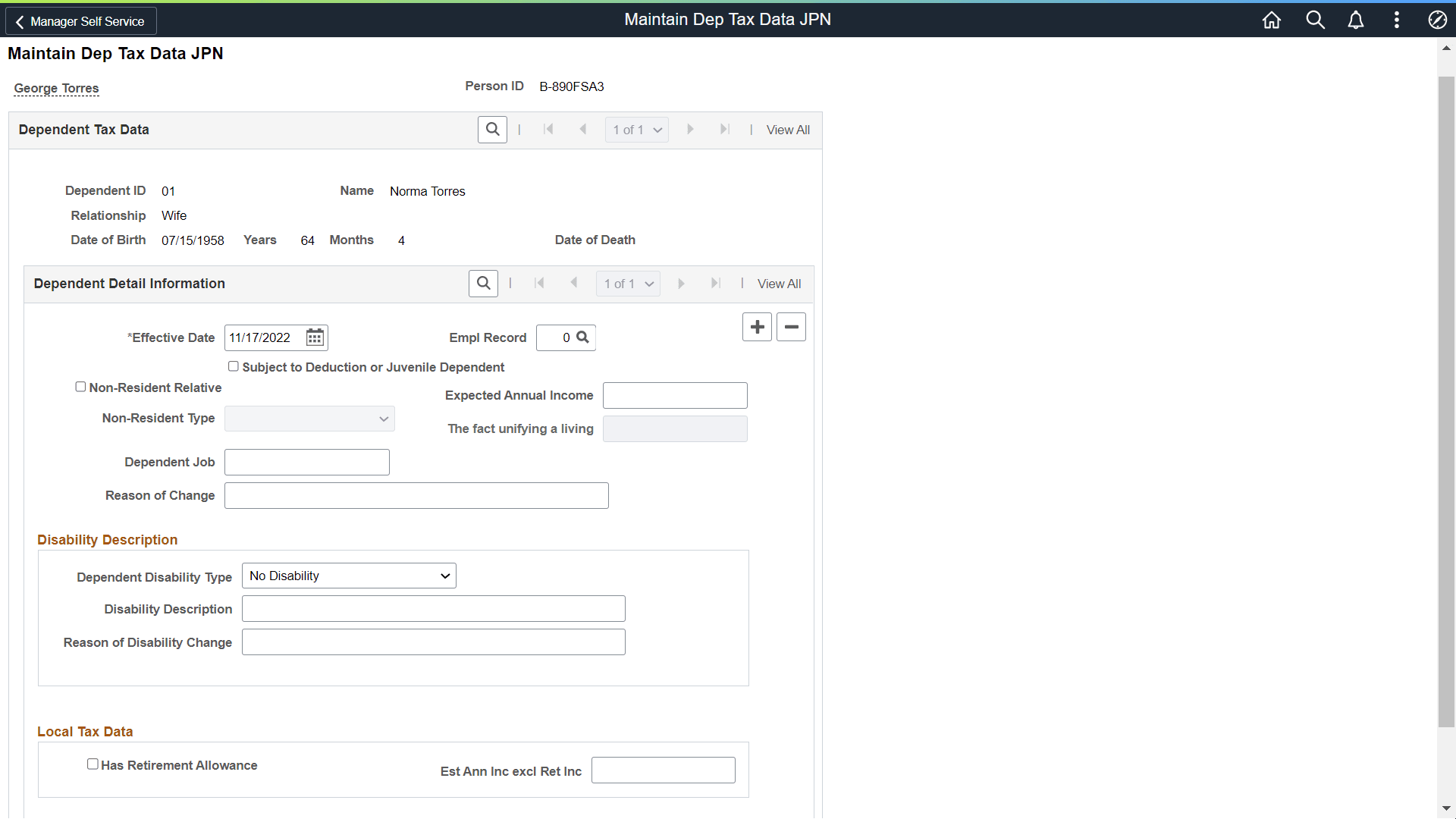

Entering Dependent Income Tax Data
Use the Maintain Dep Tax Data JPN page (GPJP_IT_DEP_TAX) to enter dependent tax data.
Navigation:
Global Payroll & Absence Mgmt, and then Payee Data, and then Taxes, and then Maintain Dep Tax Data JPN, and then Maintain Dep Tax Data JPN
This example illustrates the fields and controls on the Maintain Dep Tax Data JPN page. You can find definitions for the fields and controls later on this page.
The selections you make on this page determine the personal exemptions for income tax during year-end processing, as well as for withholding income tax. The application determines the exemptions based on the dependent's birth date and relationship to the payee.
Information from Dependent Tax Table Age as of Base Date Applicable Personal Exemption
Relationship is Spouse and Subject to Deduction is selected.
Equal to or more than 70.
Elderly Spouse
Less than 70.
Ordinary Spouse
Relationship is other than Spouse, Subject to Deduction is selected and Parent Living with Payee is selected.
Elderly Parent Living with Payee
Less than 70.
Ordinary Dependent
Relationship is other than Spouse, Subject to Deduction is selected, and Parent Living with Payee is not selected.
Elderly Dependent
Relationship is other than Spouse and Subject to Deduction is selected.
Equal to or more than 16 and less than 23.
Specified Dependent
Relationship is other than Spouse and , Subject to Deduction is selected.
Equal to or more than 23, and less than 70.
Ordinary Dependent
Less than 16.
Ordinary Dependent
Any combination other than those specified in this table.
Any age.
Not Applicable
Dependent Detail Information
You must link the dependent tax data with an employment record number. If the employee has multiple jobs, the employment record number that is linked to the tax type KOU on the Maintain Income Tax Data JPN page defaults to the Empl Rcd Nbr field. If no employment record number is linked to tax type KOU, zero is defaulted.
Effective Date
Enter the effective date for change of dependent data in the page.
Note: For a newborn child, enter the child’s birth date in the Effective Date field. This ensures that the system calculates taxes properly for the year in which the child was born.
Subject to Deduction or Juvenile Dependent
Select if the dependent is subject to deduction.
Note: If the relationship of the dependent is changed to ExSpouse in HR, you should deselect the Subject to Deduction check box on this page.
Non Resident Relative
Select this checkbox to enable tax exemption for dependent non-resident relatives.
A dependent non-resident relative will be eligible for exemption only if one of the following four conditions is met:
  1. The dependent age between 16 and 29 or 70 or more.
  2. The dependent who becomes a non-resident due to study abroad.
  3. The dependent is a disabled person.
  4. The dependent who receives a payment of JPY380,000 or more to cover living expenses or education costs in the year from the resident.
Non Resident Type
Select the type of dependent non resident from the drop-down list.
Available options are:
  • Between 16 and 29 or over 70
  • Disabled
  • Payment of 380000 yen or above
  • Studying abroad
Note: This field is enabled only when the Non-Resident Relative checkbox is selected.
Dependent Job
Enter the job details of the spouse.
Reason of Change
Enter the reason for change of the dependent data.
Expected Annual Income
Enter the expected annual income of the dependent.
The fact unifying a living
The fact that he/she lives in the same household. Enter the total amount remitted or will be remitted in the tax year by the dependent non-resident relatives qualified for deduction.
Disability Description
Select this checkbox to enable ‘Income Amount Adjustment Deduction’ for dependents.
This checkbox is displayed only if the user selects ‘Dependent Disability Type’ as “Specially Disabled” or “Living with Specially Disabled” or the age of dependent is 23 years as on the 1st January of the following tax year (for example, in the tax year 2020, if the dependent age is 23 as on 1st January 2021) for which the Income amount adjustment deduction is being calculated.
