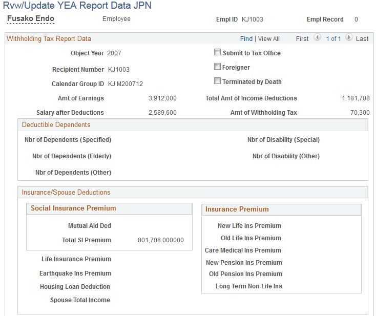

Rvw/Update YEA Report Data JPN Page
Use the Rvw/Update YEA Report Data JPN page to view and update the YEA Data table.
Navigation:
(Global Payroll & Absence Mgmt, and then Year-End Processing, and then Update YEA Report Data JPN, and then Rvw/Update YEA Report Data JPN).
This example illustrates the fields and controls on the Rvw/Update YEA Report Data JPN page.
Rvw/Update YEA Report Data JPN page (1 of 2)
Rvw/Update YEA Report Data JPN page (2 of 2)
Field or Control Description
Submit to Tax Office
The system selects this check box if the KOU-type employee's gross income is over 5 million yen or the OTSU-type employee's gross income is over 500,000 yen (formula YE FM SUBMIT). The system does not verify whether the employee is an officer, retired, a disaster victim, or any of the other criteria for determining whether to submit the Withholding Tax report to the tax office.
Summary
The system enters deductible spouse and dependent identification, prior employment data, and the beginning date of residence (for employees who receive the housing acquisition special deduction). You can edit this data.
Because of length limitations, the entire summary might not appear on the printed reports.
