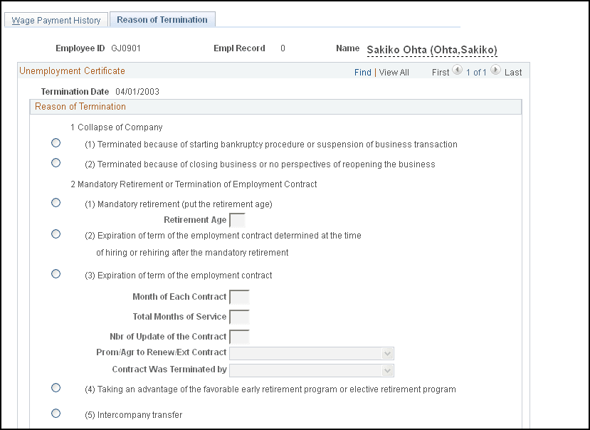

Reason of Termination Page
Use the Reason of Term (reason of termination) page (GPJP_UC_RSN_TERM) to enter and view information about reason of termination.
Navigation:
Global Payroll & Absence Mgmt, and then Termination Processing, and then Update Unemployment Cert JPN, and then Reason of Term
This example illustrates the fields and controls on the Reason of Term page (1 of 3). You can find definitions for the fields and controls later on this page.
This example illustrates the fields and controls on the Reason of Term page (2 of 3). You can find definitions for the fields and controls later on this page.
This example illustrates the fields and controls on the Reason of Term page (3 of 3). You can find definitions for the fields and controls later on this page.
You can access multiple Unemployment Certificate entries for an employee in the first scroll area of the Unemployment Certificate group box, above the Termination Date field.
Field or Control Description
Termination Date
Displays the date that the employee was terminated.
Select the reason for termination. Values are Collapse of Company, Mandatory Retirement or Termination of Employment Contract, Company's Decision, Employee's Decision, and Other. Depending on what you select, you may need to define the reason with more detail.
Reason
If you select a termination reason or 3. (3–2), 4. (1)(1.6), or 5, you can enter a description of the specific reason.
Statement on the situations on the termination
Add a statement about the termination, if necessary.
