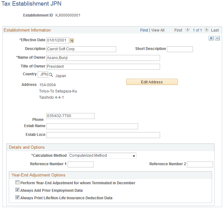

Tax Establishment JPN Page
Use the Tax Establishment JPN page (GPJP_TAX_ESTAB) to define tax establishments.
Record the establishment numbers assigned to your organization by income tax agencies. Provide address and additional information related to each establishment.
Navigation:
Set Up HCM, and then Product Related, and then Global Payroll & Absence Mgmt, and then Taxes, and then Tax Establishment JPN, and then Tax Establishment JPN
This example illustrates the fields and controls on the Tax Establishment JPN page. You can find definitions for the fields and controls later on this page.
Details and Options
Field or Control Description
Calculation Method
Select whether this salary payer (income tax establishment) calculates income tax by the computer calculation or tax table lookup method when an employee's income tax type is KOU. Valid values are Computer and Table.
Reference Number 1 and Reference Number 2
Enter up to two reference numbers to associate with the tax establishment. These numbers can be used during e-file reporting.
Year-End Adjustment Options
Perform Year-End Adjustment for whom Terminated in December
The default setting for this check box is deselected. Select this check box if your organization's policy is to perform the Year-End Adjustment for the payees who were terminated before the payment date in December.
Always Add Prior Employment Data
The default setting for this check box is selected. If you deselect this check box, the system does not include the sum of salary, withheld tax, the deducted Social Insurance premiums by the previous employer with the sum of those amounts from the current employer, if the payee, who terminates in mid-year, was judged not-subject to Year-End Adjustment.
Always Print Life/Non-Life Insurance Deduction Data
The default setting for this check box is selected. If you deselect this check box, the system does not print Life/Non-Life insurance deduction data on the Withholding Tax Report, if the payee, who terminates in mid-year, was judged not-subject to Year-End Adjustment.
