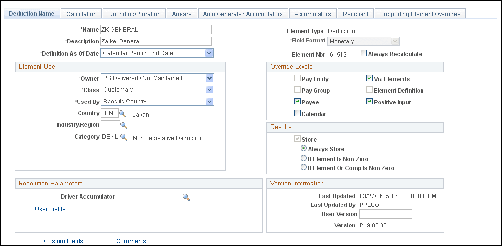

Deduction Name Page
Use the Deduction Name page (GP_PIN) to define a Zaikei deduction for each financial product offered to employees, and select Payee in the Override Levels group box.
Navigation:
Set Up HCM, and then Product Related, and then Global Payroll & Absence Mgmt, and then Elements, and then Payroll Elements, and then Deductions, and then Deduction Name
This example illustrates the fields and controls on the Deduction Name page. You can find definitions for the fields and controls later on this page.
Deduction Name page
Important settings for the Zaikei deduction on the Deduction Name page appear in the Override Levels group box. These override levels that are selected are:
  • Payee
  • Via Elements
  • Positive Input
The results are always stored.
See PeopleSoft Global Payroll. Defining Earning and Deduction Elements.
