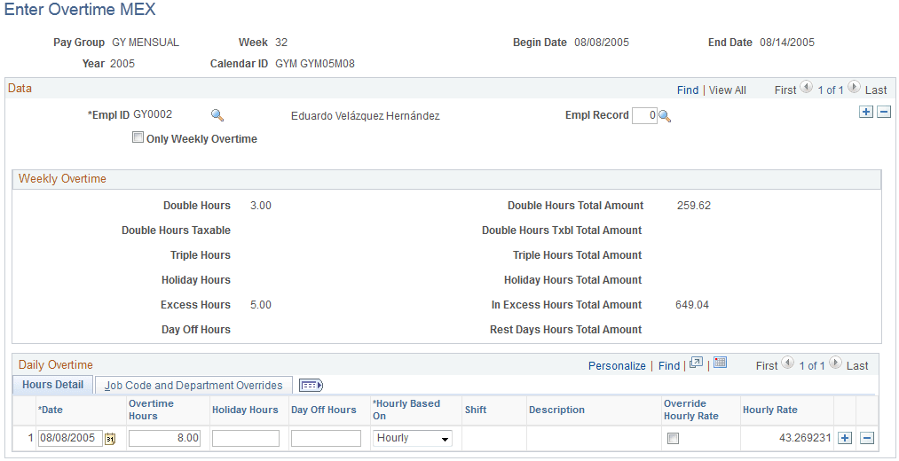

This example illustrates the fields and controls on the Enter Overtime MEX page: Hours Detail tab (daily overtime). You can find definitions for the fields and controls later on this page.

Data
Field or Control Description
Empl ID (employee ID)
Enter the employee ID of the employee for whom the overtime is being recorded.
Empl Rcd# (employee record number)
Enter the employee record number of the employee for whom the overtime is being recorded.
Only Weekly Overtime
Select to enter weekly overtime only on this page. Deselect to enter daily overtime and have the system automatically calculate the weekly overtime values. Depending on your selection, the system displays on the page only the fields that are specific for entering daily or weekly overtime.
Weekly Overtime
Double Hours, Double Hours Txbl (double hours taxable),Triple Hours, Holiday Hours, Exc Hours (excess hours), andDay Off Hours
Based on the information that you enter in the Daily Overtime grid, the system automatically calculates the rates for these hours and displays the result to the right of the corresponding field.
Daily Overtime – Hours Detail
Date
Enter the date when the overtime occurred.
Overtime Hours
Enter the number of overtime hours the employee worked.
Holiday Hours
Enter the number of overtime hours the employee worked on a holiday.
Day Off Hours
Enter the number of overtime hours the employee worked on a scheduled day off.
Override Hourly Rate
Select for a specific overtime entry to override the hourly rate value for that overtime entry. The Hourly Rate field becomes available for edit.
Hourly Rate
The system displays the employee's hourly rate. If you selected to override the hourly rate for the overtime entry, enter the new hourly rate.
Note: The system splits the double and triple overtime hours, based on the values you defined on the Overtime Parameters page.

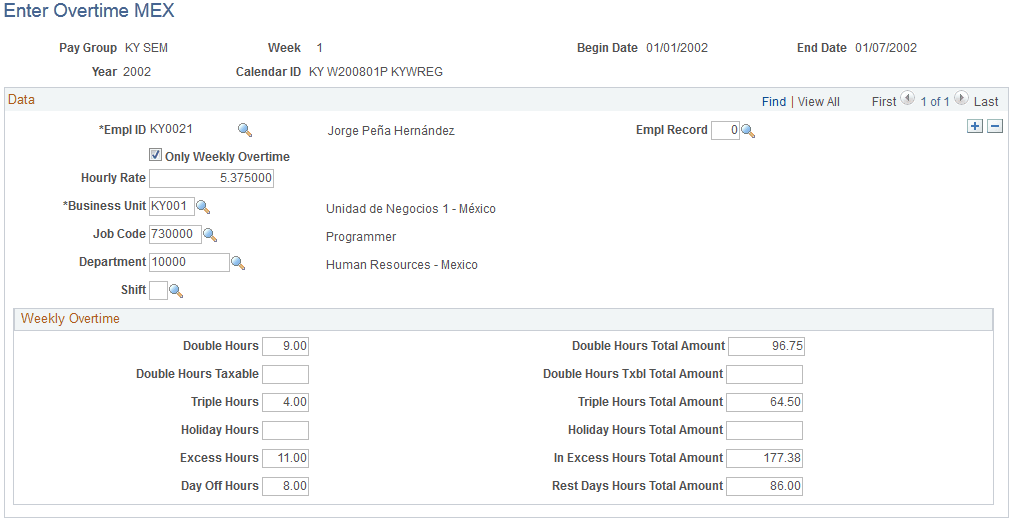

Example 17-1 Example of Enter Overtime MEX Page with Only Weekly Overtime Selected
This example illustrates the fields and controls on the Enter Overtime MEX page when the Only Weekly Overtime check box is selected. You can find definitions for the fields and controls later on this page.
Enter Overtime MEX page (weekly overtime)
Data
Hourly Rate
Enter the hourly rate for the weekly overtime. You'll use an hourly rate to calculate overtime.
Business Unit
Enter the employee's business unit.
Job Code
Enter the employee's job code.
Department
Enter the employee's department.
Weekly Overtime
Double Hours
Enter the total of overtime hours per week that are calculated at a double rate. Once you've entered the Double Hours Total, the system automatically calculates the overtime amount by multiplying the number of hours times the hourly rate for an employee times 2. The result displays to the right of the corresponding field.
Triple Hours
Enter the total of overtime hours per week that are calculated at a triple rate. Once you've entered the Triple Hours Total, the system automatically calculates the overtime amount by multiplying the number of hours times the hourly rate for an employee times 3. The result displays to the right of the field.
In Excess Hours
Enter the total in excess hours worked per week. Excess hours are those that are above the first 3 hours a day and on the first three days with overtime in a week, and are beyond the first 9 hours in a week. You can decide if these excess hours will be paid a double or triple rate on the Overtime Parameters page. The system automatically calculates the total overtime amount by multiplying the number of hours times the hourly rate for an employee and displays the result to the right of the field.
Double Hours Taxable
Enter the total of overtime hours per week that are calculated at a double rate and taxable. Once you've entered the Double Hours Taxable Total, the system automatically calculates the overtime amount by multiplying the number of hours times the hourly rate for an employee times 2. The result displays to the right of the corresponding field.
Holiday Hours
Enter the total amount of holiday hours worked per week. When you enter a holiday, the system checks the parameters defined in the Holiday Schedule to see if the date corresponds to a holiday. The system automatically calculates the overtime amount by multiplying the number of hours times the hourly rate for an employee times 2. The result displays to the right of the field.
Note: Holiday Schedule parameters are defined on the Pay Group Name page.
See PeopleSoft Global Payroll: Defining Pay Groups.
Day Off Hours
Enter the total amount of hours worked on a scheduled day off per week. The system checks if the entered Day Off effectively corresponds to the parameters of the Day Off that were previously defined in the work schedule for each employee. The system automatically calculates the overtime amount by multiplying the number of hours times the hourly rate for an employee times 2. The result displays to the right of the field.
