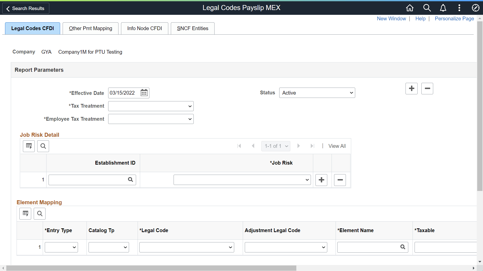

Legal Codes CFDI Page
Use the Legal Codes CFDI page (GPMX_LEGAL_CODE) to define the CFDI report parameters and to map elements.
Navigation:
Set Up HCM, Product Related, Global Payroll & Absence Mgmt, Reports, Legal Codes Payslip MEX, Legal Codes CFDI page
This example illustrates the fields and controls on the Legal Codes CFDI page.
Legal Codes Payslip Mex page
Field or Control Description
Job Risk Detail
Establishment ID
The Establishment Id where the employee's job risk is determined by the establishment that is associated with the employee's location.
Job Risk
Element Mapping
Entry Type
Select the type of element to include in the report. Values are:
