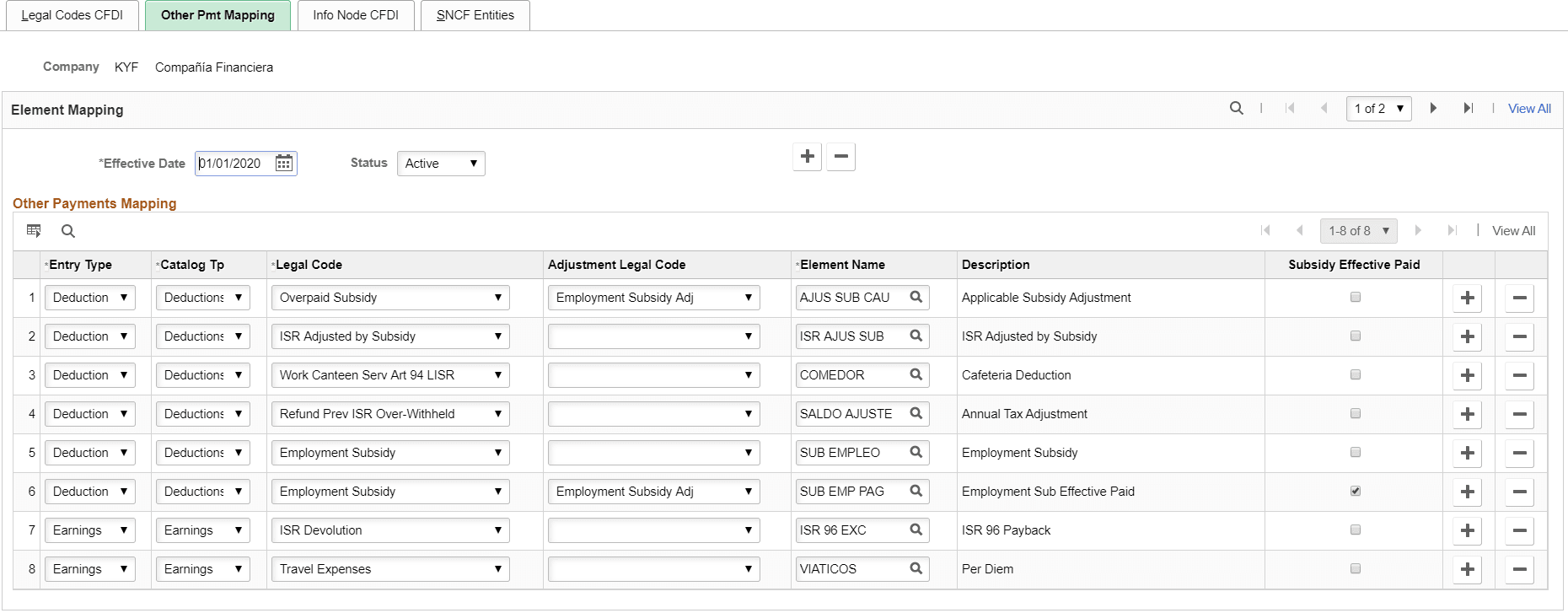

Other Pmt Mapping Page
Use the Other Pmt Mapping page to map the payment elements.
Navigation:
Set Up HCM, Product Related, Global Payroll & Absence Mgmt, Reports, Legal Codes Payslip MEX, Other Pmt Mapping page
This example illustrates the Other Pmt Mapping page.
Other Payments Mapping page
Field or Control Description
Entry Type
Select the element type. Valid values are:
  • Earnings
  • Deductions
Catalog Tp
Select the catalog type to which the Legal Code belongs to.
Legal Code
Select the legal code defined by SAT.
Adjustment Legal Code
The Adjustment codes defined by SAT to be used to report Adjustments.
Adjustments are triggered when a negative value is found in payroll results, its value changes to positive and is stored in an element including original element’s name.
Element Name
Name of the element. The value will be reported with the selected Legal Code.
Subsidy Effective Paid
Select this field to indicate that the element corresponds at subsidy effective paid.
