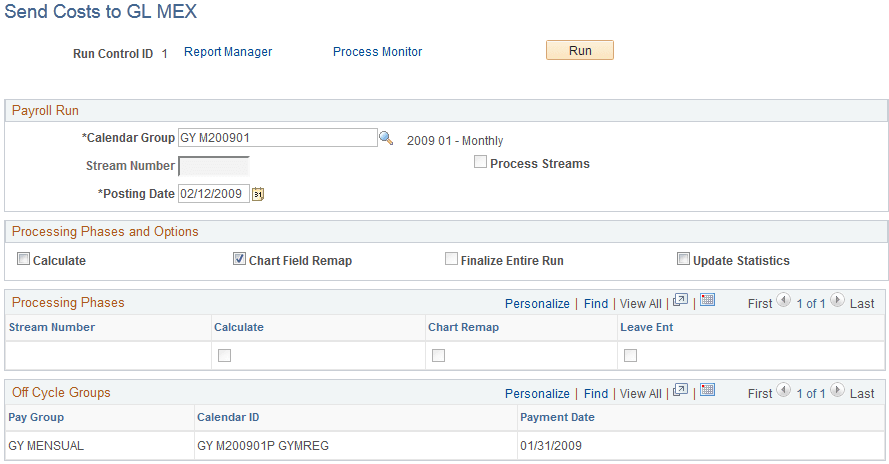

Send Costs to GL MEX Page
Use the Send Costs to GL MEX page (GPMX_GL_PREPARE) to initiate the processes for calculation of GL data, remapping of GL ChartFields, finalization of the GLI, and statistical data updating.
Navigation:
Global Payroll & Absence Mgmt, and then Time and Labor / GL Costs, and then Send Costs to GL MEX
This example illustrates the fields and controls on the Send Costs to GL MEX page. You can find definitions for the fields and controls later on this page.
Payroll Run
Field or Control Description
Calendar Group
Select a calendar group to run the process. Only calendar groups for which payroll is finalized but not yet sent to General Ledger are available.
Stream Number andProcess Streams
Process Streams is selected if stream processing was used during the payroll process and must be used with the Calculate option. Select the stream number to process.
Posting Date
Enter the date on which the entries are posted to General Ledger. Even if you run your process on the fifteenth of the month, you can indicate that you want the entries posted on the thirtieth of the month.
Note: The posting date that you select must abide by the closing date of Journal Generator. Posting dates must be coordinated with General Ledger. If Time and Labor is installed and costing has been sent, the posting date defaults to the day the costing was sent. You can change this day in this field to reflect the day that the general ledger is actually sent to General Ledger.
Processing Phases and Options
Select a processing option. You can run Calculate and Finalize together if the Payroll process is finalized.
Calculate
Select to generate General Ledger transactions for the earnings, deduction, and accumulators that were calculated by the Payroll process for this calendar group and that belong to a General Ledger group. The Payroll process must have identified at least one payee before you can run the Calculate process.
If you're using stream processing, run the Calculate phase for one stream at a time.
You can run the Calculate phase more than once for each stream. During subsequent iterations, the system deletes existing data before creating new results. It stores final results in the Global Payroll Transaction Interface record (GP_GL_DATA) and inserts an entry in the Completed GL Stream table (GP_GL_PREP_STRM) to indicate that calculation is complete.
Chart Field Remap
Select to enable the ChartField Remap Application Engine process (GPMX_GL_RC) when running the General Ledger process. This run control page enables you to run an Application Engine process that updates ChartFields in GP_GL_DATA. The program selects and updates the necessary GP_GL_DATA records with specified ChartField overrides. When you run the GL Interface Finalize process, the data is summarized by using your selected (remapped) ChartFields for correct account mapping.
Finalize Entire Run
This check box is available for selection after the Payroll process has been finalized and you have run the Calculate phase for the entire calendar group. (If you are using stream processing, all streams must be calculated.)
Select this check box when you are ready to finalize the run. (Stream processing is not available for the Finalize phase.)
Note: The Finalize check box is hidden if PPS is installed.
Update Statistics
This check box is for the database administrator to help with fine-tuning system performance. If selected, the system generates statistics during batch processing that provide information about how worktables are being used.
Processing Phases
This group box displays all streams associated with the calendar group that have been processed and the status of the processing phases for each stream.
Stream Number
Displays the streams that are associated with the calendar group.
Calculate
If selected, then you have already run the GLI process (GLI_GPMX_GL) to calculate the stream.
Chart Remap
If selected, then you have already run the GLI process (GLI_GPMX_GL) to remap ChartFields in the stream.
Calendar List
The system displays information about each calendar in the calendar group.
Off Cycle Groups
The system displays off-cycle groups that were processed within the calendar group.
