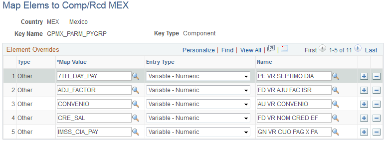

Map Elems to Comp/Rcd MEX Page
Use the Map Elems to Comp/Rcd MEX page (GPMX_ELEM_MAP) to set up the mapping to the fields and variables of an element which are used during development in the components interface objects.
Navigation:
Set Up HCM, and then Product Related, and then Global Payroll & Absence Mgmt, and then Elements, and then Map Elems to Comp/Rcd MEX
This example illustrates the fields and controls on the Map Elems to Comp/Rcd MEX page . You can find definitions for the fields and controls later on this page.
Field or Control Description
Key Type
The key type that your mapping applies to appears here. Values are Other and Field.
Note: The Key Type field is populated depending on the key type you selected (either Record or Component) and can't be modified.
Map Value
Select the field or value to which you want to map. If you selected Record as the key type, you can select the record fields. If you selected Component as the key type, then you can select the variables defined for the component.
Entry Type
Select the element type on which you want to transform your field or variable. Values are Accumulator, Bracket- Numeric, Count, Deduction, Earnings, Formula − Numeric, Rate Code, Rate Code − Amount, Variable − Numeric, Variable − Pointer, and Variable − Dec+Char+Date+Ptr. Values depend on the Map Value type. For example, if you select a Character map value, then you can select only character values.
Note: Although you can see System Element − Numeric as a value, you will not be able to select it. The entry type cannot be a system element or a constant.
Name
Select the name of the element.
