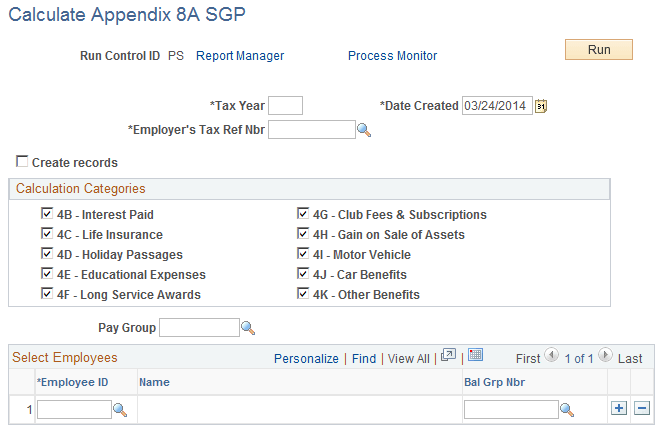

Calculate Appendix 8A SGP Page
Use the Calculate Appendix 8A SGP page (GPSG_RC_APP_8A) to enter the run control data for the Appendix 8A calculation process, which captures and stores values on the Appendix 8A Forms component (representing 4a to 4k on the tax form).
Navigation:
Global Payroll & Absence Mgmt, and then Year-End Processing, and then Calculate Appendix 8A SGP, and then Calculate Appendix 8A SGP
This example illustrates the fields and controls on the Calculate Appendix 8A SGP page.
Field or Control Description
Create records
Select for the system to create new Appendix 8A forms for employees that have values for some benefits, but don't have an existing Appendix 8A. (Otherwise the Appendix 8A must be created manually first.) You can therefore create new Appendix 8A forms, without manually creating the data first.
Calculation categories
The category and category name of the tax form categories that you assign to the tax form appear. For IRAS reporting, all accumulators are categorized. You define and allocate the categories to the tax form on the IRAS Tax Forms SGP page. Each category comprises a set of accumulators that you use to calculate the values on the IR8A or Appendix 8A forms. Select the Calculate check box next to its corresponding category to enable recalculation. Every time that you run the process, the system checks the accumulator balances and updates them in the Appendix 8A forms.
