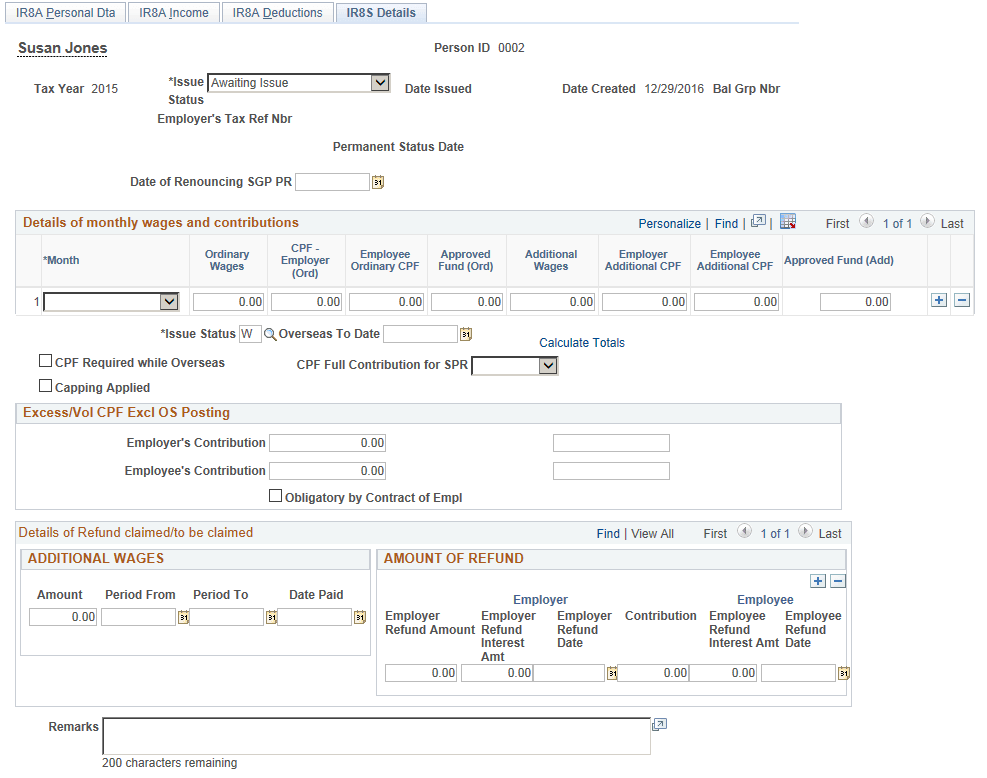

IR8S Details Page
GPSG_IR8S_AMD_DTLS
Use to update the amendment data to be reported under IR8S.

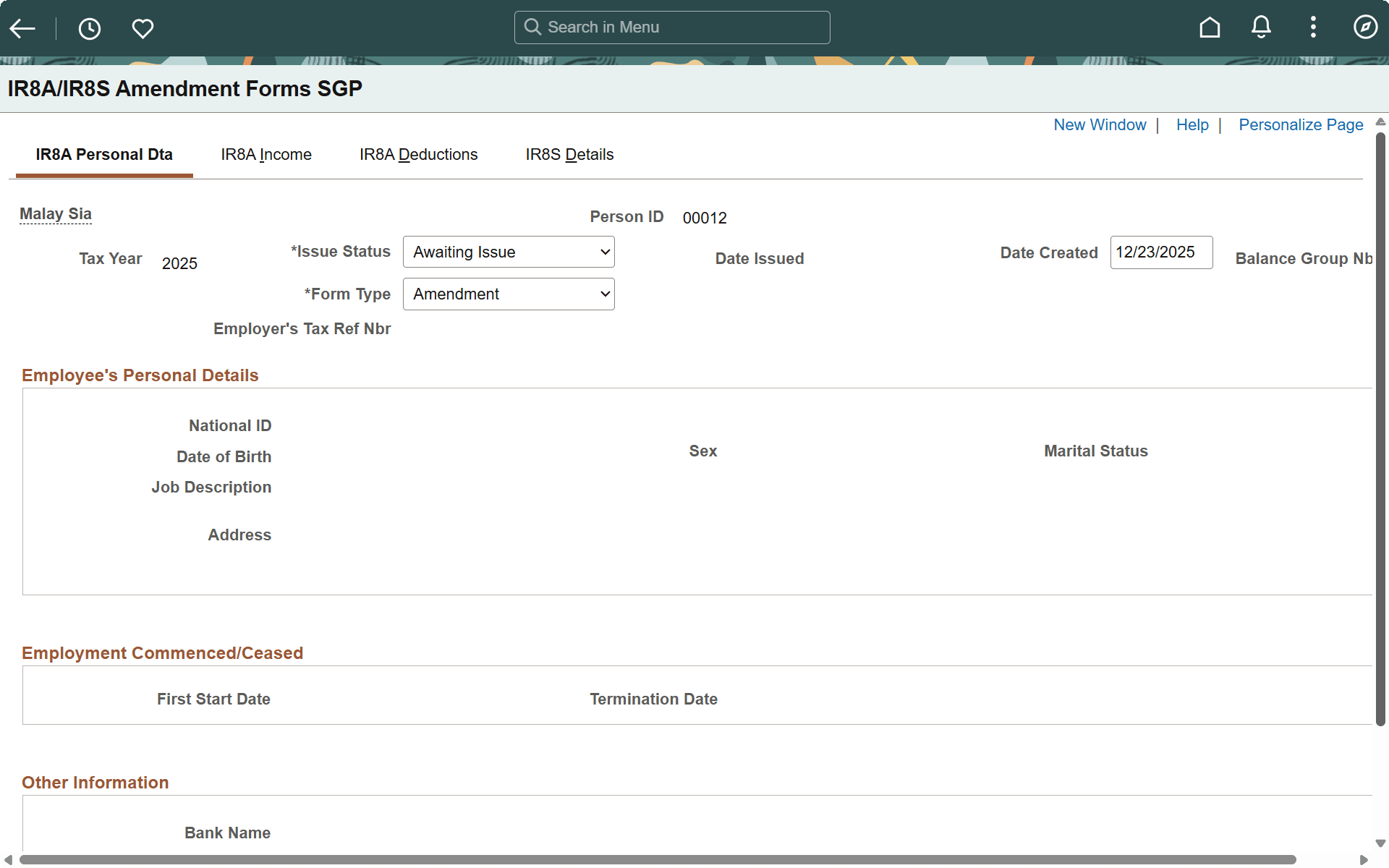

IR8A Personal Data Page
Use the IR8A Personal Data (GPSG_IR8A_AMD_DTLS) page to be view the personal details of the employee for whom the amendment record is created.
Navigation:
Global Payroll & Absence Mgmt, and then Year-End-Processing, and then IR8A/IR8S Amendment forms SGP, and then IR8A Personal Data
This example illustrates the fields and controls on the IR8A Personal Data page.
IR8A Personal Data
Field or Control Description
Issue Status
The status of the amendment data will be ‘Awaiting Issue’ until the generation of amendment file.
After the amendment form is generated, the issue status will be changed to ‘Issued’ by the system. If you need to correct the history, change the record issue status manually (back to “Awaiting”) and regenerate the amendment file.
Date Created
Displays the date on which the amendment data is created.
If you create amendment data again for the same employee on another date, system will sum up the values of all the records with “Awaiting Issue” status for generating amendment file
Form Type
Select from the following:
  • Amendment
  • IR8A/IR8S
  • Revision
Note: If you are creating an amendment record, select the form type as ‘Amendment’.

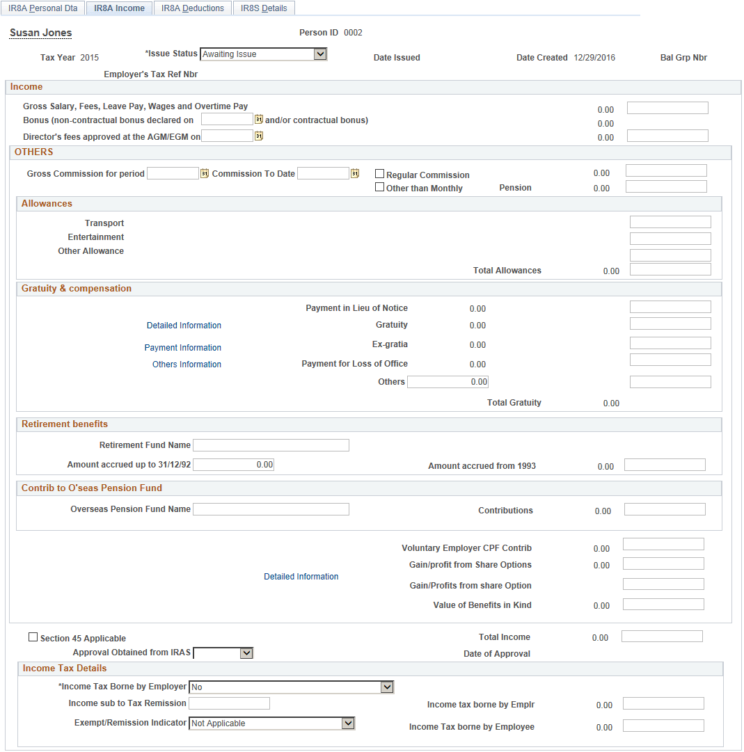

IR8A Income Page
Use the IR8A Income (GPSG_IR8A_AMD_INCM) Page to update the amendment data for earnings to be reported under IR8A.
Navigation:
Global Payroll & Absence Mgmt, and then Year-End-Processing, and then IR8A/IR8S Amendment forms SGP, and then IR8A Income
This example illustrates the fields and controls on the IR8A Income page.
IR8A Income Page
Income
Gross Salary, Fees, LeavePay, Wages and Overtime Pay
Enter the updates on Gross Salary, Fees, LeavePay, Wages and Overtime Pay
Bonus (non contractual/contractual bonus declared on
Enter a date within the same year as the original date for updating bonus related amendment.
Director’s fees approved at the AGM/EGM on
The date on which the payment of director's fees is approved. Enter a date within the same year as the original date.
Others
Regular Commission
If this checkbox is left blank in the original submission, this information can be overwritten in the amendment submission.
But, if the indicator was selected previously, this cannot be amended in the submitted record. The details should be emailed to IRAS.
Other than Monthly
Allowances
Use Allowances section to enter the changes on transport, entertainment and other allowances.
Gratuity and Compensation
Use Gratuity and Compensation section to enter gratuity related changes.
Detailed Information
Use this link to view more information on gratuity compensation.
Payment Information
Use this link to view the reason and basis of payment for loss at office.
Other Information
Use this link to view additional details on reason of payment.
Note: Text fields cannot be amended using the amendment file submissions.
Retirement Benefits
Use this section to enter the changes on retirement benefits.
Contribution to Overseas Pension Fund
Use this section to enter the changes on overseas pension fund contributions.
Section 45 Applicable
Select this check box if section 45 is applicable for the employee.
Note: If this checkbox is left blank in the original submission, this information can be overwritten in the amendment submission. But, if it was selected previously, this cannot be amended in the submitted record. The details should be emailed to IRAS.
Approval Obtained from IRAS
Select from the following list:
  • Yes
  • No
Note: If the field was left blank in the original submission, this information can be overwritten in the amendment submission. But, if it was selected previously, this cannot be amended in the submitted record. The details should be emailed to IRAS.
Income Tax Details
Use this section to enter the changes on income tax details.
Income Tax Borne by the Employer
Select from the following options:
  • No
  • Partial
  • Yes
Note: If the field is left blank in the original submission, this information can be overwritten using the amendment submission. But, if it was selected previously, this cannot be amended in the submitted record. The details should be emailed to IRAS.
Exempt/Remission Indicator
  • Exemption
  • Income from OS Employment
  • Income-OS Employment&Pen.Fund
  • Not Applicable
  • OS Pen.Fund – Tax Concession
  • Seaman
  • Tax Remission on OCLA
  • Tax Remission on OHQ
By default, Not Applicable is selected.
Note: If this field is left blank in the original submission, this information can be overwritten using the amendment submission. But, if it was selected previously, this cannot be amended in the submitted record. The details should be emailed to IRAS
  • Yes
  • No
Note: If this field is left blank in the original submission, this information can be overwritten using the amendment submission. But, if it was selected previously, this cannot be amended in the submitted record. The details should be emailed to IRAS.

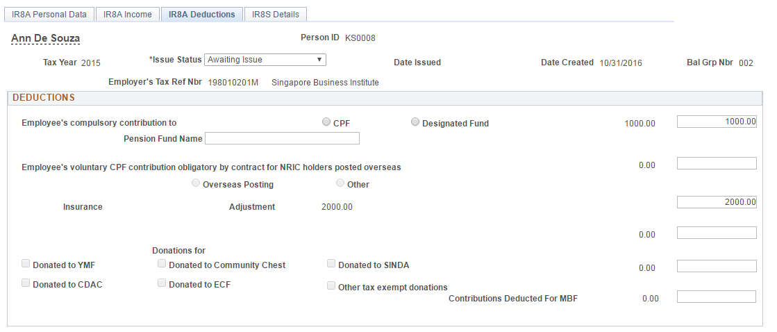

IR8A Deductions Page
Use the IR8A Deductions Page to update the amendment data for deduction and CPF related data to be reported under IR8A
Navigation:
Global Payroll & Absence Mgmt, and then Year-End-Processing, and then IR8A/IR8S Amendment forms SGP, and then IR8A Deductions
This example illustrates the fields and controls on the IR8A Deductions page.
Employee's compulsory contribution to and Fund Name
Select the CPF option if the employee has CPF contributions, and the Fund Name field displays C.P.F. When the employee has no CPF contribution, the Designated Fund option is available for selection.
Note: If a checkbox is left blank in the original submission, this information can be overwritten in the amendment submission. But, if it was selected previously, this cannot be amended in the submitted record. The details should be emailed to IRAS
Employee's voluntary CPF contribution obligatory by contract for NRIC holders posted overseas
This total includes year-to-date contributions of all voluntary CPF (employee voluntary contributions) that are obligatory by contract of employment in respect of NRIC holders who are posted overseas. It includes the values from the accumulators for the category IR8A employee voluntary CPF when the employee has a value of Y set for the variable IRS VR OVERSEAS on the Payee Supporting Elements record (GP_PAYEE_SOVR).
Donations For Donated to YMF, Donated to Community Chest, SINDA, CDAC, ECF, and Other tax exempt donations
The total donations that are deducted through salaries includes year-to-date deductions for all of the following deduction elements; MBMF, SINDA, SHARE (also known as Community Chest), CDAC and ECF. If the check box is selected for these deductions, this indicates that deductions were taken during the year. It includes the values from the accumulators for the categories IR8A MBMF, IR8A Community Chest donations, IR8A SINDA, IR8A CDAC, IR8A ECF and IR8A other tax exempt donation.
IR8S Details Page
Use the IR8S Details Page to maintain and update the amendment data for earnings, deduction and CPF related data to be reported under IR8S.
Navigation:
Global Payroll & Absence Mgmt, and then Year-End-Processing, and then IR8A/IR8S Amendment forms SGP, and then IR8S Details
This example illustrates the IR8S Details page
IR8S Details Page
Note: When you amend amount fields in IR8S that affect amount in IR8A (If the changes to the amount fields affect the amount for the field “Excess contribution to CPF made by employer” )an amendment record should be submitted for both the IR8A and the IR8S forms.
