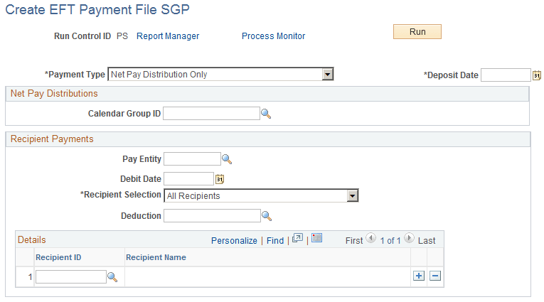

Create EFT Payment File SGP Page
Use the Create EFT Payment File SGP page (GPSG_EFT_GIRO_RC) to enter the parameters for the electronic file creation.
Navigation:
Global Payroll & Absence Mgmt, and then Payment Processing, and then Create EFT Payment File SGP, and then Create EFT Payment File SGP
This example illustrates the fields and controls on the Create EFT Payment File SGP page.
Field or Control Description
Payment Type
Select from Net Pay Distributions Only, Net Pay and Recipients or Recipient Deductions Only.
The EFT the system creates contains data only for payments of the type specified.
Deposit Date
This is the date of the actual transfer of funds and the date they are deposited with the bank. The date is written to the GIRO header. It is normally the same as the payment date on the pay calendar but you may need to change it if the payment date is not a business date. The date cannot be in the past.
Calendar Group ID
Enter the ID for the calendar group for which you want the system to extract payee net pay data. You can only select calendars for which the banking process is finalized. You do not need a Calendar Group ID for the Recipient Deductions Only payment type.
Recipient Payments
Pay Entity
When you set up deduction recipient data, you specify a pay entity as part of the payment details. It is where you specify commission details and your Group Number. You do not need a pay entity for net pay distributions only.
Debit Date
The system extracts recipient payments where the debit date is equal to the recipients deposit schedule. If the recipient does not have a deposit schedule the system extracts payments using the debit date without reference to a deposit schedule.
Recipient Selection and Deduction
The system includes payments according to these rules (and according to the debit date and its rules):
All Recipients: Payments for all deductions for all recipients according to the debit date rules.
Selected Deduction: Payments for all recipients for the (single) selection you make in theDeduction field.
Selected Recipients: Payments for all deductions for the recipients you select in theRecipient ID field.
